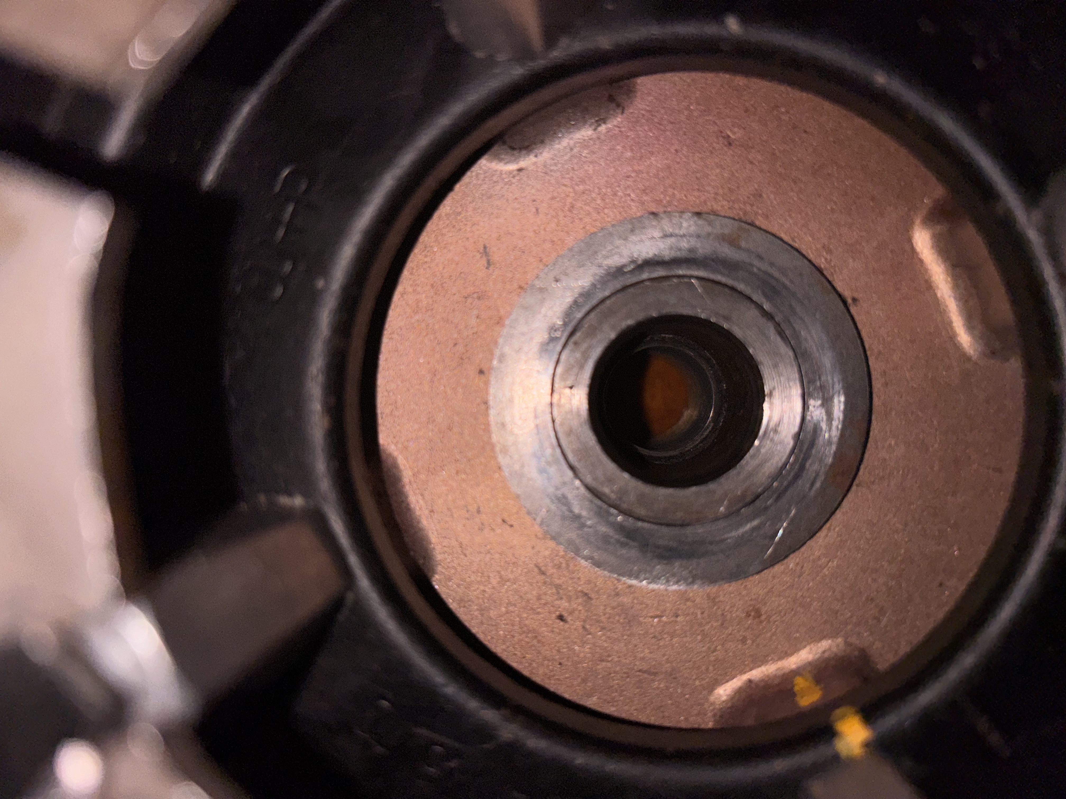

Ok two video links follow - Tom that was a great idea. Difficult to achieve but see what you think.
Second video are observations after the experiment and a pic

Video of observations -
Photo with washer in place:

I can't take credit for the clay idea -- folks have been using it to check clearances since before I was born -- more typically to check piston to valve clearances, etc., but still...
I was thinking your trigger wheel (inner diameter) might be preventing the p/s pulley from nesting all the way in, even if the spacer was the same thickness as the trigger wheel. But if the clay all squished out, that would mean the pulley is bottoming out on your washer and the trigger wheel isn't holding it back.

On a separate note, it occurred to me watching those videos that the p/s pulley on the crank is going to be a couple millimeters further forward than the pulley on your p/s pump -- by the thickness of your spacer washer. Hard to say how that will play out, but there's a real chance you'll chew up the p/s belt prematurely if the pulleys are not in the same plane. There are quite a few fully-sorted trigger wheel kits out there worth considering, including several developed by folks who frequent Carpokes -- and at least one by a world-class 944 engine builder who frequents this thread
