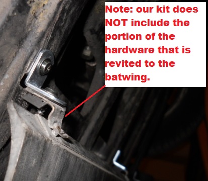

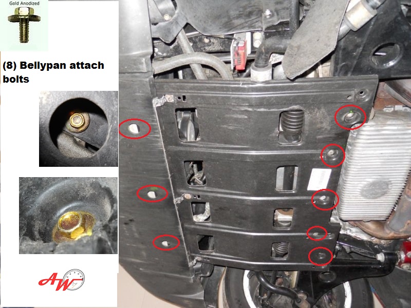

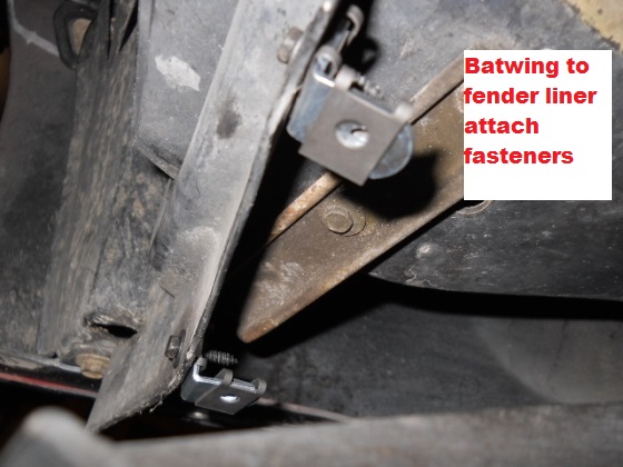

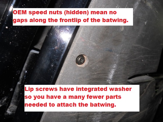

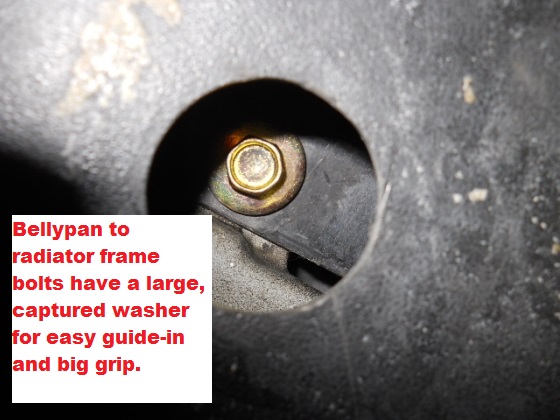

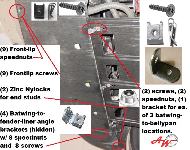

This is what I found, maybe we can replicate this kit!
Description
Fits all 944 Turbo & S2
This 63 piece kit includes all the fasteners and hardware to attach the batwing and plastic bellypan to your Porsche 944 Turbo or S2. Some of these parts are OEM but most are replacement parts that just work better! Unlike the original hardware, our screws and nylocks have integrated washers so you don't fumble the washer will laying upside down trying to hold the panel in place. Our angle brackets are zinc coated for corrosion protection and long life. You don't want to know what all this hardware costs from Porsche! Our kit is nicer and less expensive.
Description
