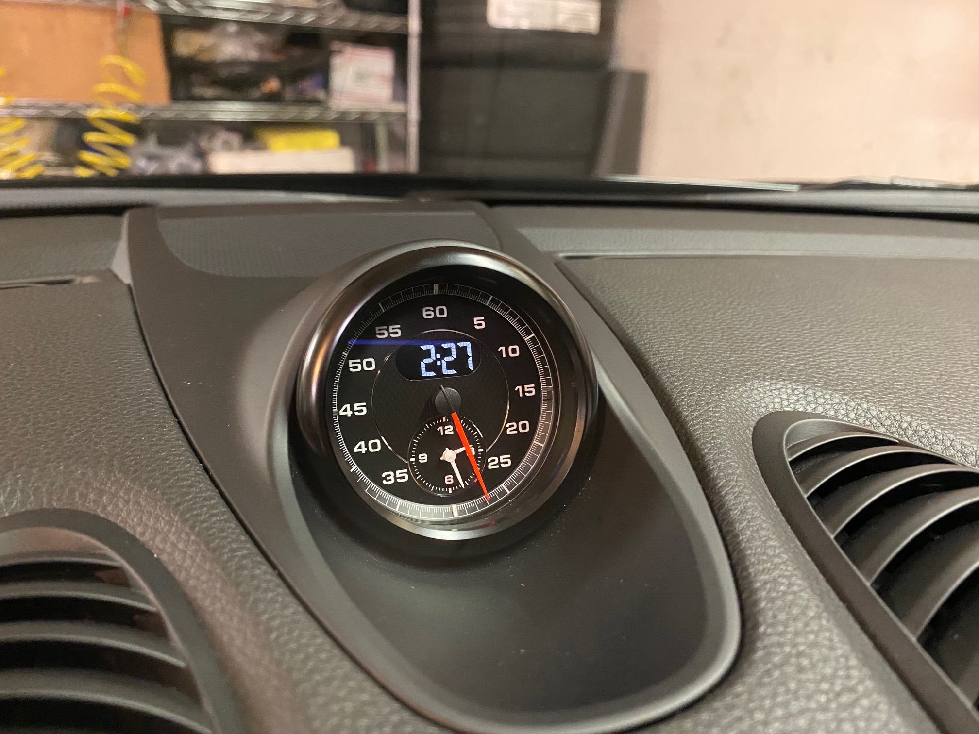

For the time being I did get one of the inexpensive eBay aluminum covers. Its not perfect, but its a big improvement for me over the stock.
The black is still glossy so there is some glare in bright sunshine in the daytime, but its way better than the chrome. If it bugs me, perhaps I'll try painting it matte black. At night I can just turn the clock off so the light goes out and there are no reflections.
It has a little adhesive and sticks to the clock just fine but pops off easily so I'm not risking any damage to the trim or stock bezel.

I was able to find the STL for the bezel in that video, linked below for download. It relies on being able to wedge the lip under the gauge, which is possible on some cars but not all, depending on how the gauge was situated when installed. If memory serves, that's why I didn't 'release' this version. Also note that I print these on Formlabs resin printer -- not a typical FDM (plastic melting) printer. Resin printers are able to create smooth surfaces like injection molded parts, and can be easily sanded to an even smoother surface. Most home (FDM) printers leave layer lines that make things look 3D printed. I don't think that kind of printer would do well with this at all...Robertsmania wrote: Tue Jul 01, 2025 7:26 pm I might be a little confused, but I got really excited when I found this video:

I also dug up the model I used to create replicas of the original bezel, for those willing to remove the bezel and replace it. I hesitate to post that online, since it is a good fit and I worry it would get misused. I'm also not sure of the fit if printed on anything but my Formlabs printer. The design was trial and error until it fit just right, with adjustments well within the error range of most printers. I could print those in grey right now (since that's what I'm currently using) for a nominal amount -- say $20 -- if there was interest. Or I could gear up and print them in black to avoid the need for paint, but that wouldn't be for another few weeks and I'd need to recoup the ~$300 cost of getting set up to print in black.
