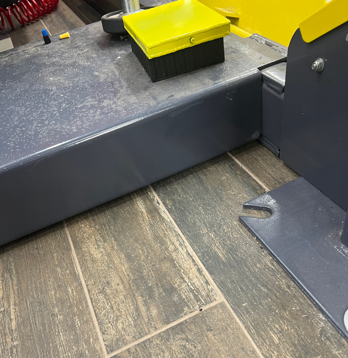

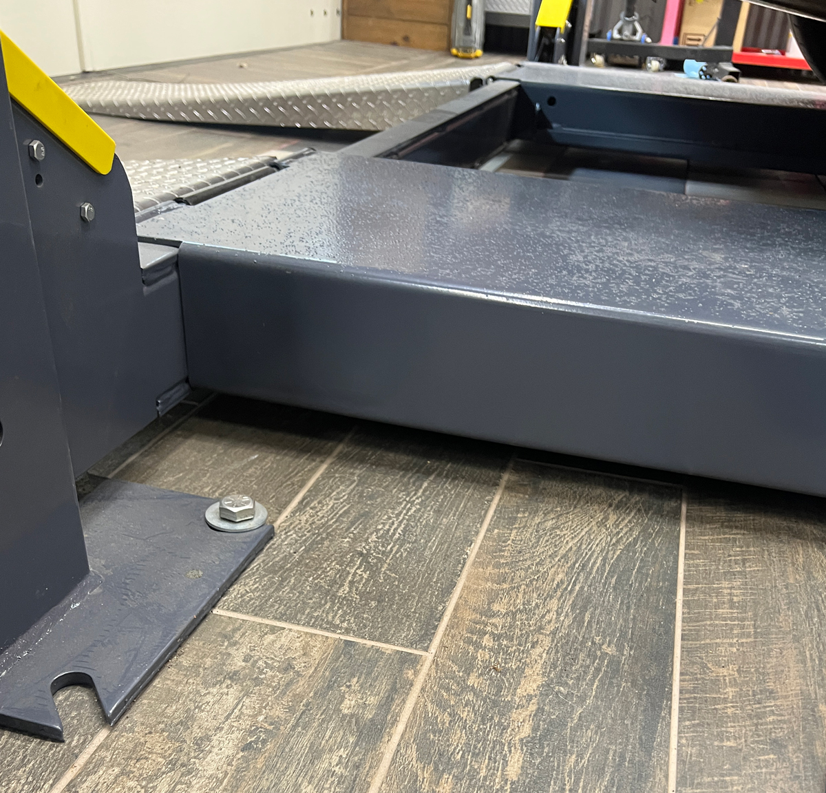

Bendpak's installation instructions say a 3% slope is the max. 3% is actually pretty darn steep. The code where I live says a garage floor needs to have 1/8 to 1/4" slope per foot, which is roughly a 1 to 2% grade. Mine is about 1.75%. To me it seems like if you need more than 1% grade, then something else is wrong... (e.g., no where for the water to go; water gets in too easy, etc.), but I'm no structural engineer so could be missing the point. In my case, the issue manifests itself by preventing the rear of the lift from sitting flat on the floor. The runners need to be level (to keep cars from rolling off), so the rear ends up sitting off the floor a bit when lowered. My authorized installer said that's normal and not a problem. They make shims to raise the rear posts, so the runners can be level without losing any height up top, but it's kind of splitting hairs in my opinion.Belgian951 wrote: Sat Feb 15, 2025 10:46 am Unfortunately the house lies in flood zone. The brook is a couple meters in front of the house, so we are worried about flooding. What's the max slope for a garage if you want to install a 2 post lift? Thanks for all the tips!
