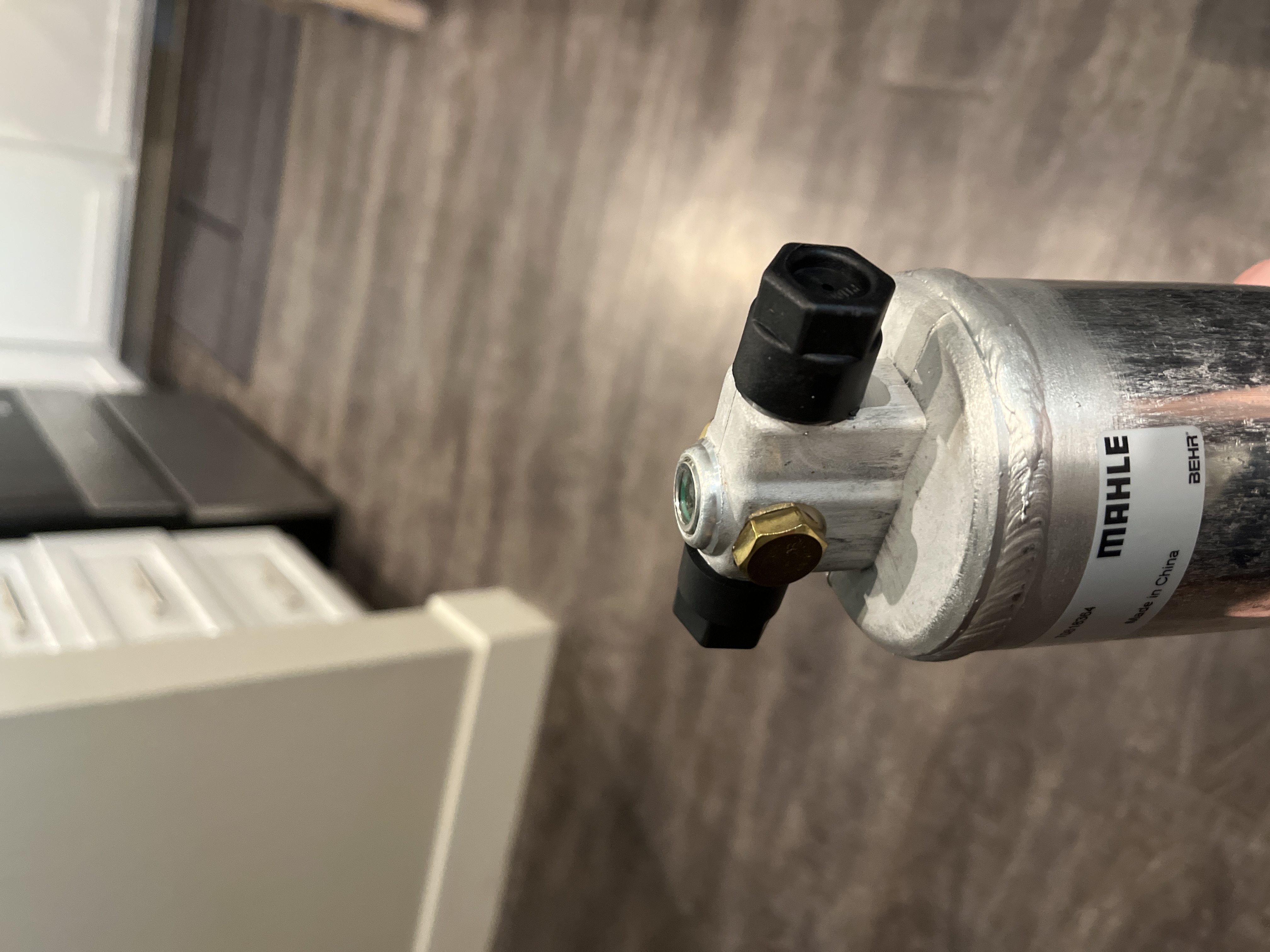

Also my new reciever dryer doesn’t have inlet or outlet ports marked so I don’t know which way to install it.

Where did you get that receiver drier? Did it come in a Porsche box or a Mahle box? Look for faint arrows. If it's like mine, the port further from the sight-glass is the IN side, but look for a faint arrow or faint markings.

It came in a Mahle box, and I don’t see any markings. Does the “in” side point to the front bumper or firewall?
