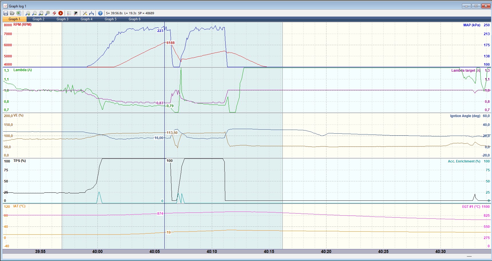

ealoken log.jpg (320.16 KiB) Viewed 2267 times
Here is my log from last night.
OE IC is the next choke point, see the IAT and EGT rising.
GTX3576 G2 turbo, full boost by 4000 and out.
