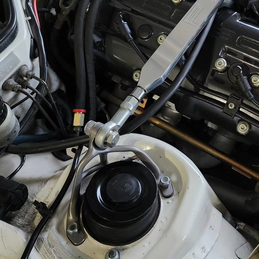

I was recently contacted by a 944 guy in a far off land for help with an intake manifold design. I shared some drawings of ITB type manifolds which I had done years ago, and come to find out they will use 3D printing to complete the manifold. Since this is outside of my wheelhouse, I'll let him explain. Anyone familiar with this?
For this application the FDM printed would simply be for the core of the casting, like traditional investment casting but with a plastic printed part so would still result in a cast aluminum component just significantly less time invested.
To shine some light on 3d printing for you regarding appropriate materials, just incase you are interested.
We do a large amount of 3d printing for our vehicle's at XXXX cars . Our top printer is our SLS (single layer sintering) titanium printer that alot of components from suspension through to gearbox housings are done on.
Even managed to squeeze in component for my 944 strut brace in printed titanium, see attached photo.
But there are plenty of similar printers set up with the likes of aluminum ,stainless and inconel.
SLS is a very usable case now for parts like the manifold all be it at a higher price than traditional manufacturing like casting.
Today I have some ITB housings in the mill that were printed in Titanium that are extremely light thanks to being able to print it almost as a hollow item with essentially a 0.6mm thick skin around the outside and inside.
