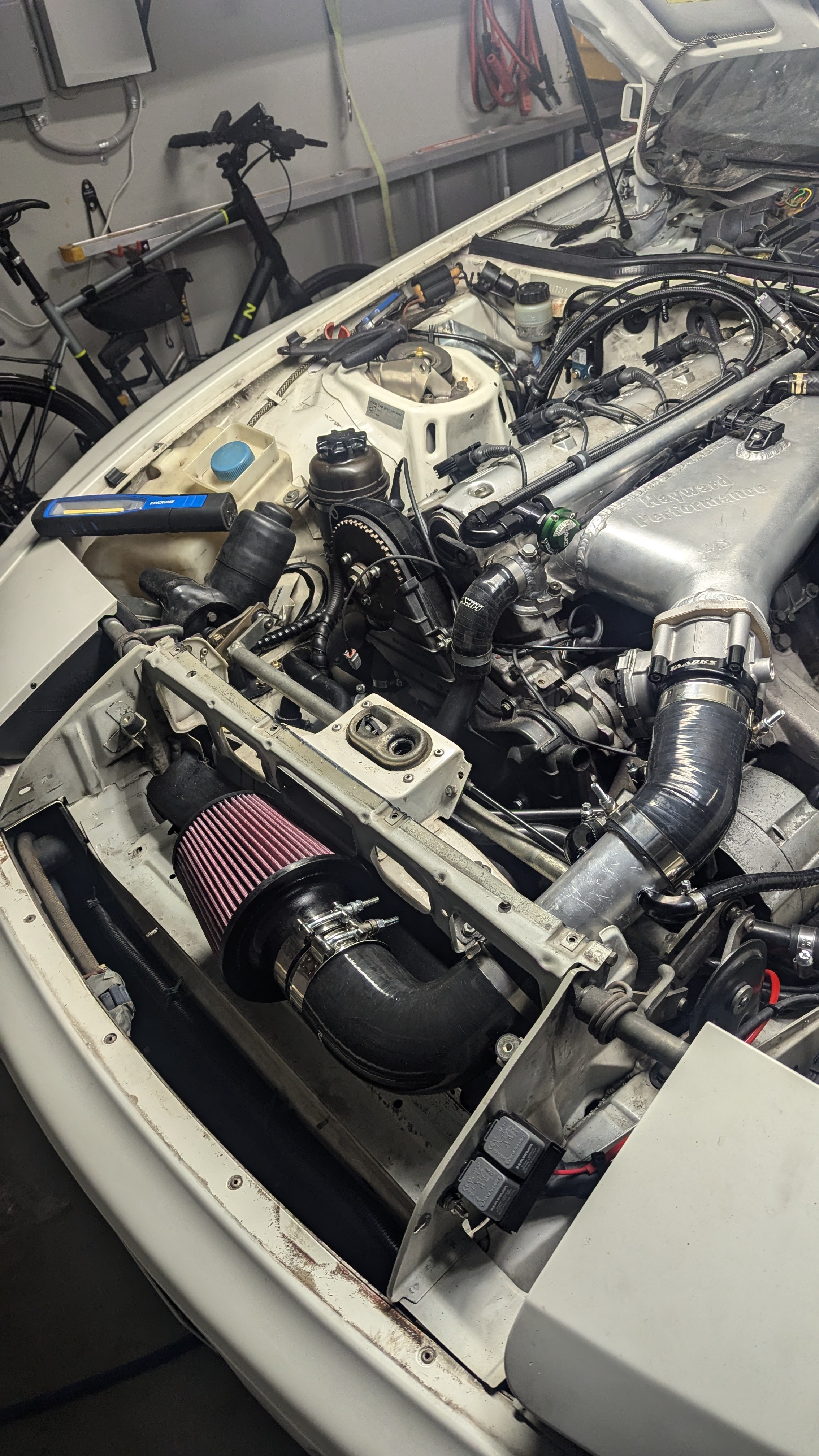

Ive finalised the plumbing in the engine bay to get the S2 engine running again. I had to clock the AOS outlet 60deg to clear the intake manifold.
Fuel lines are finished, I need to reinstate the pump, flush the lines and set the base pressure.
New motor is far as it can go until I can take parts off the S2 motor to complete it. I'm still tossing up what to do with the headers and cross over but the focus is on getting the car running and non-boost tuning done.

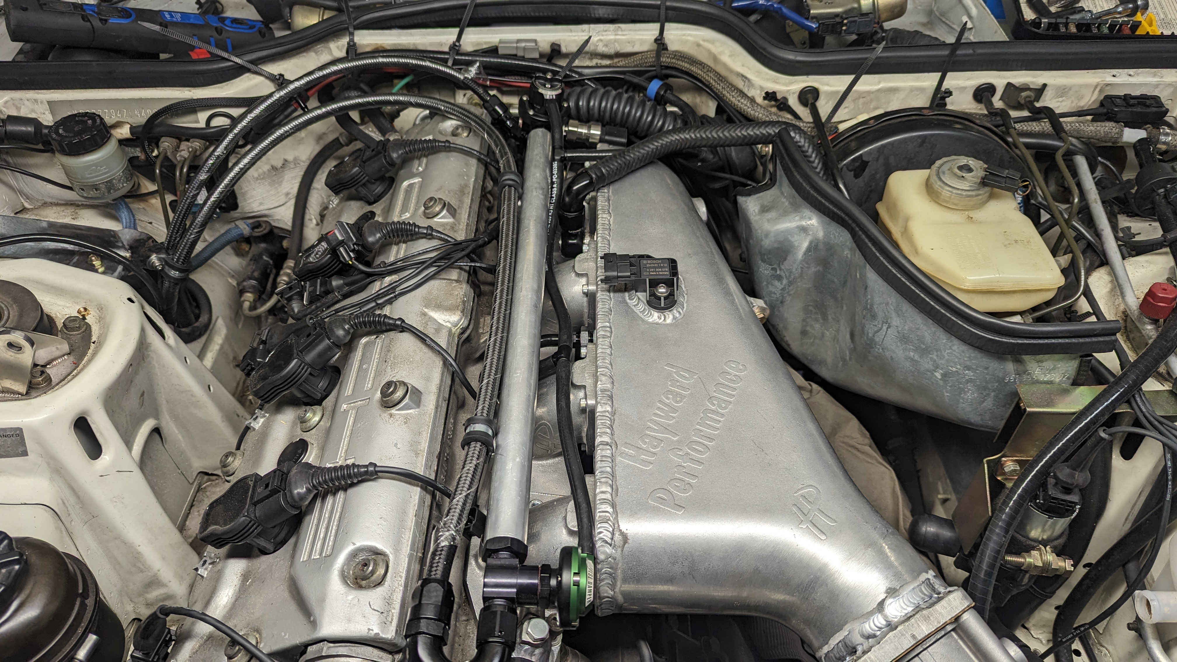

It's alive! I have so say I'm super impressed with the Link ECU, we transitioned from the Megasquirt to very good modelled d fuel NA base tune in a couple of hrs on the road. The change to sequential injection/ignition and E-throttle has made the car so much smoother and nicer to drive, though the new harness may have helped with that.
Unexpectedly he Hayward manifold seems to have improved the midrange, rather than shift the power band up. That's by the seat of my pants dyno though, it also sounds amazing.

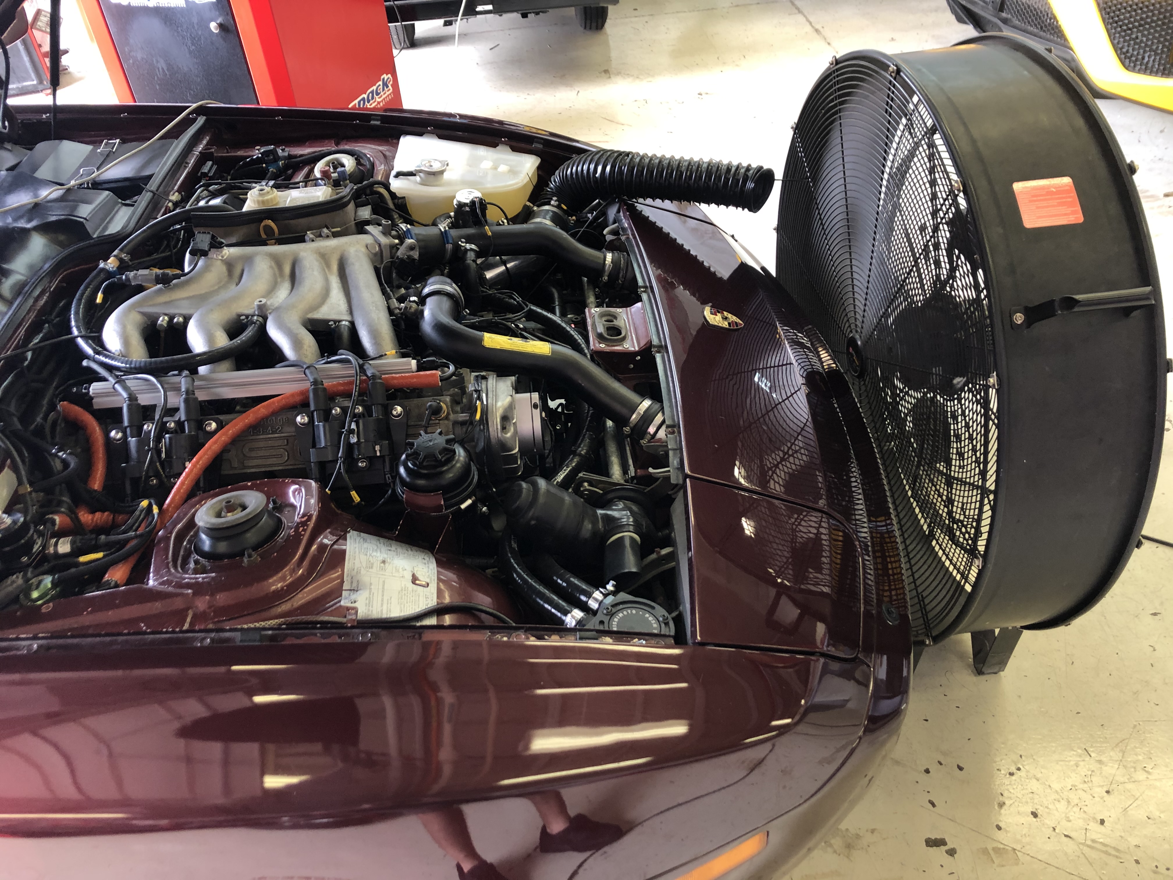

Charge temp is always optional in modelled... it's just set to 0 when not used. In which case only your IAT table is used.
Yes, definitely best calibrated on the dyno. I moved the duct to the fan in front of the dyno for cool air and onto the headers for hot air like you mentioned. Then used the hood open vs. closed to vary the coolant temp. Takes some patience but worked pretty well.

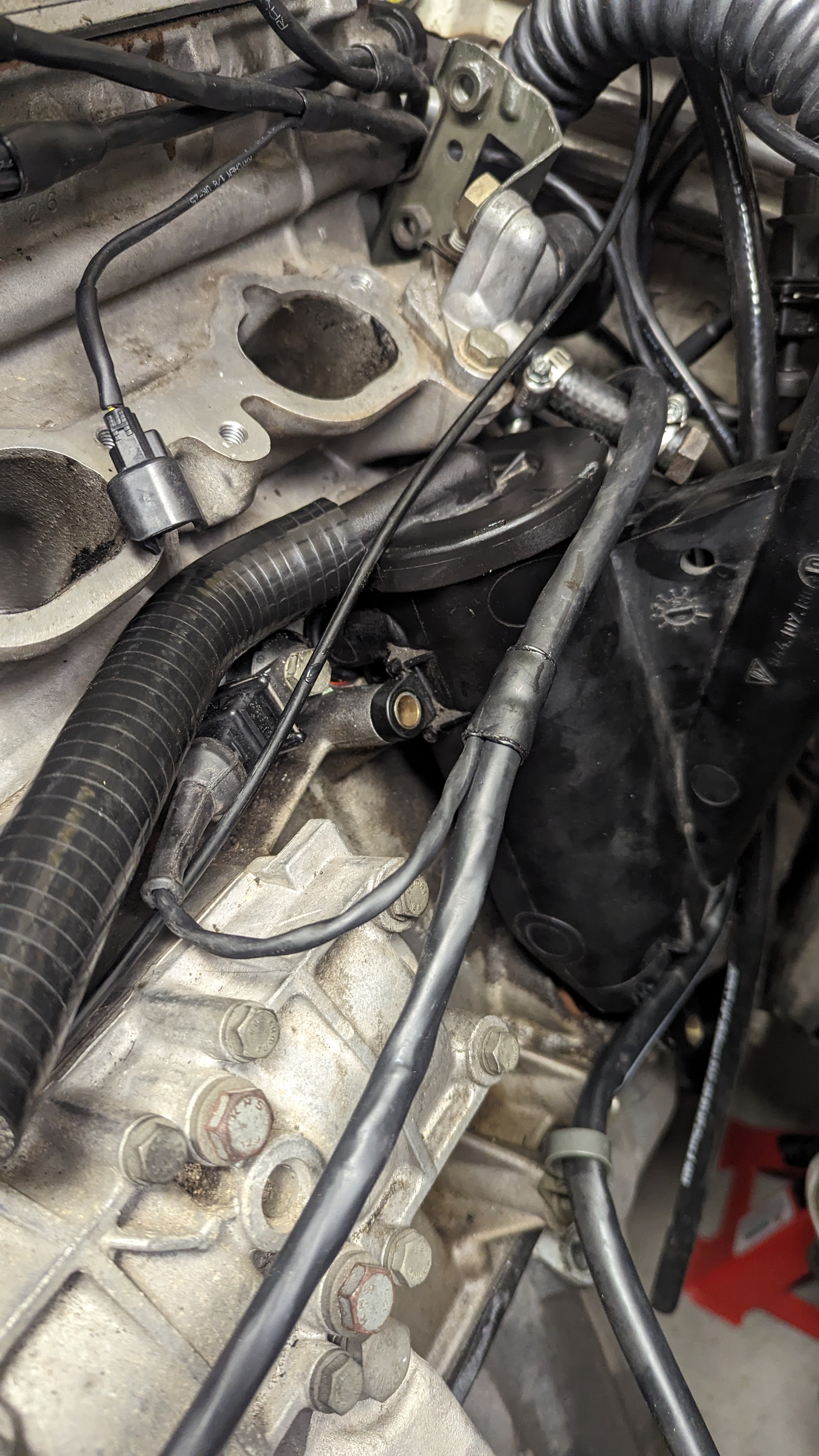

Bergerac wrote: Fri Jun 14, 2024 5:39 am Things have slowed down a bit, I'm back to working out in the desert so I'm away for 2 weeks at a time ATM PXL_20240601_061324081.jpg
Not sure if I'm missing something but that Hayward intake is on your 16v head. I thought they made these only for 8v heads. Please clarify.
#60
