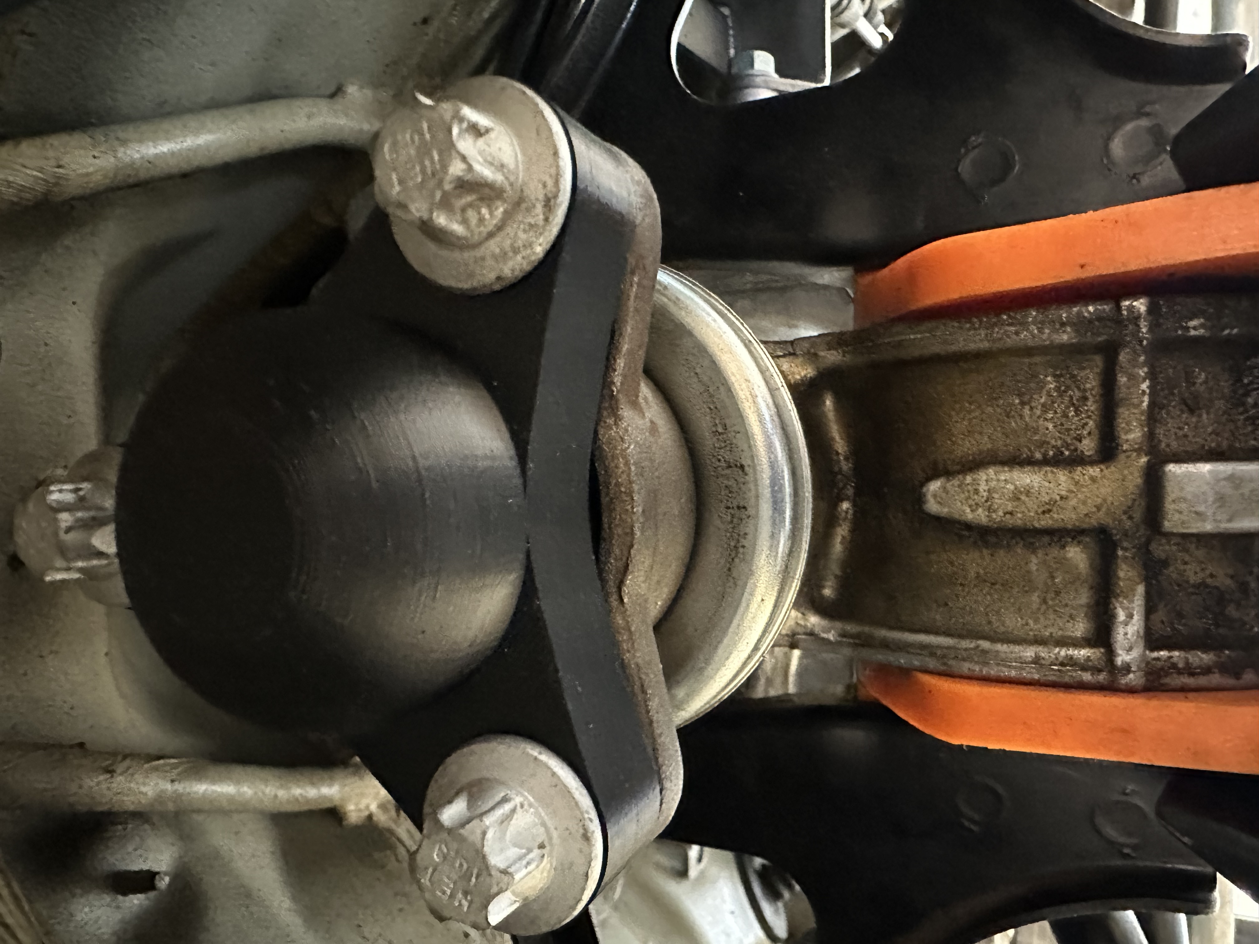

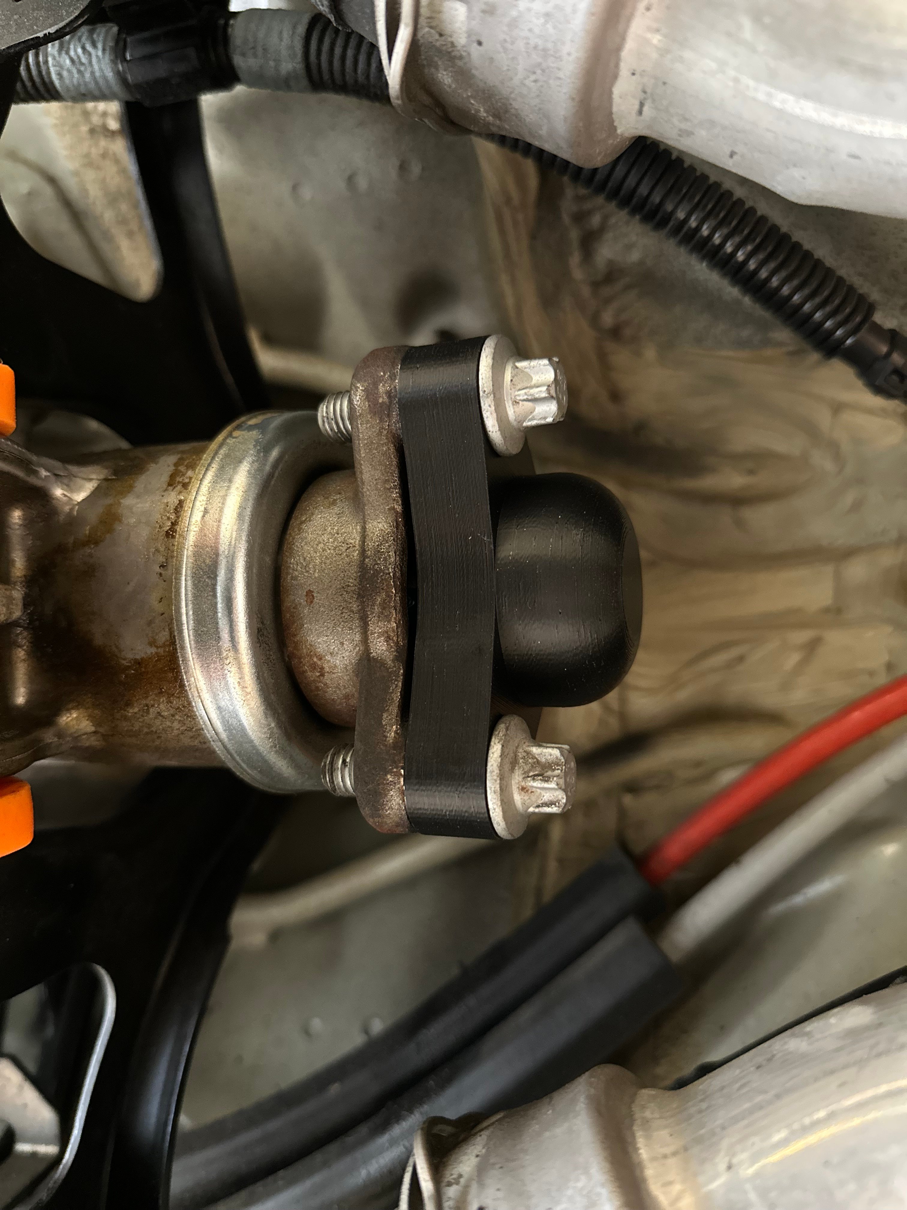

Update! Received the 3D printed driveshaft cap (not sure what to call this part) from Tom:

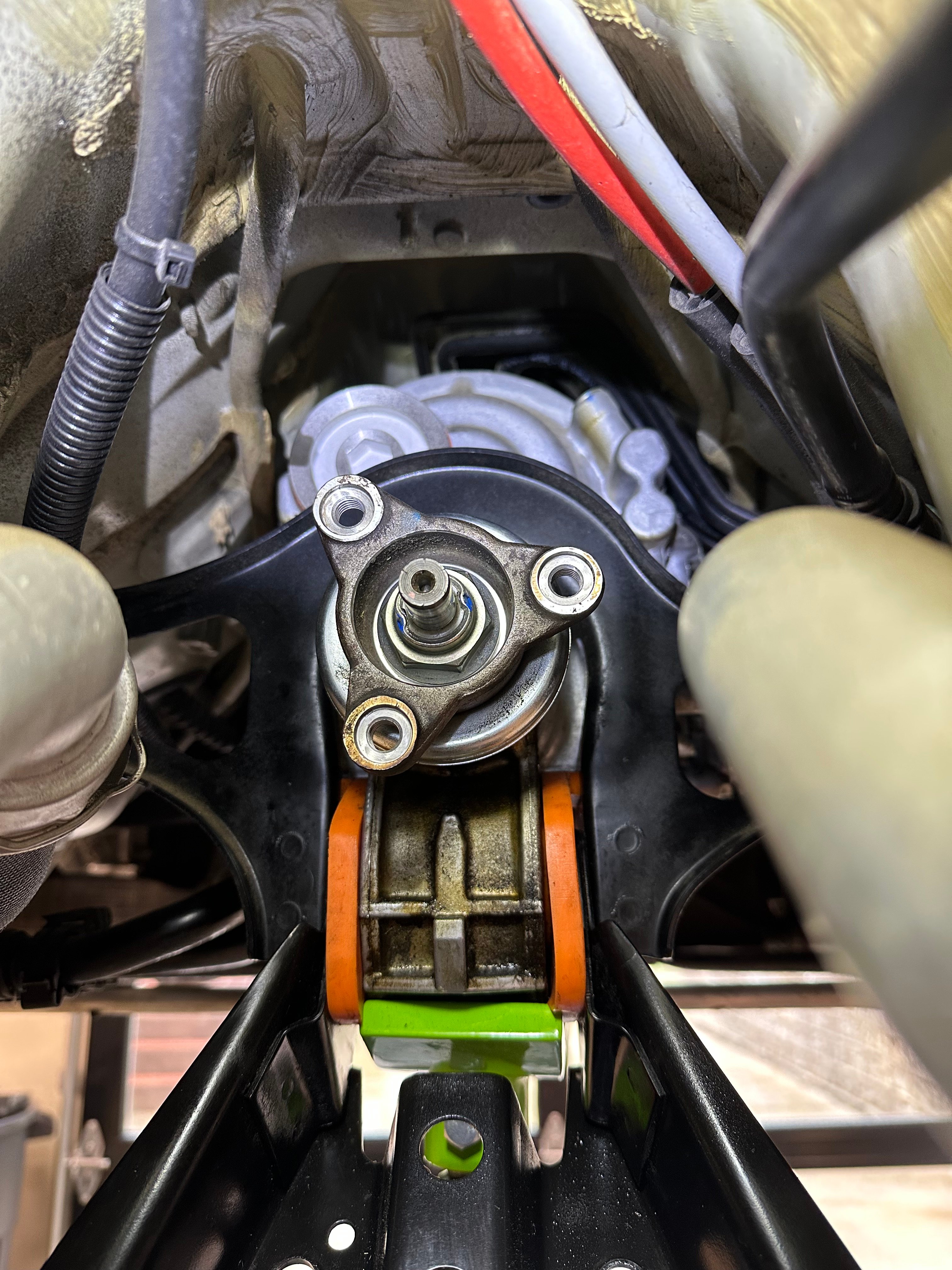

Took out the 16mm bracket bolts and loosed the transmission ones (15mm) (took the top one off to swing the bracket down)
Installed the cap after applying a little plastilube on the exposed metal, I used the factory bolts and snugged them down. I opted not to use any blue loctite as the factory did not. Looks like a great fit!
Torqued the bolts to 48 ft.lbs and put the bottom panels back on. Broke two studs in the process so I have another project….
Mike

Looking good! Did the metal inserts make contact with the metal on the flange? If not, I'd put some washers in there. If the plastic is bearing the brunt of the torque/compression, the bolts will eventually get loose and the plastic permanently deforms/compresses. Or put Nylock nuts on the back side. :)

The torx bolt flange was making contact with the insert’s, combined with the low torque value, makes me believe it will be good to go! I tell you those 16mm brace bolts Im getting a little shy of taking them on and off as if they break, it wont be pretty!

Right, there's no problem on the side with the bolt head. I was talking about the side where the 3D-printed part mates to the car. If that side is plastic on metal, I'd recommend putting washers in the flange recess to ensure you are torquing metal on metal.

Copy! If i had to guess the majority of the stress will be generated axial; What I will do is check up on it after a drive or two!
