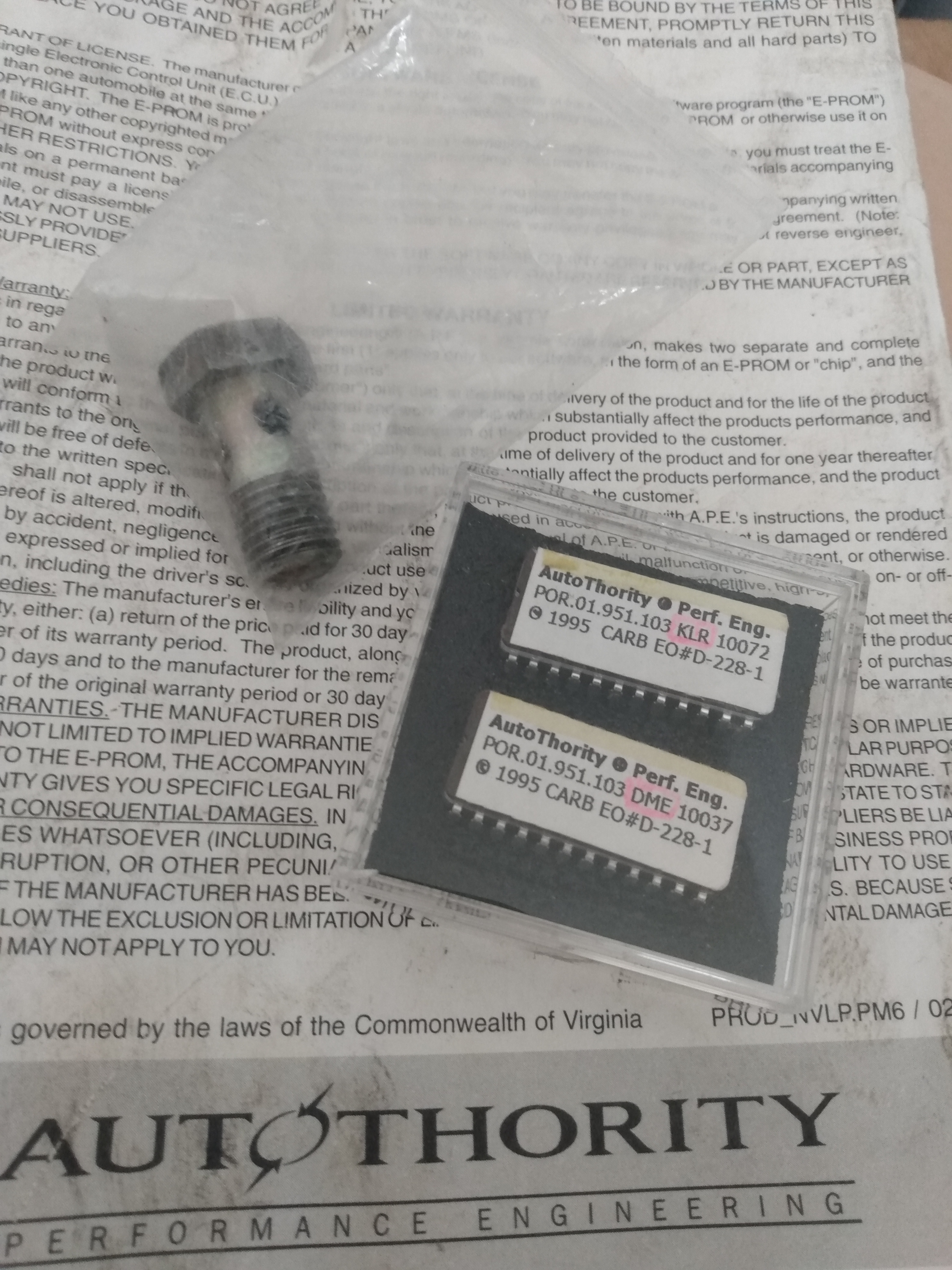

I've got a set of APE chips I bought off eBay several years ago. Came complete with original papers, chips, and Banjo bolt.
Unfortunately, it runs very rich with my 86 951no matter which setting I select.
I don't have the ability to read them, but I can send them to you if you are interested.

That would be awesome. I'll get them back to you asap. I'd love to compare them to the later APE chips I have. Will send you a PM. Thank you!dme wrote: Sun Dec 29, 2024 1:08 pm I've got a set of APE chips I bought off eBay several years ago. Came complete with original papers, chips, and Banjo bolt.
