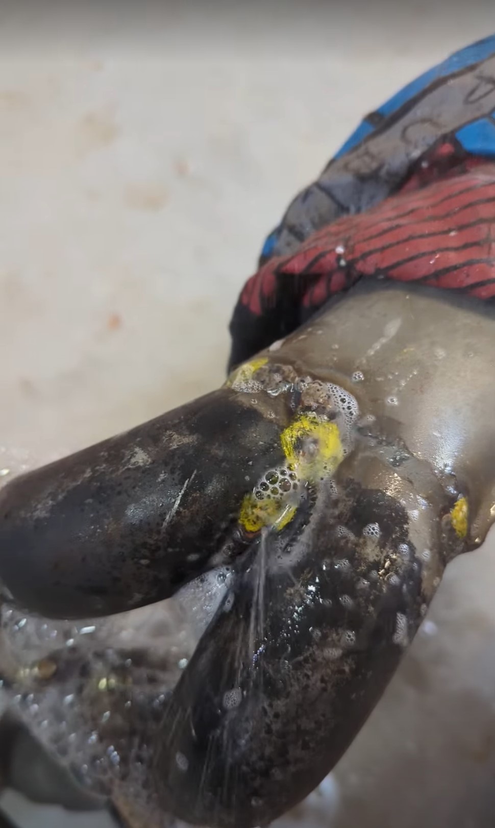

Well the run of progress has come screeching to a halt, my crossover and headers are Swiss cheese even after the repairs and I'm not sure there is value in continued attempts which will most likely fail again. Pays to check everything twice, Im tossing up now if its worth going all out and getting something custom made

Sorry to hear this.
If my car was RHD I would definitely consider a twin scroll set up...

The waste gate setup on a twin scroll system makes my head hurt.
I'm going to have to persist with the Turbo for now, I know it's not a popular option around here but buying it as a package at the time was the best way forward and the downpipe is very well made.
It's a pity the TiaL mount came back on the market 6 months too late. Even that would require modification to run a GTX35 if I'm remembering correctly.

On second thoughts those are not major leaks and may not, if at all, affect performance by wastegating an insignificant amount of the mass flow.

Thom wrote: Wed May 22, 2024 9:34 am On second thoughts those are not major leaks and may not, if at all, affect performance by wastegating an insignificant amount of the mass flow.
There is 2 large leaks and 4-5 small ones but the cumulative effect was I couldn't get the system to hold more than 10psi, though I was using quite a small compressor. Surely this is going to have a negative effect on spool on a turbo this size.

Since only small leaks remain, try repairing them with brass which only requires low heat. It's the relative extreme heat of gas or electric welding that often results in cracking and/or re-cracking.
