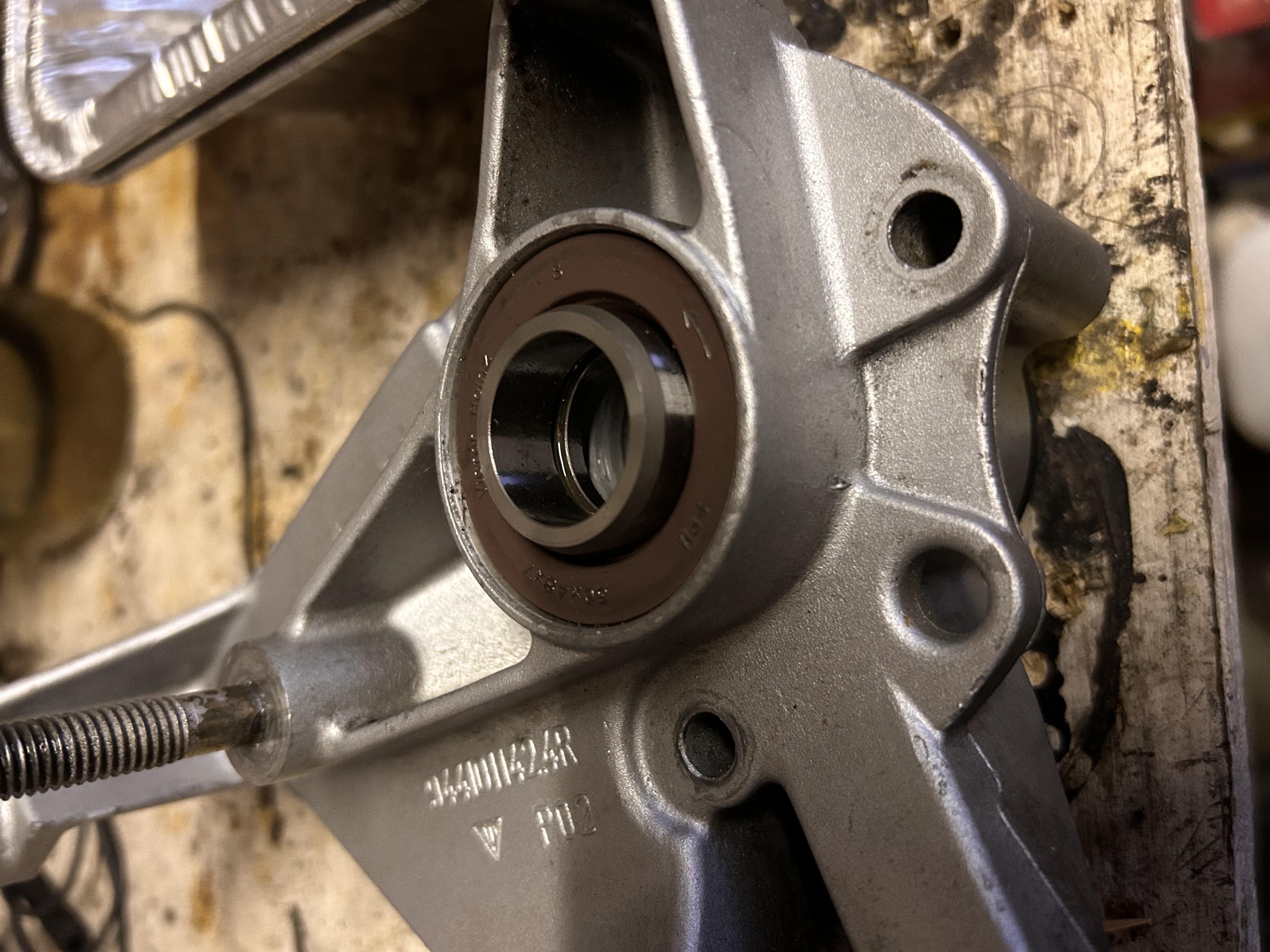

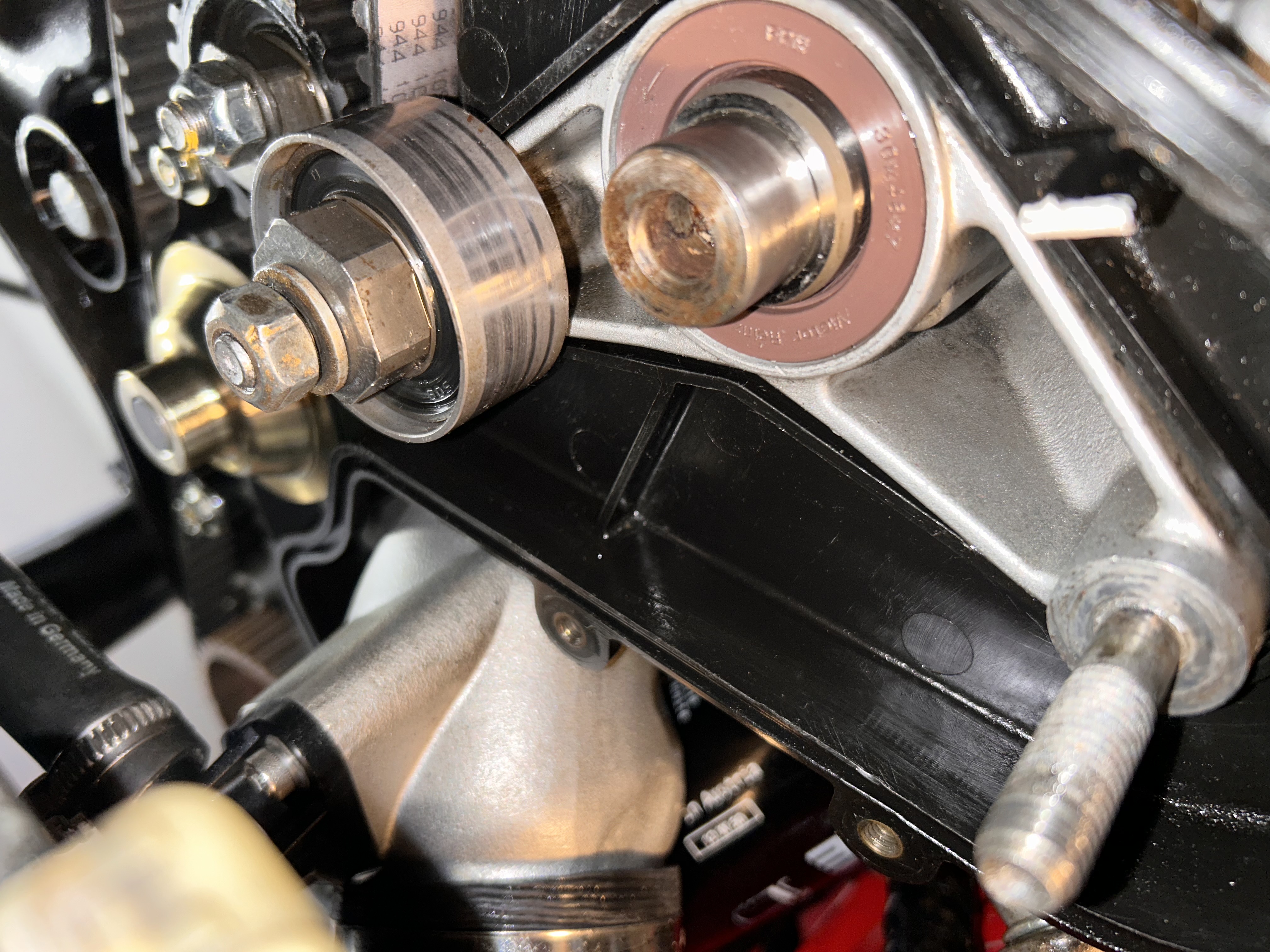

Sure you are using the correct seal? There are two different sizes. Also, how sure are you it's not the oil pan gasket right there in the corner? You had a pretty big leak for a less than obvious issue... ?
Re: Woohoo - Its alive, BUT...
Posted: Sat Oct 07, 2023 4:08 pm
by Drscottsmith
I know…that is the most puzzling part - although I thought it was interesting that air pressure through the dipstick would not force the leak.
It could be the gasket but I did check the bolts in that area early on and everything checked out.
The seal is the correct one according to PET (30x48x7).
I did notice that the upset shaft bearing does not protrude as much, and realized that I could seat the lower seal a little bit better see pics below. Again there was no leak from the seal, but maybe that had something to do with it.
Thus far I have not removed anything related to timing. Can I safely reinstall the balance shaft cover and starter and start the engine (with no balance shaft belt, not alt or ps belts, no covers, etc) to check for leaks?
Posted: Sat Oct 07, 2023 4:11 pm
by Drscottsmith
after pic
Before pic

The motor does not need the balance shafts to run, but if you don't have some way to block the oil feeds, you'll be pumping oil into the covers and out the big hole in front. But you could put it all back together without the timing belt covers to see if that gives you a better sense where the oil is coming from. I'm leaning toward the oil pan gasket if everything above it looked clean and good.

No I meant put the lower balance shaft back together minus the belt - just so everything would be sealed up and pressurize so I can see everything and pinpoint the leak.

Ok well looks like Tom wins!
After pulling it all apart and putting the bare minimum back on to get it running, it definitely looks like the leak is from where the oil pan meets the bottom side of the oil pan gasket.
Doesn’t look like any is seeping out of the top side of the gasket.
So now I get to figure that out, but now we know.

Hmmm... sorry about that. That usually means the oil pan needs to come off. :(
