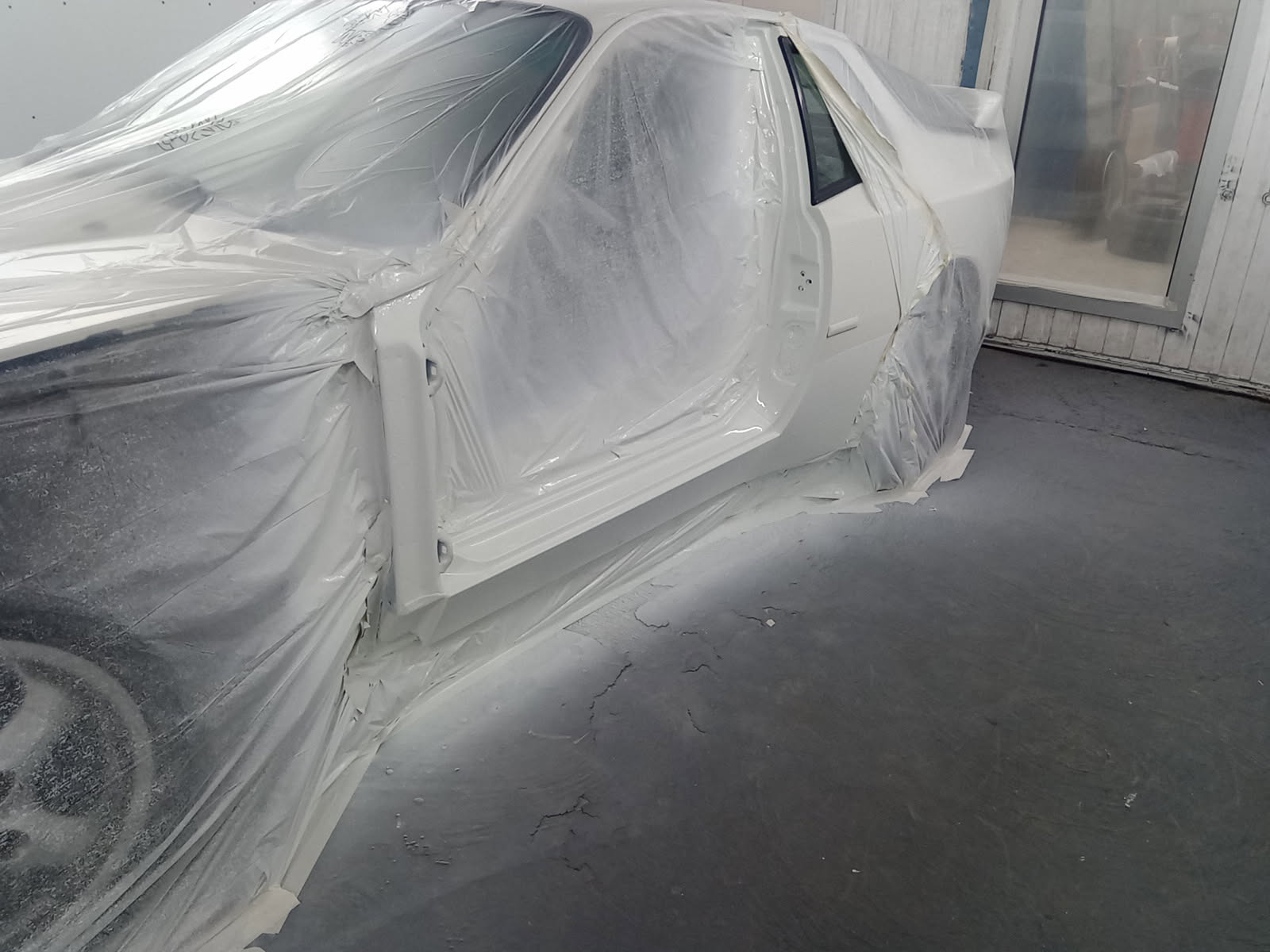

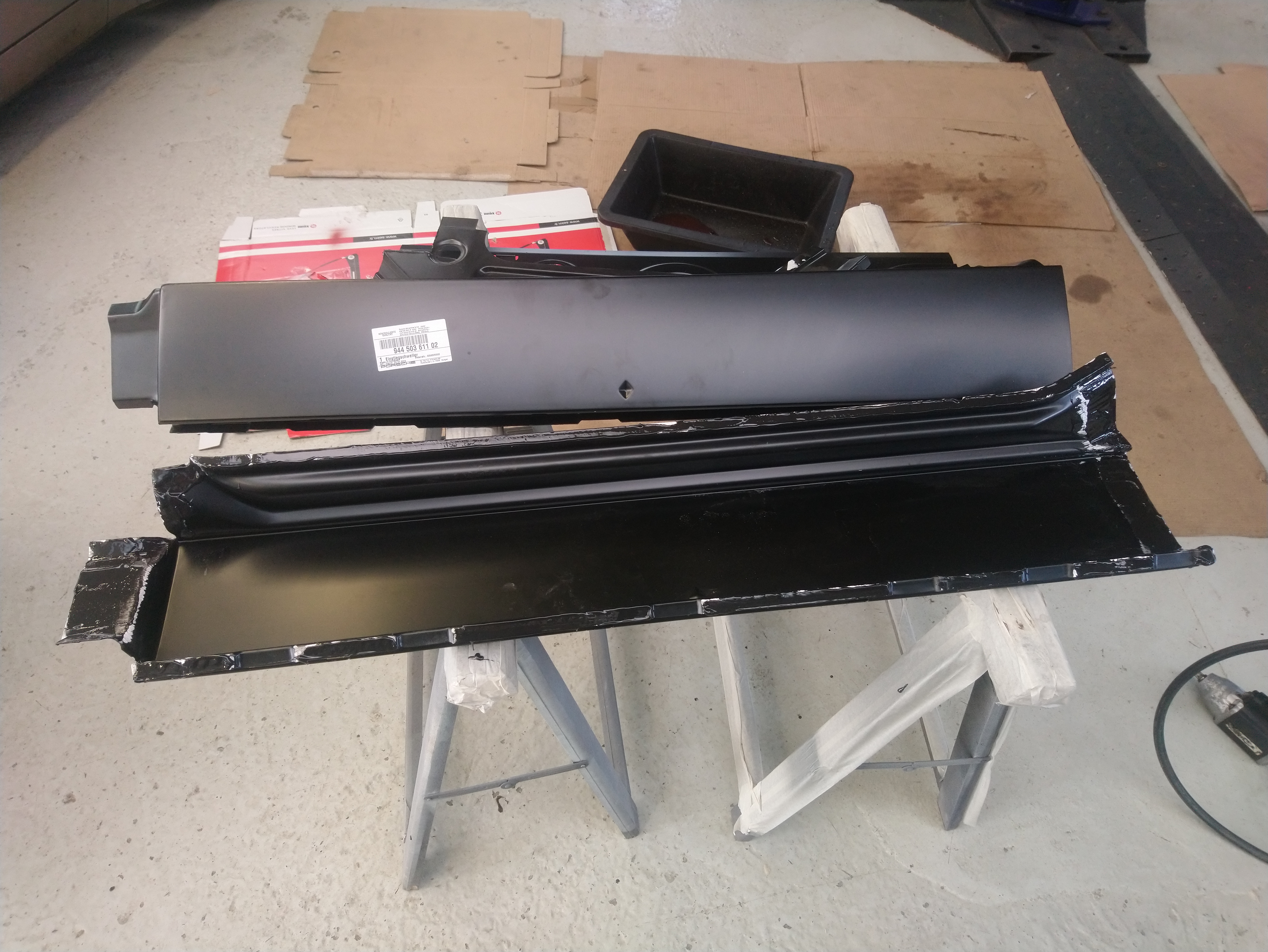

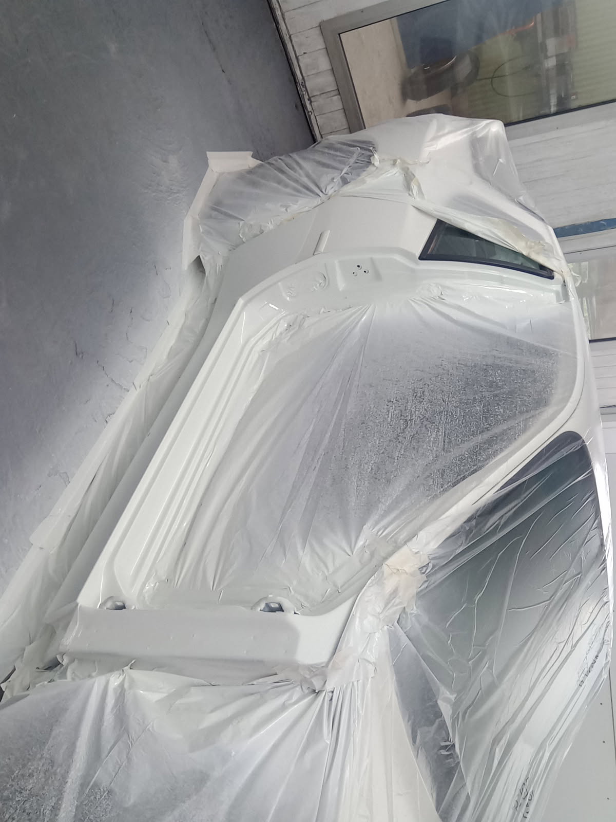

Pleased to say my car has brand new sills. The rust dated back from before I bought the car but I found an officially retired professional body worker who agreed to help me replace them so this is done at very long last. Had the sills repainted in Grand Prix white to match the CS seats so that means there are now 3 different shades of white on the car but nevermind. The plan is to have it fully repainted in Grand Prix white "one day". In between drying sessions between primer, gravel protection layer and final paint we found the time to fit the new clutch disc from South Bend. I can't say if it holds the torque yet as the first and only full load acceleration on the way back home caused an intercooler hose to pop out and since the roads were wet anyway I didn't take any more risk. Crashing a car that just went through significant body work repair would have been a little embarrassing.

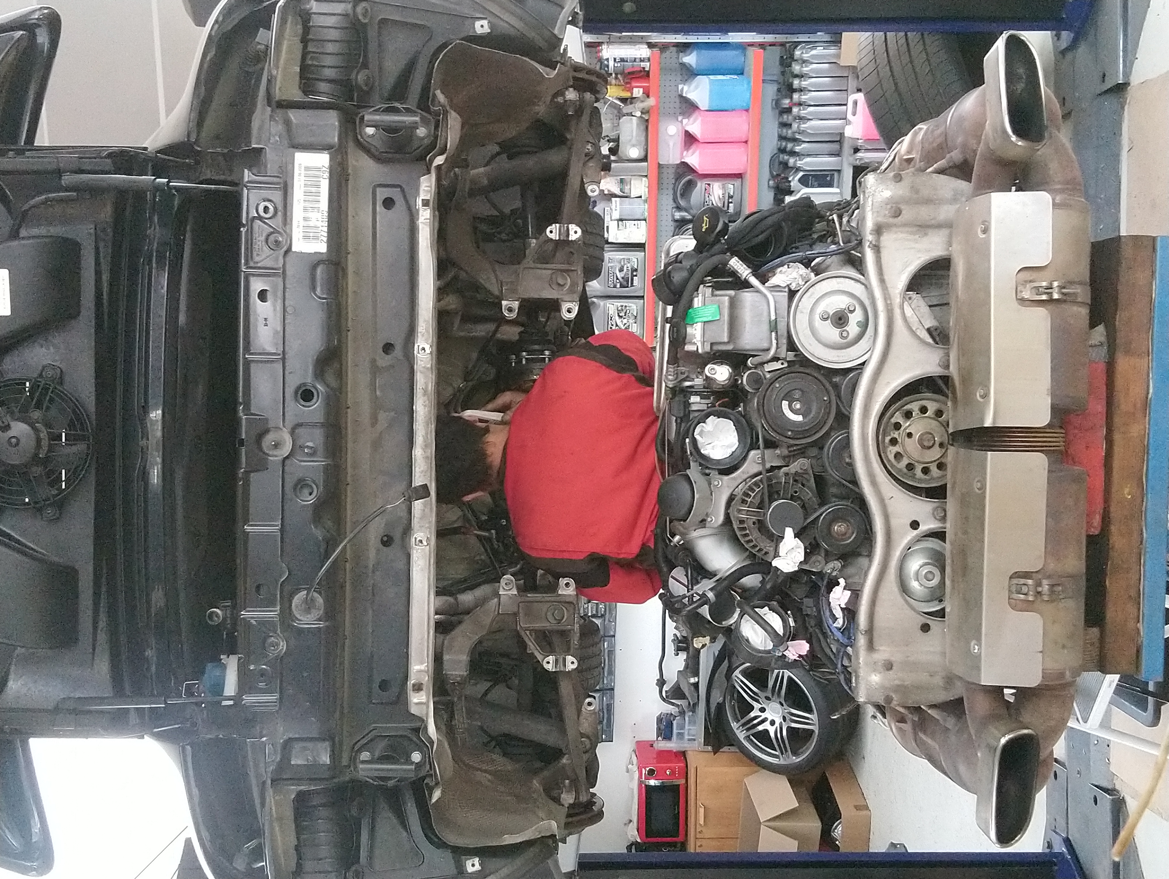

I also helped my friend who provided the room for the work on my car replace the clutch on a customer's 997 turbo. He found a good spot to answer phone calls.

#334
Posts: 616
Location: Nashville
Has thanked: 525 times
Been thanked: 268 times
Nice Office!
Kudos to the decorator.

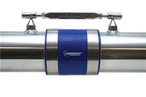

Paint work is looking good! How is the engagement on the South Bend clutch? Smooth as stock? I worry a bit about my recommendation because it looks like a more aggressive disk than the one I had.
And, at the risk of annoying you....
Vibrant Boost Brace.jpg (7.08 KiB) Viewed 1242 times

No room for one of these rods as the sleeve at the IC inlet is too short. This is the first time this happens since fitting the custom intercooler and I suspect that's because ambient damp goes through rubber on long periods of letting the car sit unused. It should be fine again after degreasing the connection.

New Grand Prix white is looking clean let us know how she looks on first drive after put back together Thom

Boostfeen wrote: Mon Oct 13, 2025 11:38 am New Grand Prix white is looking clean let us know how she looks on first drive after put back together Thom
Well, there is a picture here, which @Tom made me the honour of using for the latest banner - I bow to you Sir but the car is not worth it! :silent:
The car has been out only 3 times since picking it up with the fresh sills from my buddy 3 months ago, each time in poor/wet weather (to pick up stuff for other cars that have been taking way too much of my spare time lately :crazy: ). The new clutch is still difficult to adjust to, very on/off, and the car has definitely lost its easy-going, drive around/shopping trolley abilities but trying to see the glass half full in that the clutch now demands a level of focus in line with the straight-line performance. Jumping back into this car after enjoying others with far less punch is always a surprise and opening the throttle to run at only atmospheric pressure whilst casually cruising in 5th brings the speed from 60 to 100 mph in the effortless and comfortable manner of a jet about to take off, suggesting the larger turbo flows just what the head needed to show its true colours even at the lightest loads, making the car not only a rear tyre executioner but the ultimate long distance cruiser. It may sound like a hyperbole but it really creates its owner weather and you better be on it when you open the tap.
