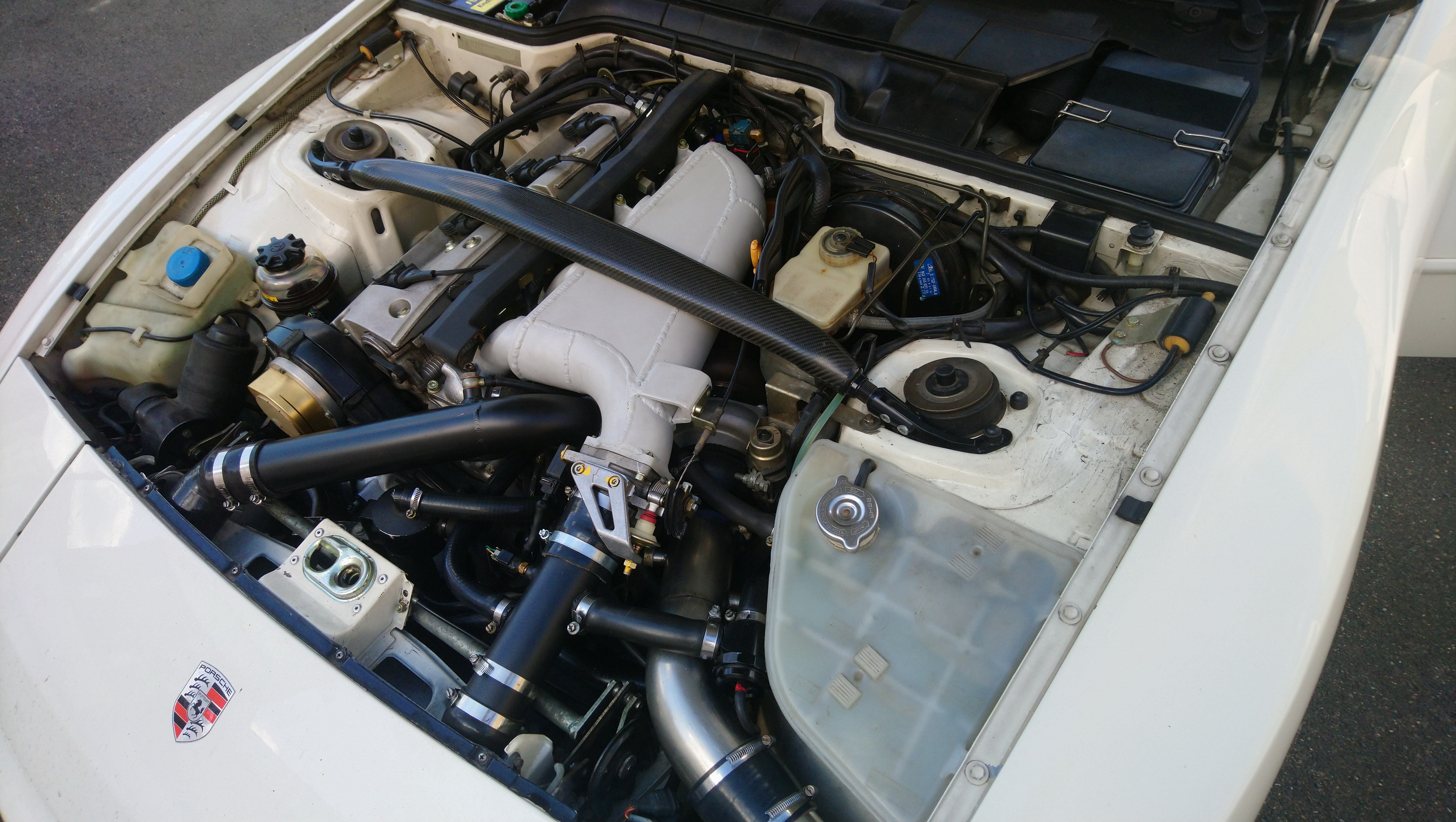

I only just completed the install but plan to take the car out tomorrow morning for a short drive as I will be visiting an 88 year old friend who needs a little help to put the engine and gearbox back into his vintage MG.
Yes @Tom, this is a stock turbo mount, though modified to support Garrett GT turbos with "large" turbine housings.

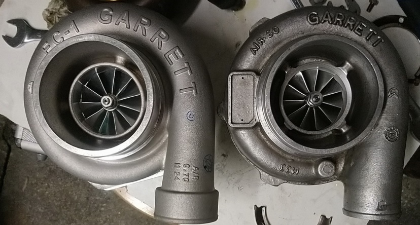

GTX3582R vs GTX3576R :
As I said the install was easier than with the '76 as the back plate of the compressor on the '82 is offset frontwards by a few mm and that allows the turbo to move a little more freely around the mount. With the '76 and the latest/largest 1.03 turbine housing used thus far I had to somewhat rub the turbo on and off the mount. Perhaps that small offset can be guessed on the picture below. I was not aware of this minor difference despite having read a lot on these turbos over the years, though perhaps we 951 folks who have always suffered from real estate issues are probably more sensitive to such details than other turbo freaks...
All buttoned up and ready to go. No leak, no smoke, no suspicious sound or smell observed after letting the engine warm up at idle to bleed the coolant circuit. Looking forward to the first drive.
