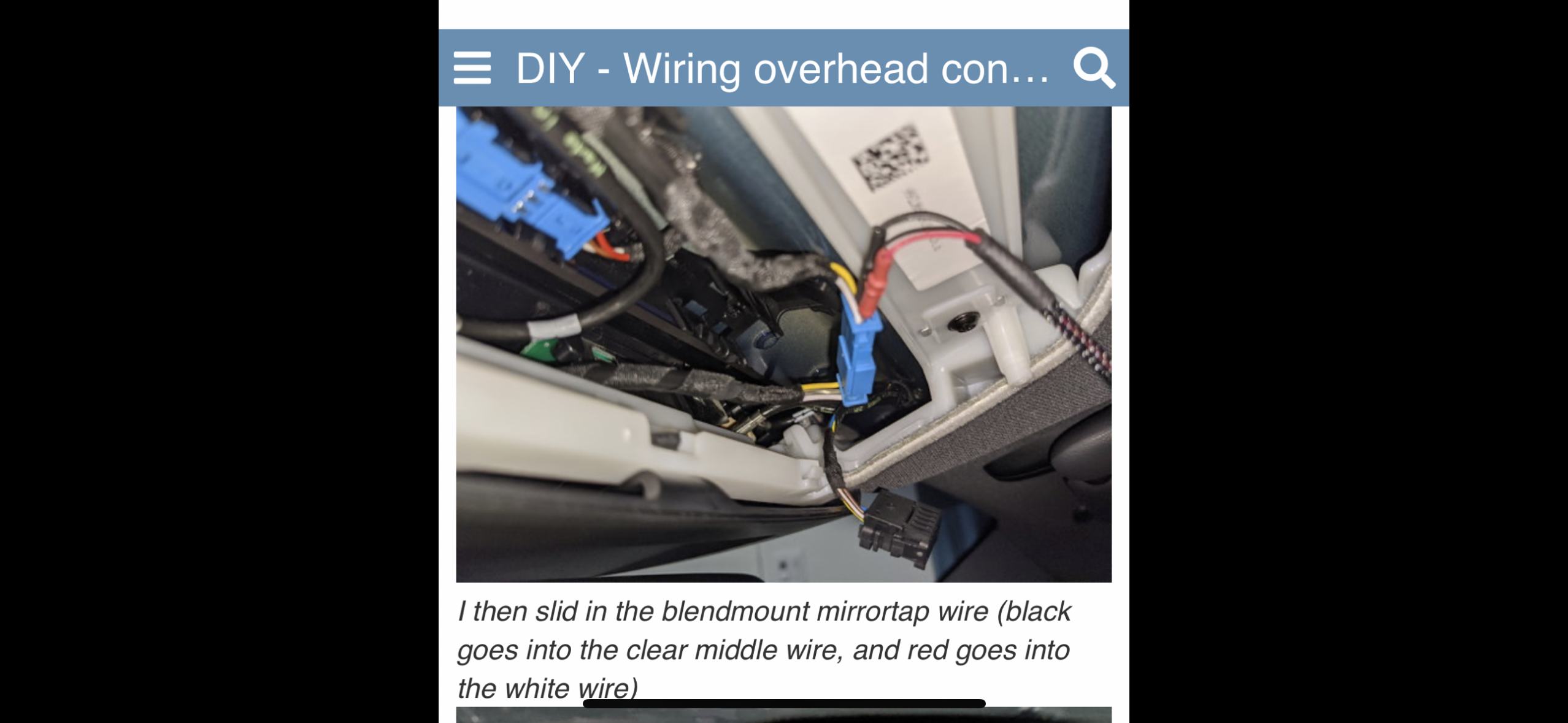

[attachment]
I assume the Dongar harness includes a 12v to 5v converter.
You could power this from the switched 12v wires in the blue connector. The ground goes to the clear middle wire the switched 12v goes to the white wire in the blue connector.
These are the same as the mirror tap connections that have been well documented.
Good luck πŸ‘πŸ‘πŸ‘

audi4t wrote: Wed Mar 01, 2023 4:33 pm 02DAA94D-440B-4680-9A1B-483A9C709DAF.png[attachment]
Still, no luck. I reached out to Dongar to see what they say. There's only one way this connector fits, and when it's connected, no power to the dash cam and airbag failure warning issued. The other set of blue connectors to the left doesn't fit the adaptor. So either, 1) Dongar doesn't make the 992 adaptor, 2) there's another connector that is hidden somewhere else, or 3) I'm a bonehead. My vote is # 3.

I guess the purpose of the Dongar is to tap a switched 12v supply and convert it to 5v and feed a USB connector.
The switched 12v supply in your 992 can be obtained from the cars blue connector using the clear and the white wire.
If the Dongar is not working then they haven’t tapped the correct wires to give you a switched supply.
I would either trace out the harness and correct the problem or probably just cut off the USB converter and using the mirror tap technique connect it to the clear and white wires shown in the above picture.
As best I can tell from your pic there is no USB connection to the middle wire of the connector.
On the 992 the blue connectors middle connection provides ground (clear insulation).

I found this spec sheet online for the Dongar.
This is not the correct pin out - ground has to be pin 2 πŸ€¦β€β™‚οΈπŸ€¦β€β™‚οΈπŸ€¦β€β™‚οΈ

audi4t wrote: Thu Mar 02, 2023 9:45 am 8F0DC93F-D9E3-4C32-A980-262BAC424DD2.png
This was a HUGE help!! Thank you!!! I ended up cutting the USB supply off and splicing it into the power supply and ground. A little extra work but turned out fine. Def needs to be reworked on Dongar's end.
