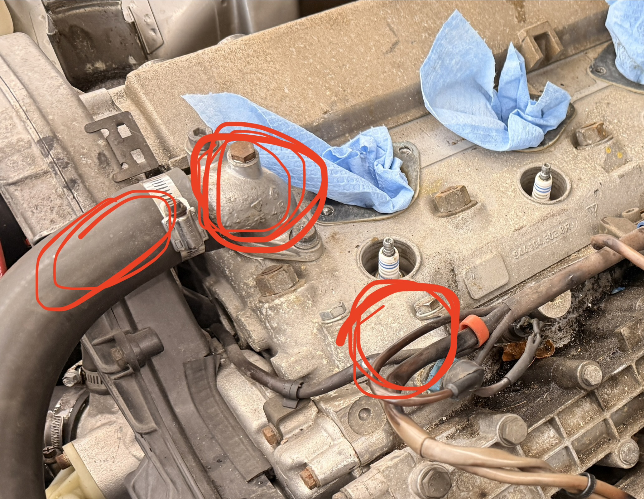

Well, since the gauge reads from where its threaded in, the gauge sender area of the head is an ok proxy. Assume some difference compared to the actual coolant. I also like to check the hose and inlet temps, as this is coolant coming into the head from the radiator.
Sorry the DME Temp sensor is circled here, but they are right next to each other...
Other diagnostics you can use a infrared thermometer for: Intake runners, Exhaust runners, head temps (all over), radiator temps (from the top) and the water pump/thermostat area. I have found miss-fires and bad cylinders by reading intake and exhaust temps and finding 1 cylinder (or more) WAY OFF from the others. I also use it to check tire temps when attending motorsports events.
