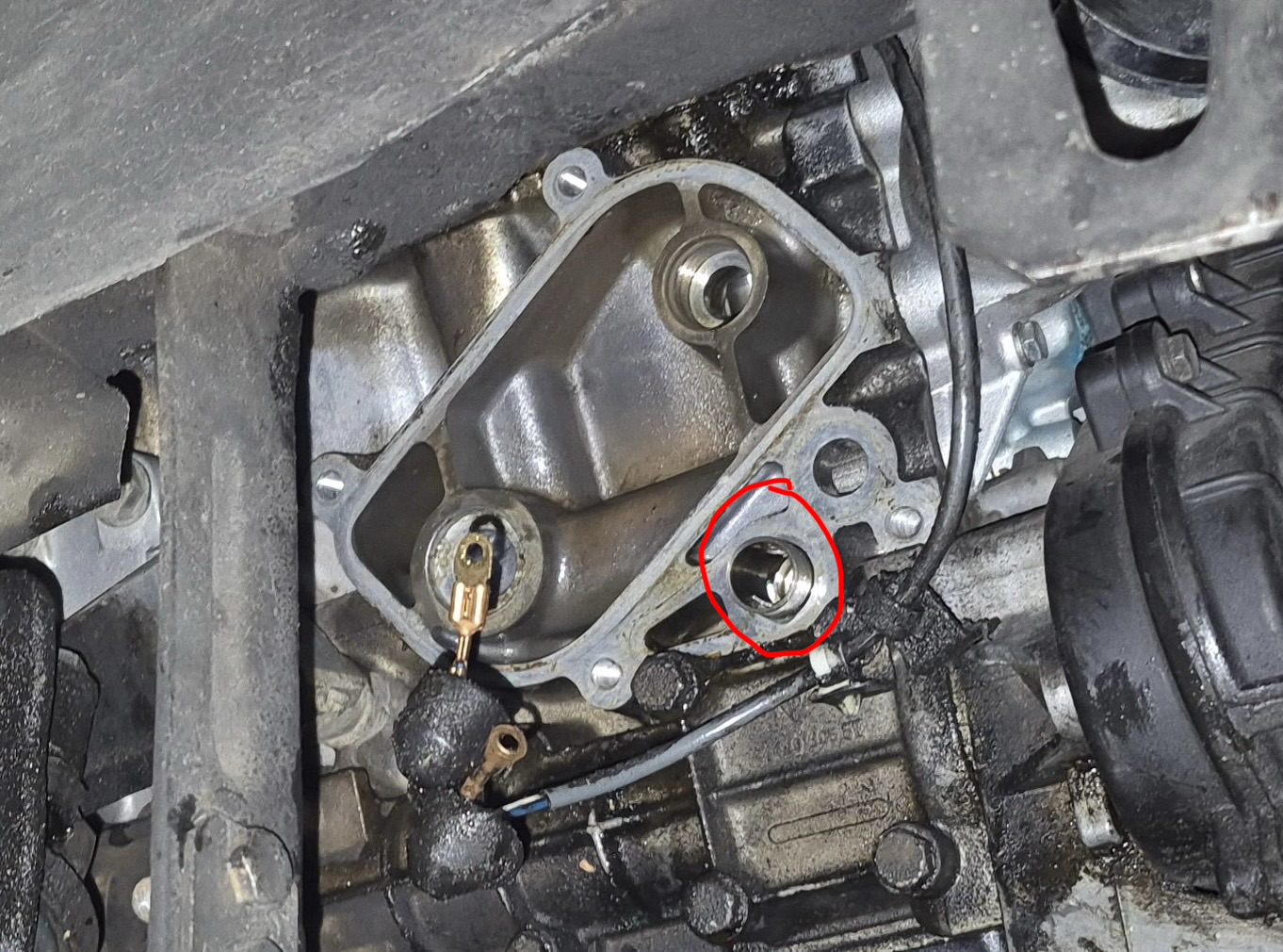

So I removed the housing tonight and I saw this protruding part by the OPRV and I was wondering if this is normal. I have removed the threaded component, spring, and the plunger though.
‘83 Platinum N/A 944

Posts: 8970
Has thanked: 943 times
Been thanked: 4029 times
We are doing similar jobs at the same time, just n/a v turbo.
The sleeve is normal, and should not be loose.
Not all set-ups require the shim. Did you see this video. Hit settings and turn on captions in english...
