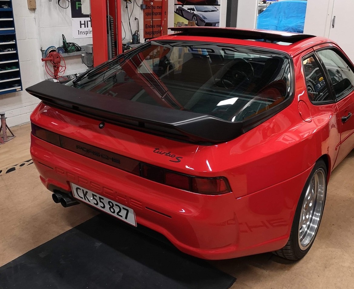

Center panel light would not be my personal preference. That being said, it’s always difficult to judge and things sometimes grow on you. In the end I could be like, why did I ever doubt this lol

944m3 wrote: Mon Feb 10, 2025 11:31 am Center panel light would not be my personal preference. That being said, it’s always difficult to judge and things sometimes grow on you. In the end I could be like, why did I ever doubt this lol
Probably based on past experience. I really dislike the old school tail light panels. They were cheaply made and fit badly.
But this look pretty nice to me!

chris white wrote: Mon Feb 10, 2025 11:04 am We are in discussions with the fellow that makes the bumper shown a couple of posts earlier. Out of all the concepts I have seen this (IMHO) is the best take on a more modern 944 look with out going too far. The original designer made it as a bolt on to minimize changes to the existing body and paint. Initially I really didn’t like the seam at the rear quarter and then I realized it was reminiscent of the 968 bumper. But since we are doing full resprays we can permanently mount it and make it seamless. The other issue is the clever way he did the taillights. The new bumper cover goes over the stock lower half of the lights. Looks good at a distance but not the way I would like close up. So we are going to get them made with a return to the stock rear metal work at that area. Custom modern LED tail lights to be designed and fabricated. Still thinking about the center panel. With modern 3D printers the sky is the limit.
I favor keeping some of the original design language for the tail lights, 3 segment display.
Any thoughts on the center panel?
I does look a lot sleeker than the original. I guess you have to decide if that's the way you want to go with the overall looks of the car. I think it makes it look a little too much like a Nissan, especially with the centre Porsche script / strip. Perhaps with that removed it might look more like our cars?

chris white wrote: Mon Feb 10, 2025 12:53 pm
I don't see the logic in modernising the rear of a 944, when the front end would stay pretty much original. It would perhaps work on a 968, if the front end was modified with a 993 headlamp/wing conversion.

blade7 wrote: Tue Feb 11, 2025 4:37 am
It comes down to ‘taste’ which is not logic based! The front end of the 944 has held up quite nicely to age and different trends. Maybe a little splitter but not much else. I always felt the tail alights were the weak point in the 944. Everything else followed and then they stuck some lights that looked like they stole it off a Volvo. The build quality of the lenes was not Porsche level. And once yours have filled up with water its gets hard to love them anymore!!
This project is not a restoration. I am sure there are some really nice cars that should be restored. This is a take on what may have happened if Porsche kept making them.

I don't see much 'taste' in cladding the rear of the car in this plastic bling. And we already know what the evolution of the 944 looks like, it's called the 968. All just imo obviously.
