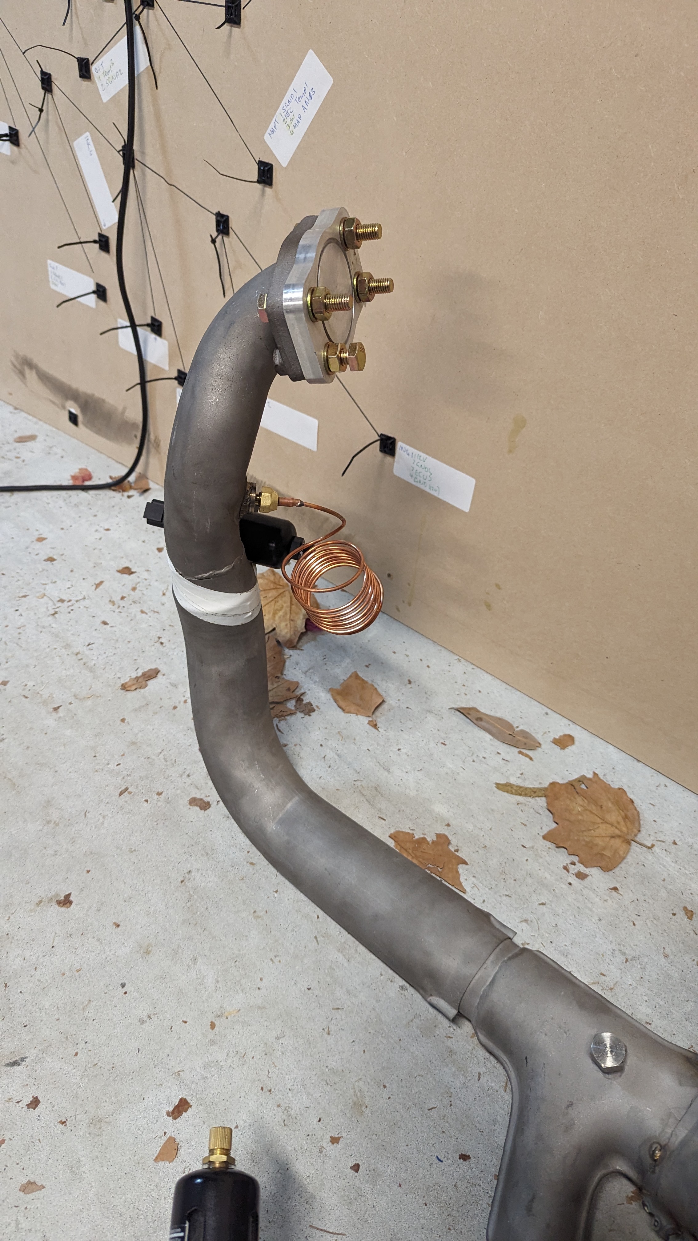

How hard was it to take the flanges off the cross over pipe without damaging the tubes at all? A friend building his own 16V engine has not been very successful with this so far.

The rear flange was already cracked so it didn't take much to get that off, the front one the weld was super hard and it got a little chewed up by the die grinder. I've given it to a fabricator to weld because it's beyond my skill, hes going to clean it up and realign the flanges so it's not under so much tension when we put it back on.

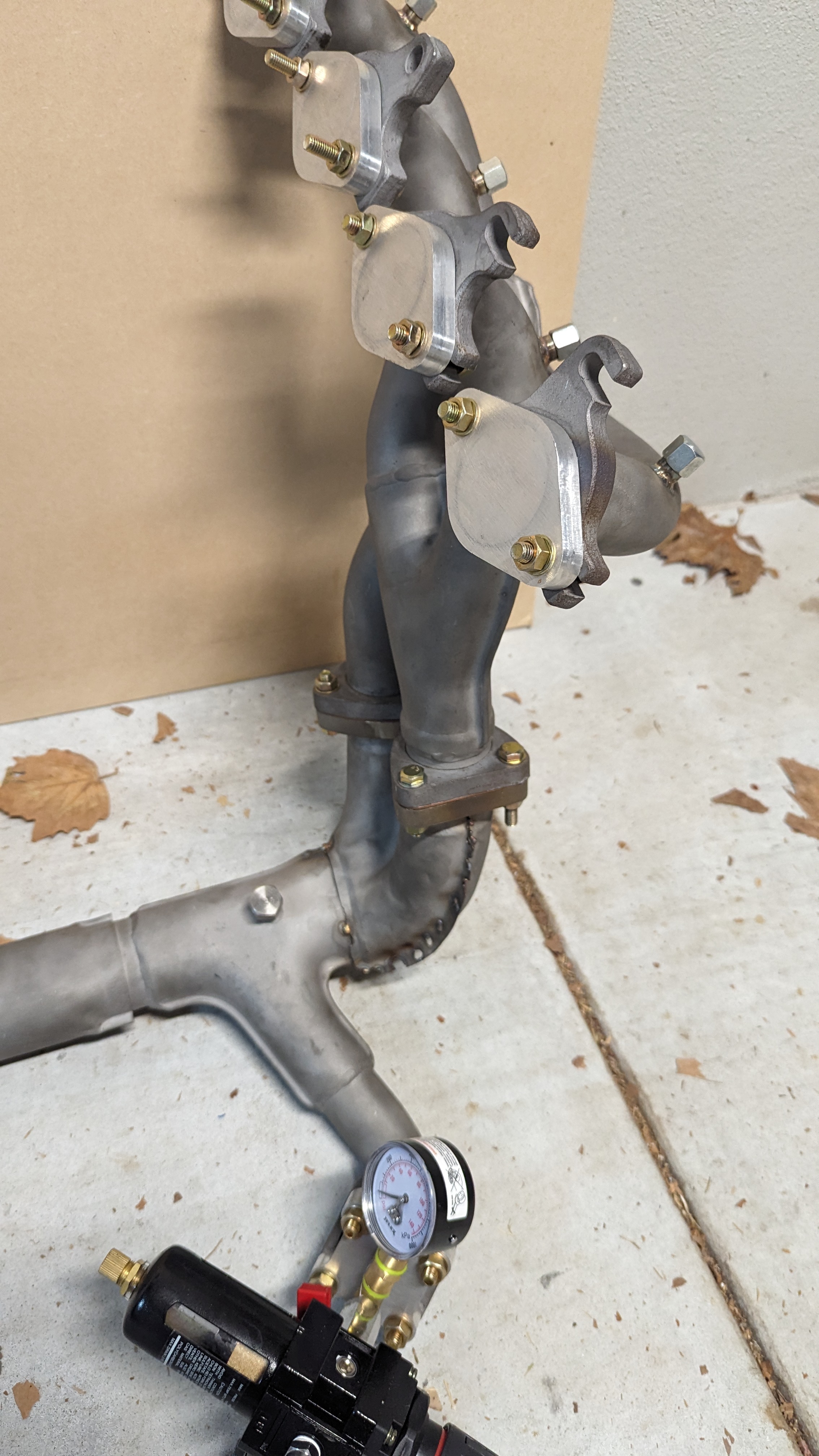

Ive just got my crossover and headers back from the fabricator and while he's done a great job we are having a great deal of trouble getting a seal on between the headers and crossover do the amount of warping on the S2 headers. Id recommend your friend leave the flanges on the crossover if he can and change the header flanges to the turbo type with the crush ring grove in them. We've had the flanges ground mostly flat, and have ordered some Remflex gasket material so hopefully that will solve the problem. Once everything is proven leak free its going off to be ceramic coated, dont pay too much attention to the headshield, it had to come off to repair a crack and the fabricator wasnt able to save it, its going to come off again and be replaced with some Zircotec Form I think.

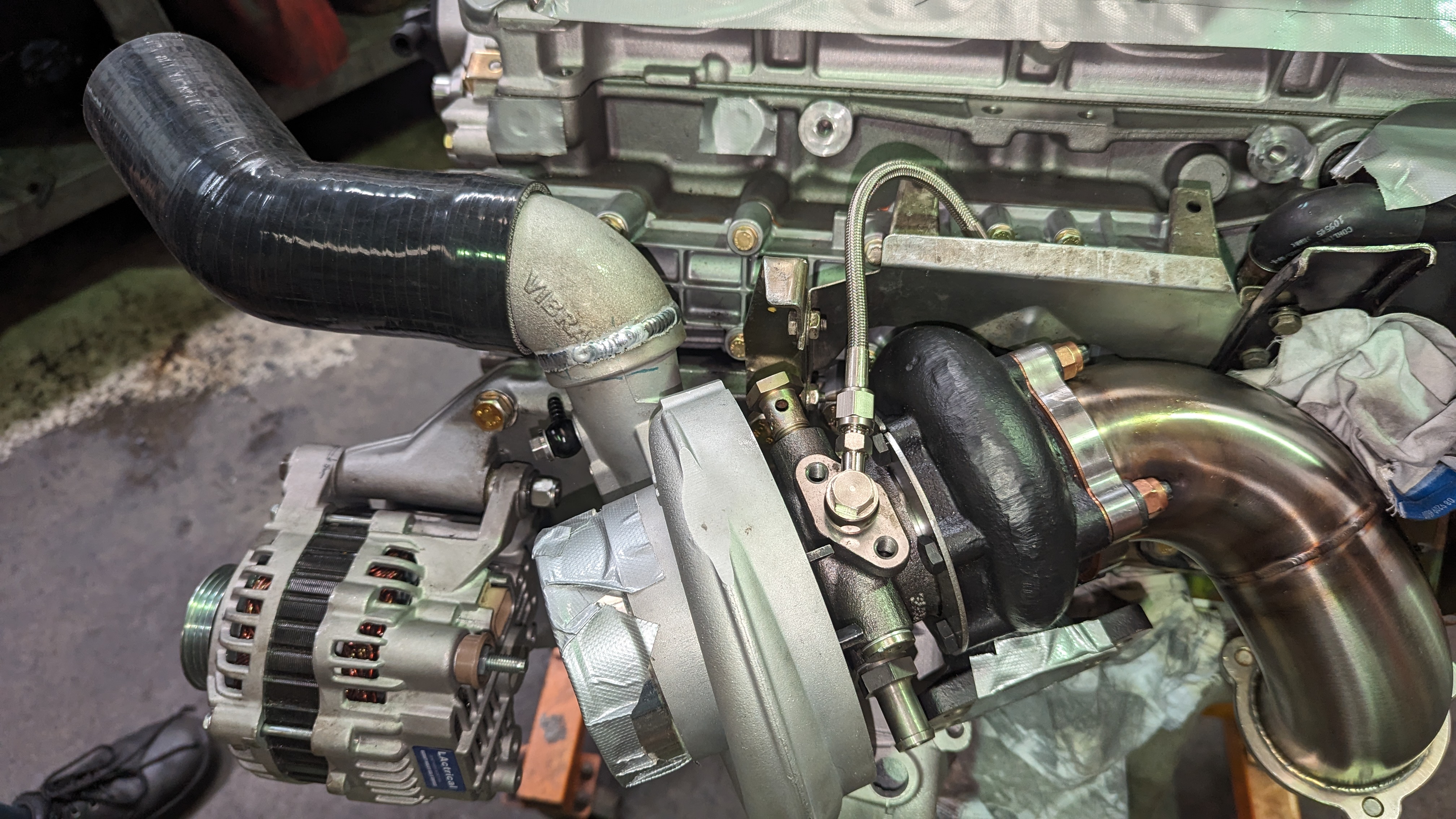

The Hayward manifold has caused quite a few issues which have been holding up getting the car started again, the clash with the water outlet pipe (solved), a limited amount of room to get the pipe through from the turbo outlet to the intercooler and a clash with the S2 AOS. We ended up having to weld an elbow to the turbo outlet and clock the throttle body 20deg so we can bring the piping out parallel to the balance shaft housing.
We were planning to use the S2 lid on a turbo AOS but due to the angle of the outlet barb we only have 2mm clearance to the underside of the manifold. I have some fittings coming to mod the turbo lid so that we will hopefully be able to get a 3/4 hose out through the small gap that we have, along with the harness and vacuum lines that run through the area. I do have the AOS delete fittings on hand but there is very little clearance from the heatshield for the bottom fitting and I would like to avoid having to fabricate somewhere to fill the oil if possible.

Bergerac wrote: Mon May 20, 2024 6:54 pmIve just got my crossover and headers back from the fabricator and while he's done a great job we are having a great deal of trouble getting a seal on between the headers and crossover do the amount of warping on the S2 headers. Id recommend your friend leave the flanges on the crossover if he can and change the header flanges to the turbo type with the crush ring grove in them. We've had the flanges ground mostly flat, and have ordered some Remflex gasket material so hopefully that will solve the problem.
Thanks. Swapping the flanges on the headers is what was done on mine, with no issue so far.
