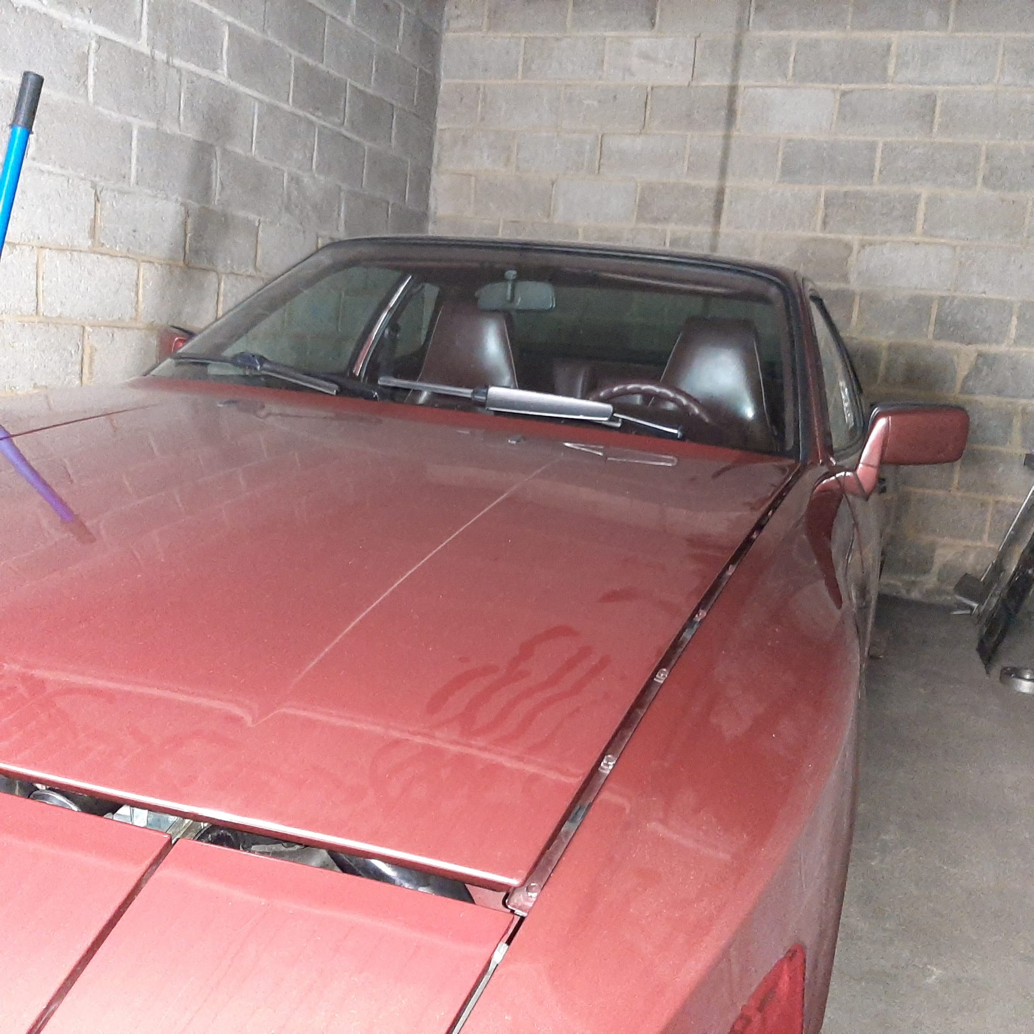

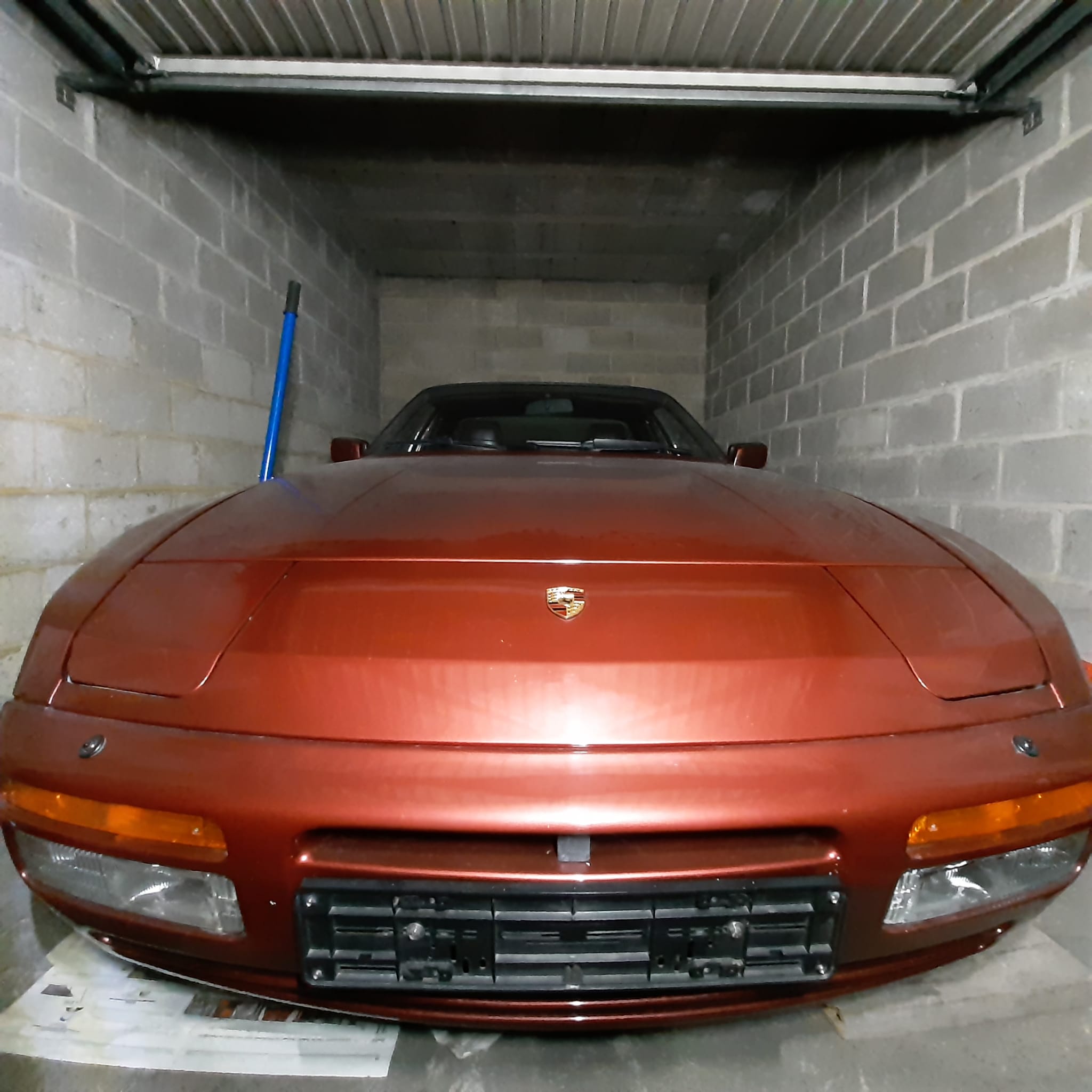

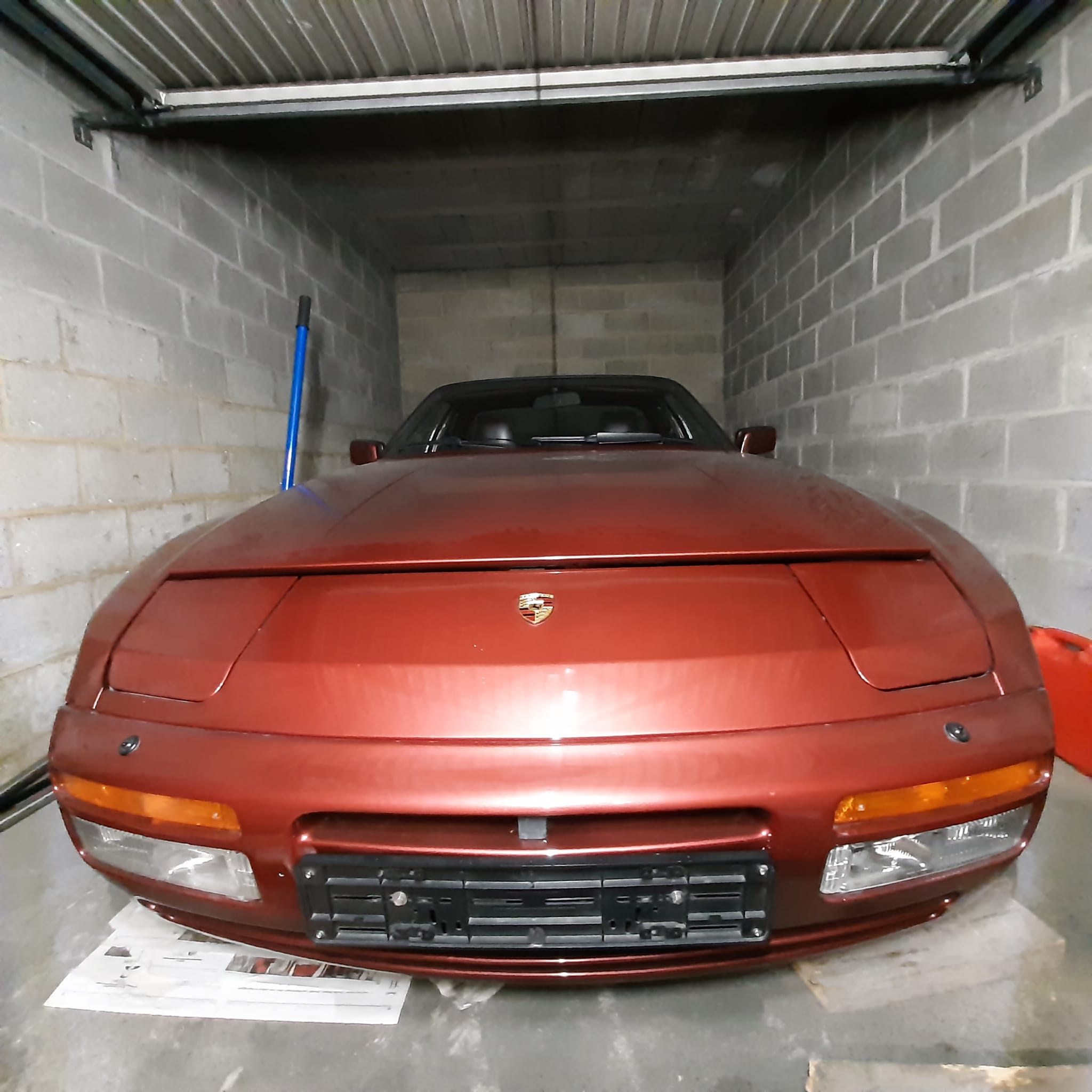

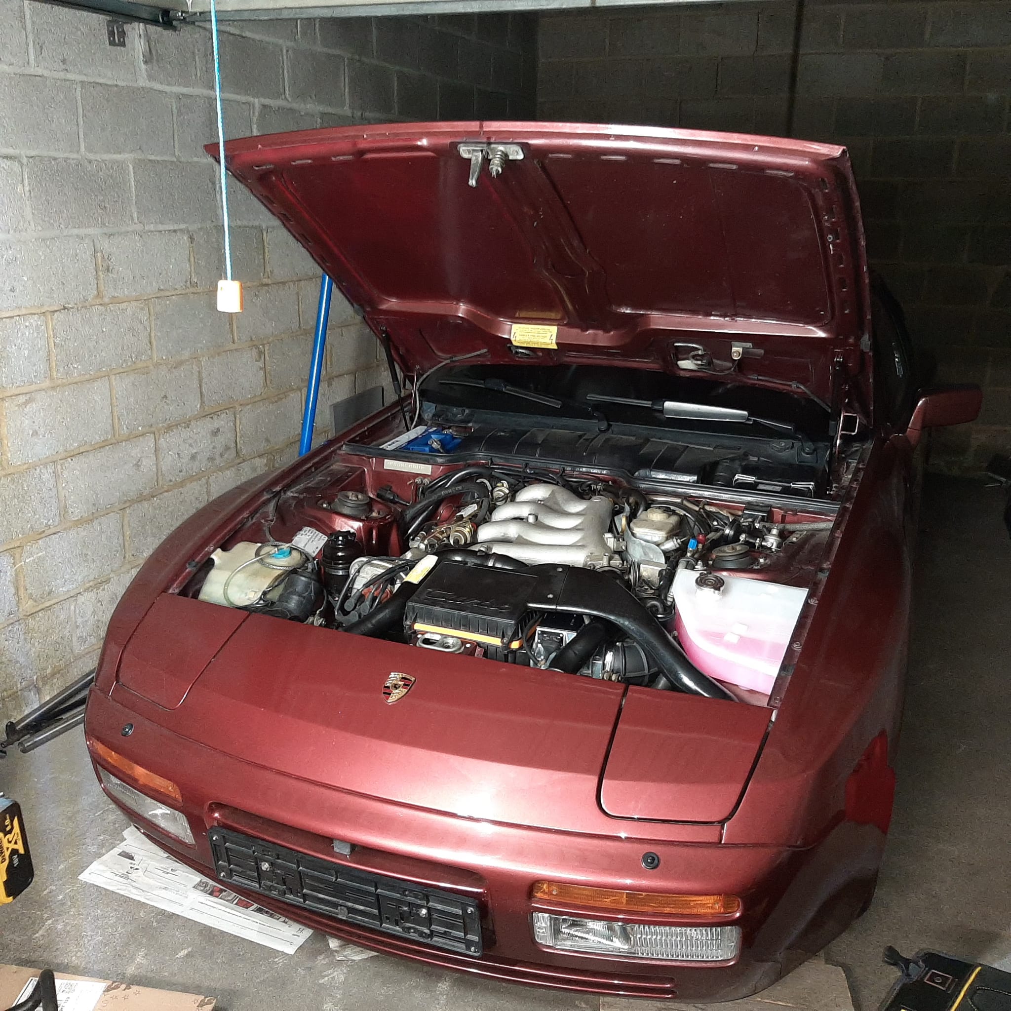

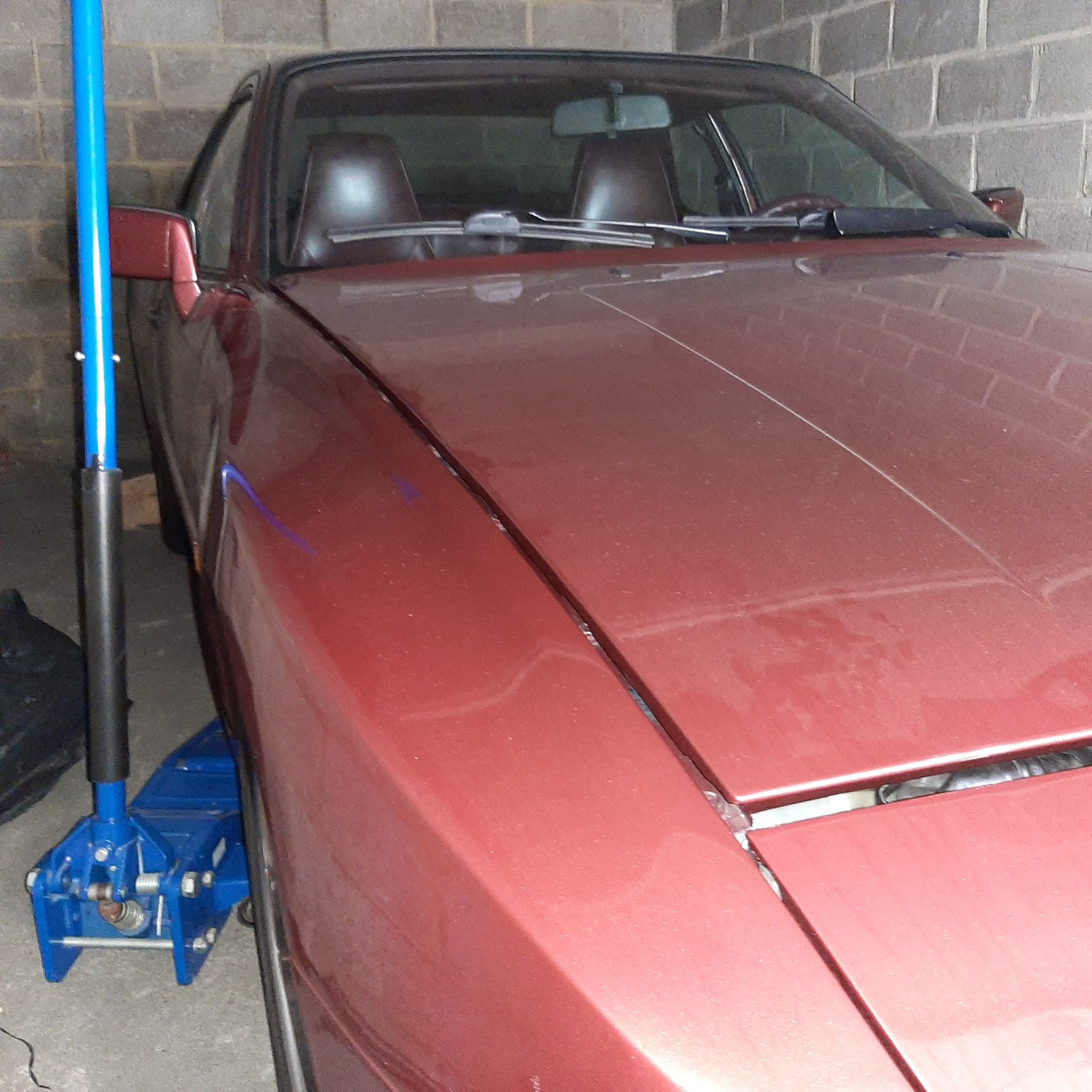

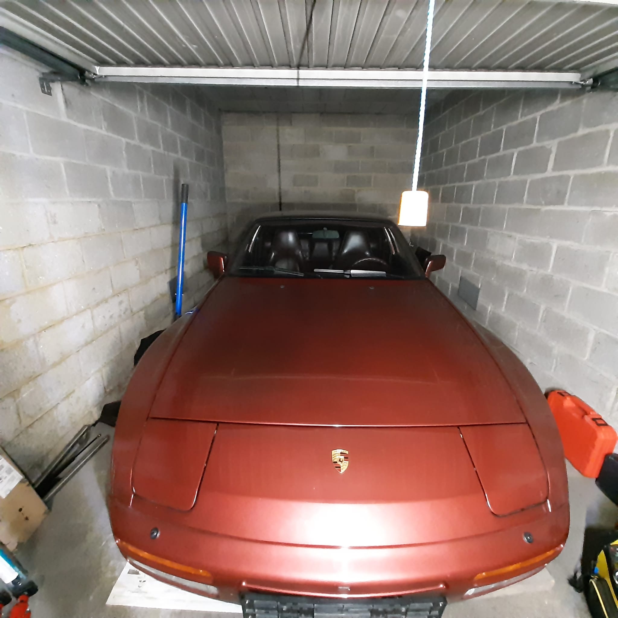

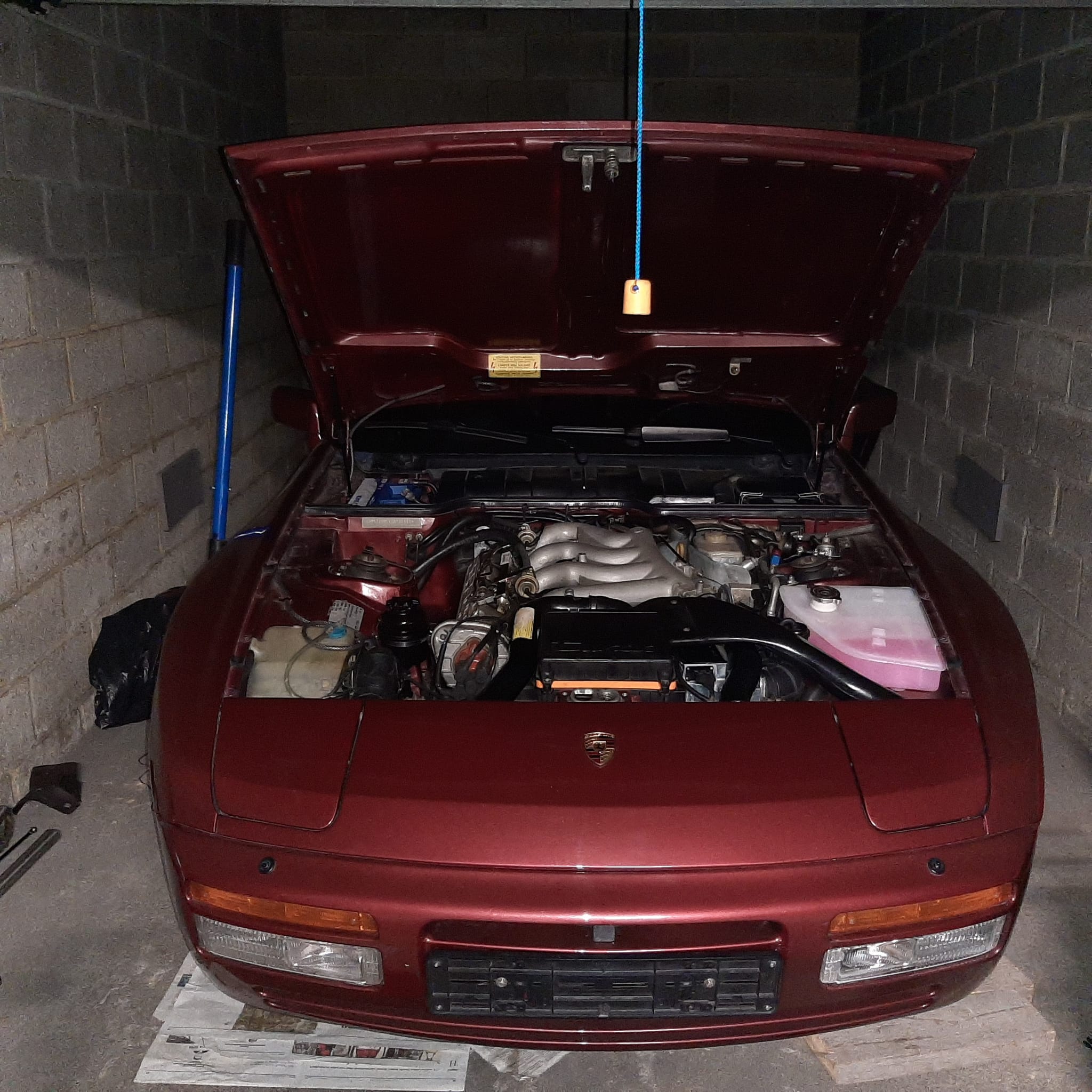

Ok, I got back into the garage and tried a few things. I also took photos (warning, many photos incoming):
- OEM air filter box + filter + snorkel installed: doesn't close
- OEM air filter box + filter installed, snorkel removed: doesn't close
- OEM air filter box installed but upper portion and filter element removed: DOES CLOSE
- OEM air filter box installed but filter element removed and top part loosely placed on lower part, snorkel removed: doesn't close
- turning the intercooler pipe a few degrees didn't change anything
- when the hood does close in the above scenario, it seemingly does very well. Hood gaps on the side and front are evenly spaced
Here are the photos.
Overview of the engine compartment with full installation of filter
WhatsApp Image 2024-03-10 at 11.39.19.jpeg (440.43 KiB) Viewed 769 times

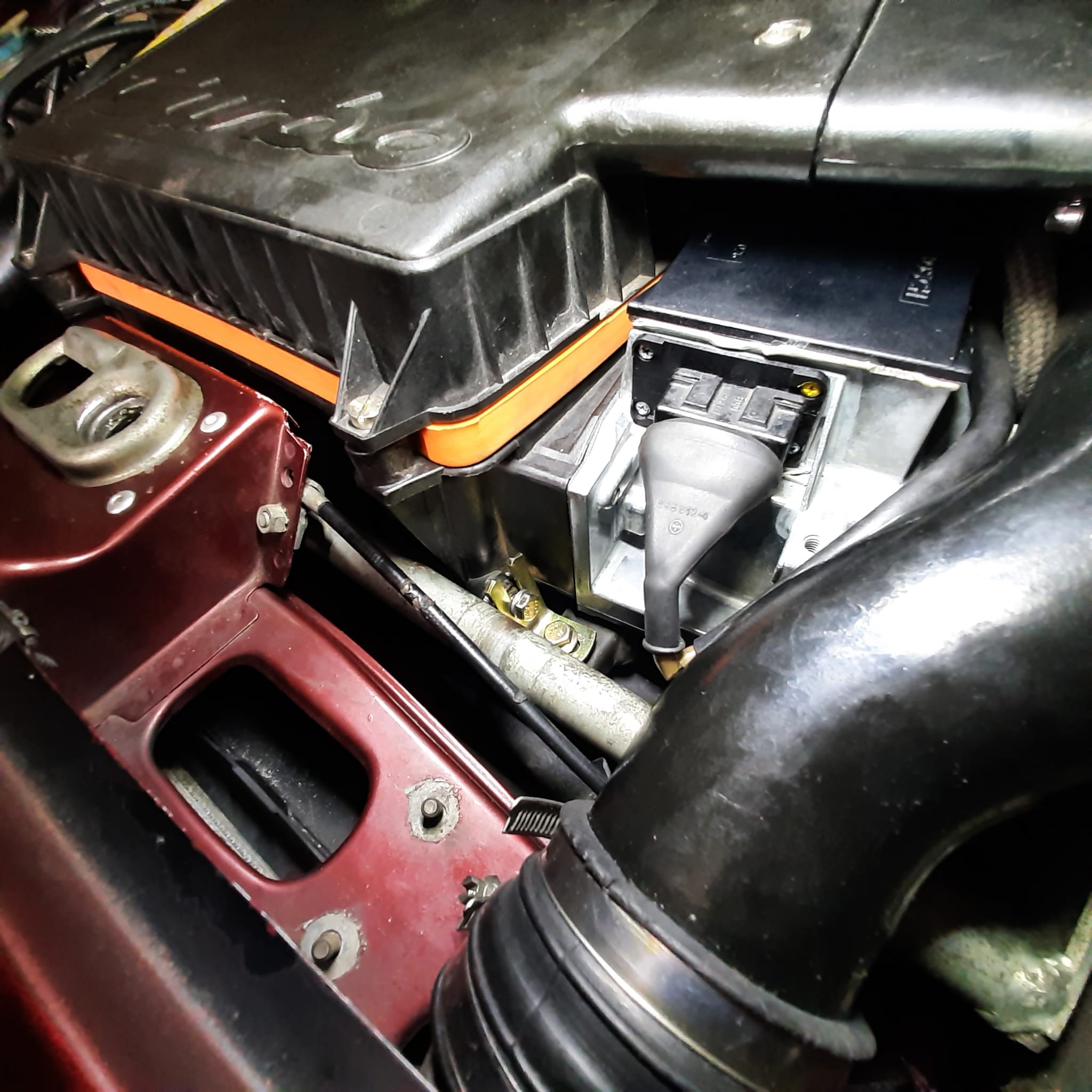

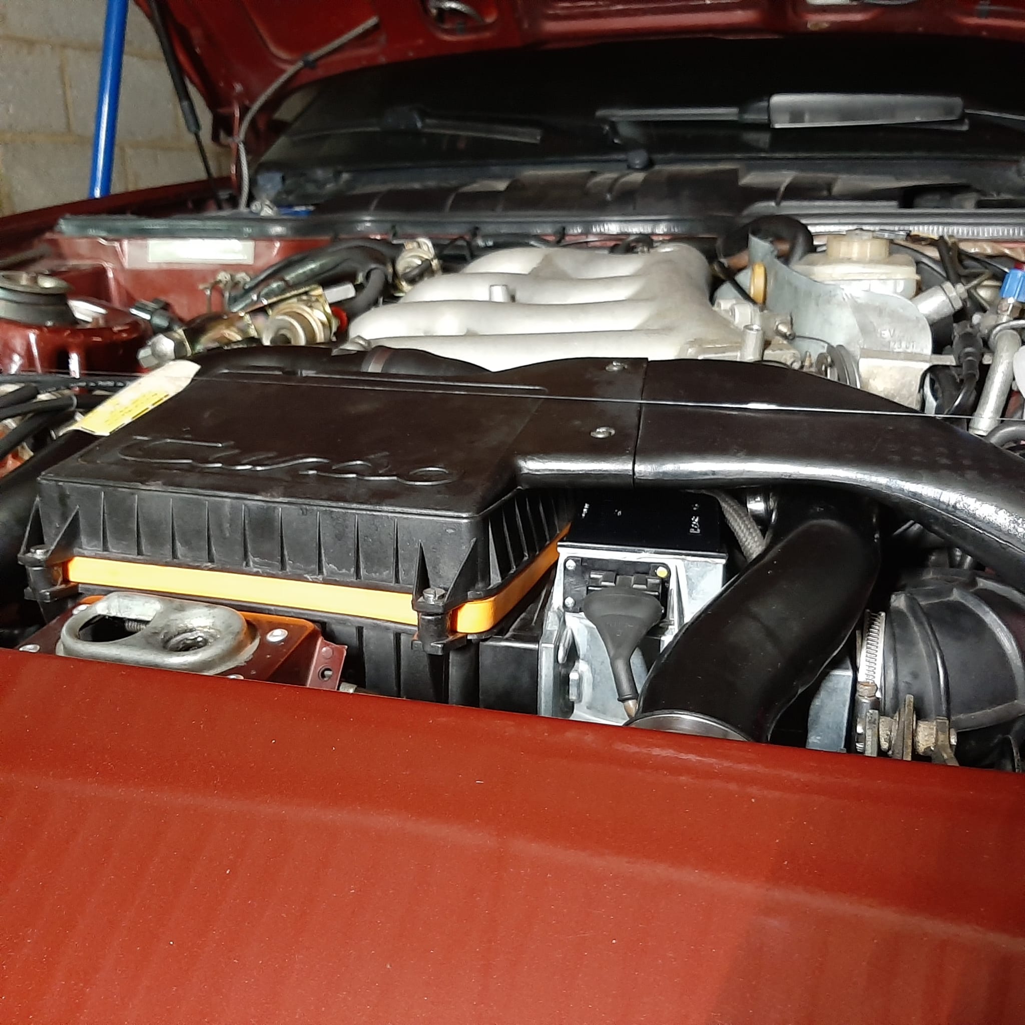

With full air filter box, filter and snorkel installed: doesn't close
WhatsApp Image 2024-03-10 at 11.39.20 (1).jpeg (246.19 KiB) Viewed 769 times
WhatsApp Image 2024-03-10 at 11.39.25.jpeg (373.93 KiB) Viewed 769 times
WhatsApp Image 2024-03-10 at 11.39.23.jpeg (377.64 KiB) Viewed 769 times

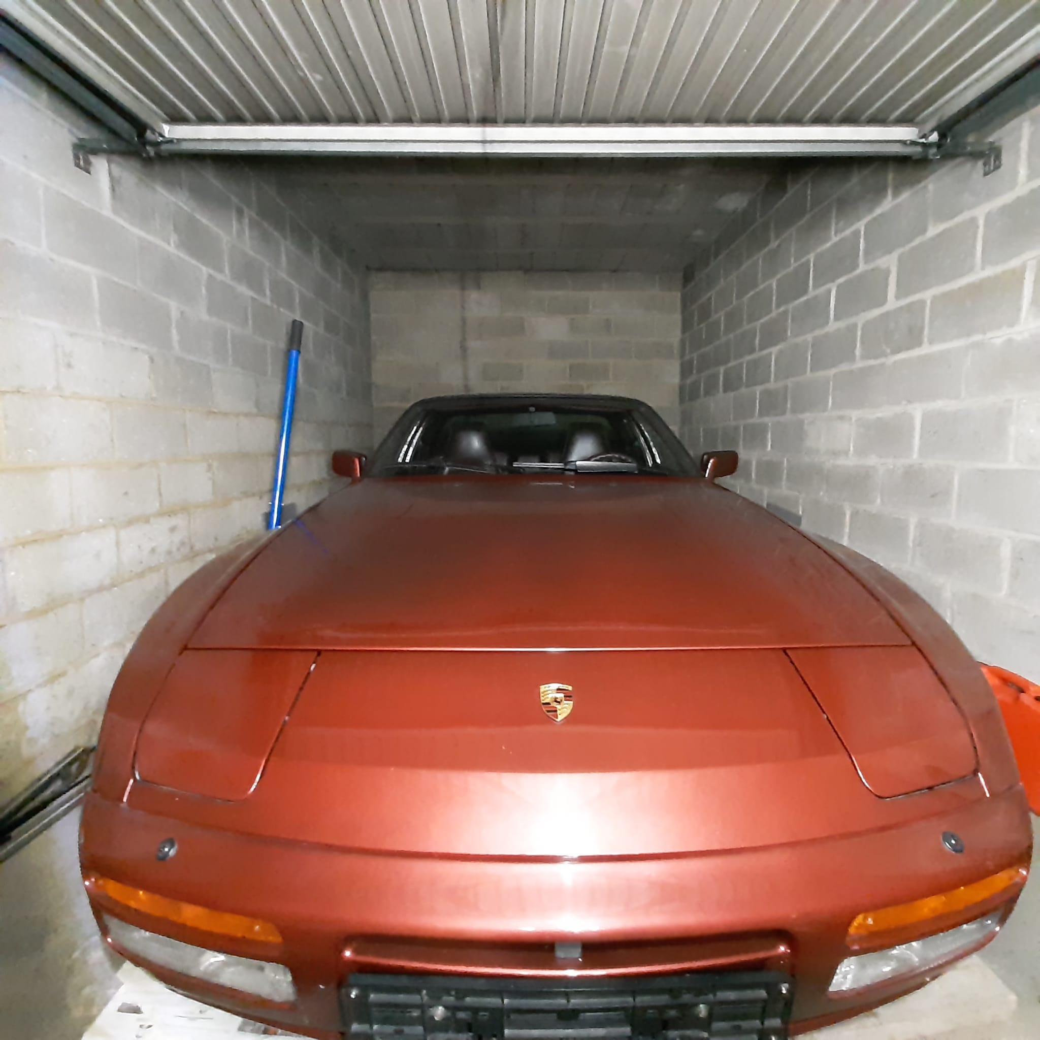

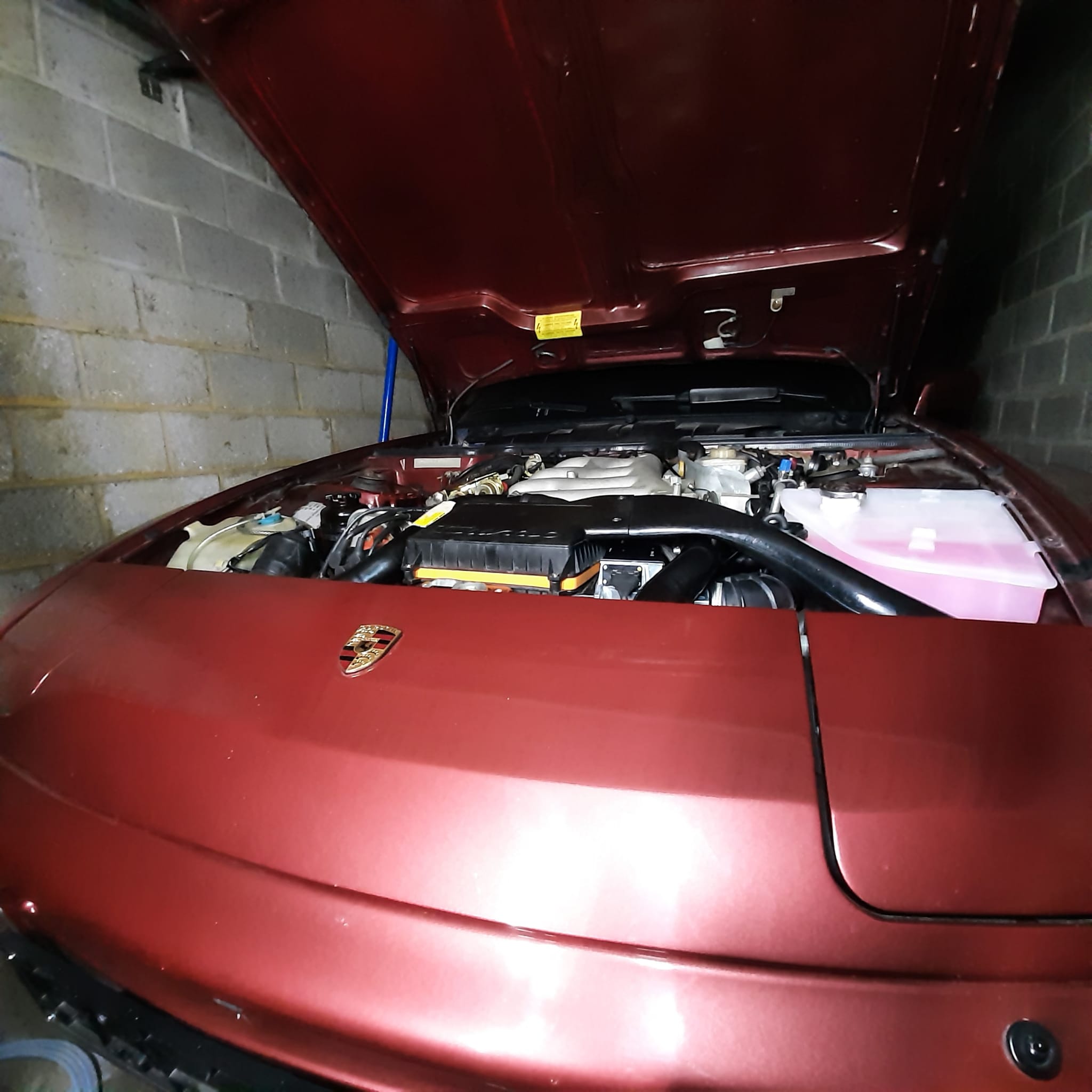

Succesful close after removal of top air filter box and air filter:
WhatsApp Image 2024-03-10 at 11.39.32.jpeg (344.84 KiB) Viewed 769 times

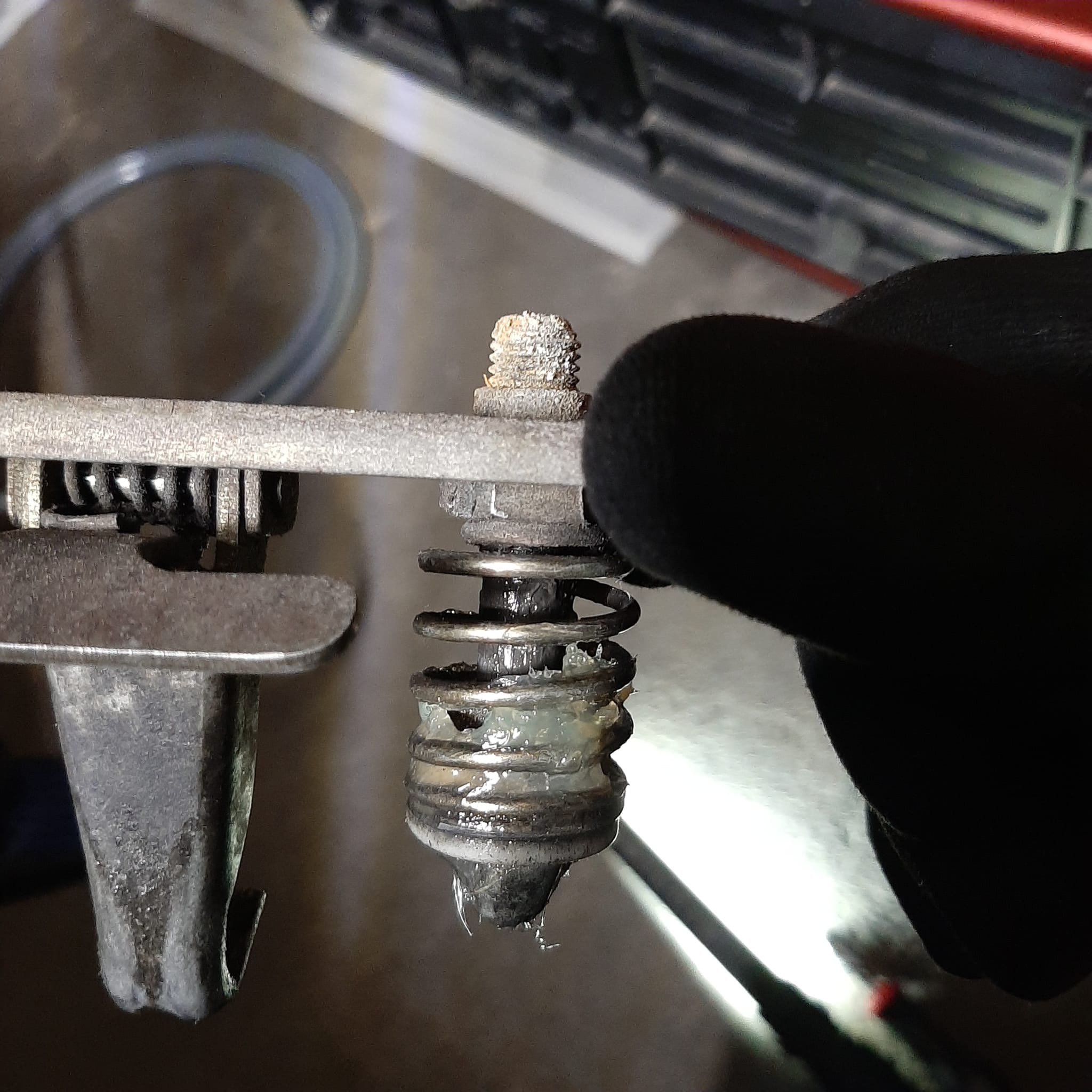

Hood cone pin (screwed in too much?)
WhatsApp Image 2024-03-12 at 11.16.26.jpeg (322.65 KiB) Viewed 733 times
WhatsApp Image 2024-03-12 at 11.16.27.jpeg (392.75 KiB) Viewed 733 times

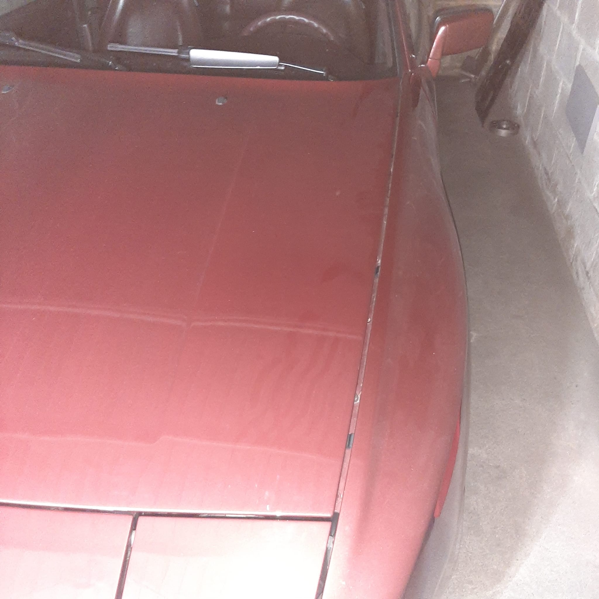

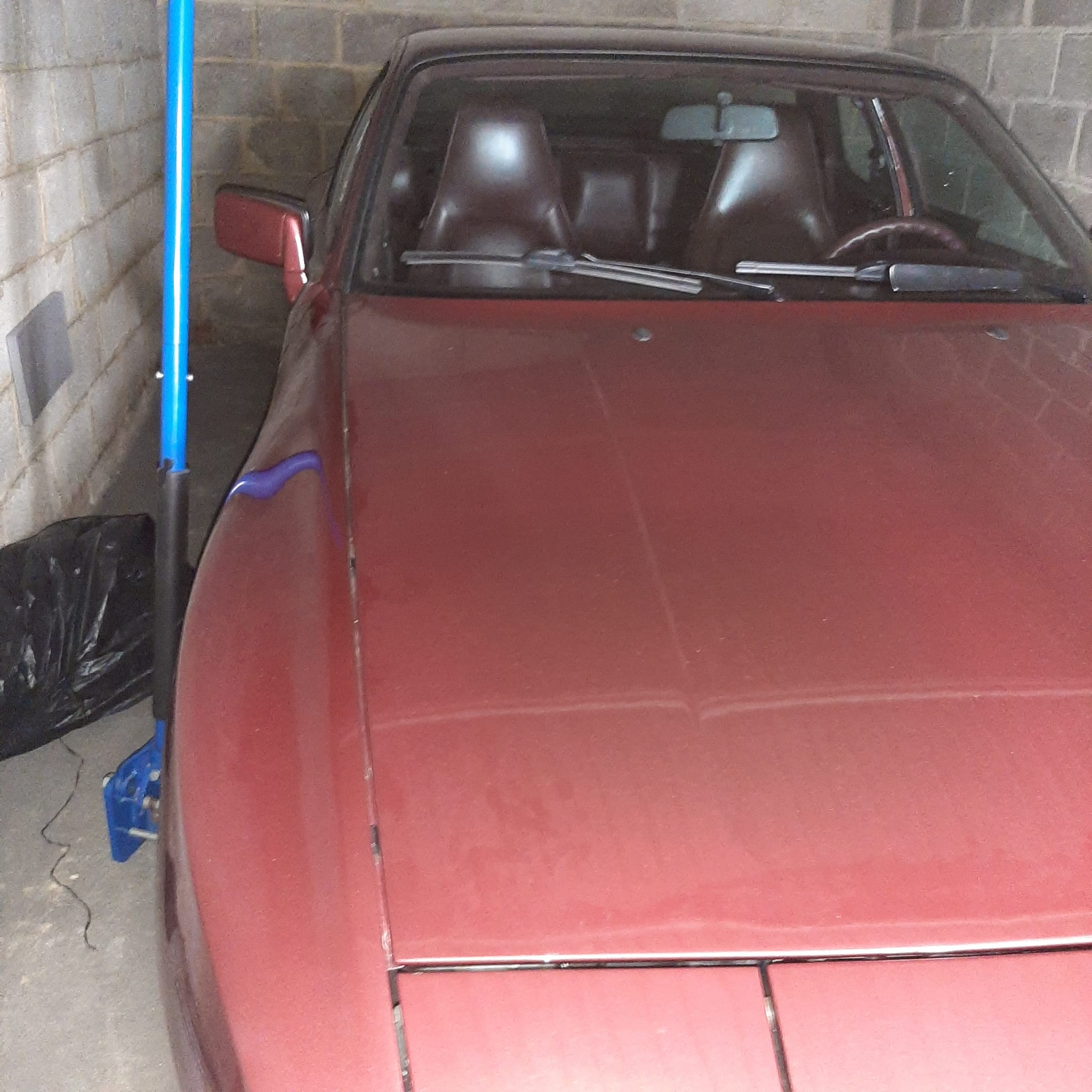

Update as of this morning:

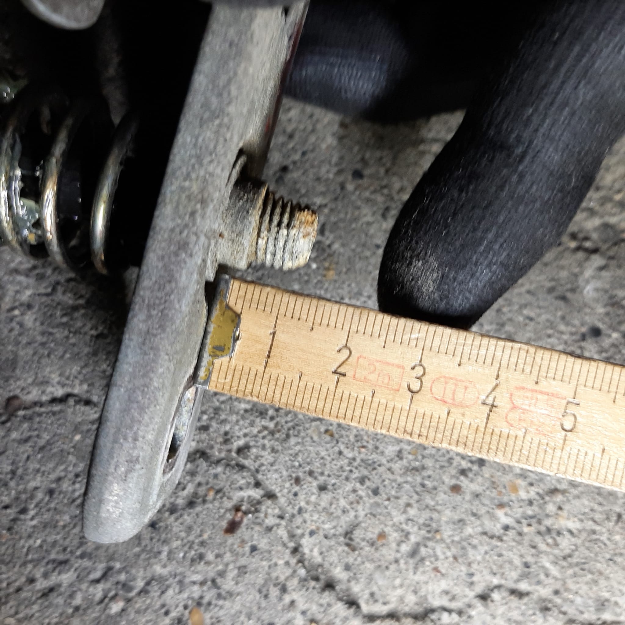

I solved my non-locking issue by adjusting the cone pin length of the upper latch! I screwed the cone out to +- 6 cm measured from tip to bracket and now it locks. I think I will still have to play a bit with it to see if I can get that latching when you drop the hood effect, which it won't do right now. I still have to push the hood a bit, but very lightly - very normally.
I did notice however that there's now a bit of a gap in the front of the hood and the front panel. I attached some pictures below. The hood is a bit raised in the front compared to the front panel. Any idea what the normal gap size should be?
The cone of locking wonder - loosen the lock nut above the cone with a 17 mm wrench and then grab a big flat screwdriver to screw out or in the cone itself - there's a slot in the actual pin of the cone at the bottom

The hood after adjusting the cone a bit more out
WhatsApp Image 2024-03-13 at 12.24.50 (3).jpeg (211 KiB) Viewed 698 times
WhatsApp Image 2024-03-13 at 12.24.50.jpeg (167.01 KiB) Viewed 698 times
WhatsApp Image 2024-03-13 at 12.24.50 (1).jpeg (151.59 KiB) Viewed 698 times
