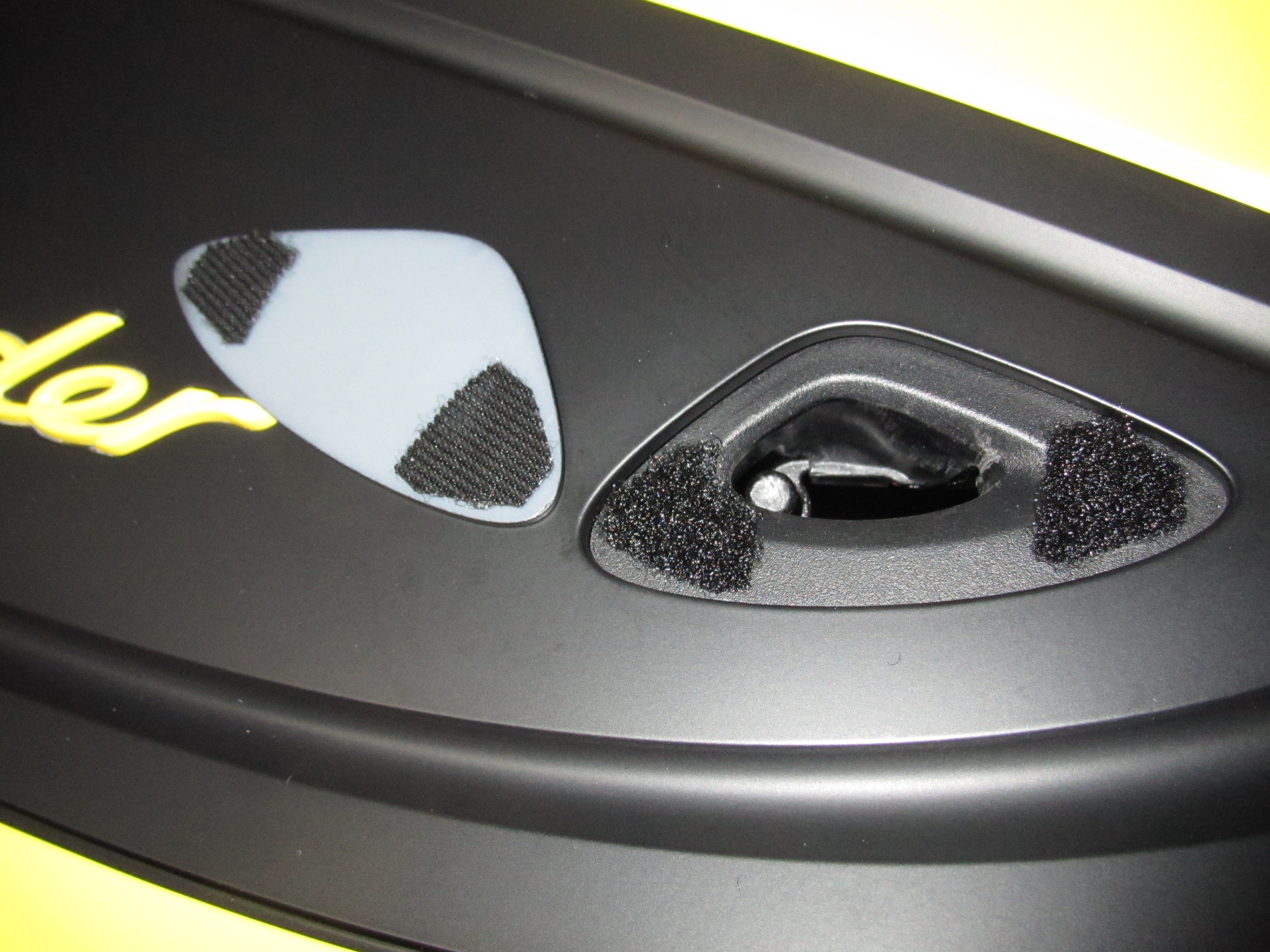

As a reminder to all, I tried several ways to attach these and this has been working well:
Plug left.JPG (2.04 MiB) Viewed 1444 times
Plug back.JPG (2.37 MiB) Viewed 1444 times

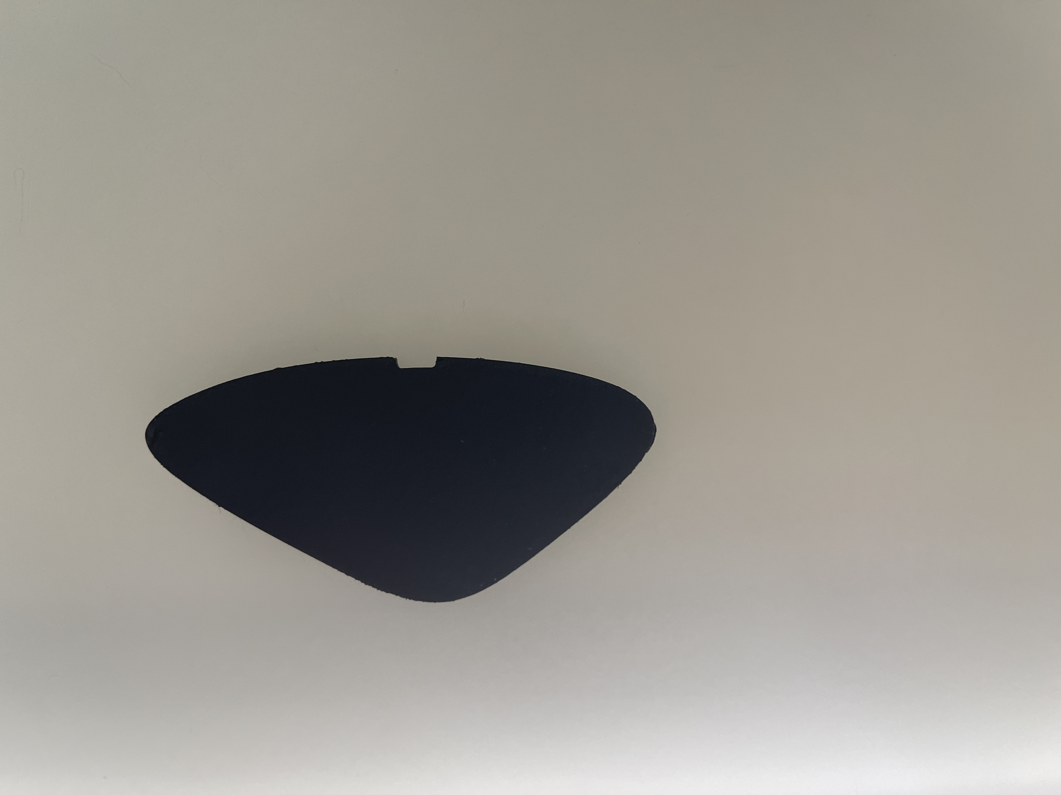

I got some of the original plastic inserts Tom sent me. And yes, mine warped and became unusable. Other than that, they fit perfectly. I already thought of the idea of anodized aluminum powder coated black to match the surrounding plastic. I had contacted Rennline several months ago with the idea of having them make them, since they already make quite a few custom Porsche parts. They expressed an interest in doing so. However they have been slow to respond. I dealt with Sam there, and after sending him one of my plastic pieces as a template, he sent me back a version he 3D printed that did not fit properly. Too large in a couple spots. He asked that I send him photos of the fit issue. I was a bit confused on his approach, since I sent him a part that fit perfectly.
Also, as a side note, I had taken a flat file and filed a slight notch in the plastic version to have a way to easily remove them. Especially if they were made out of aluminum which would have virtually no flex. That way a person could take a small flat screwdriver blade to initiate removal. In an ideal situation, it would be better if there was a plastic tool to do that, so that the metal screwdriver wouldn’t damage the surrounding plastic.
If a solution arises elsewhere, I’d be a buyer for at least 3-4 sets. In the meantime I’ll stay in contact with Rennline, and hope they can come up with a properly designed and fitting solution.

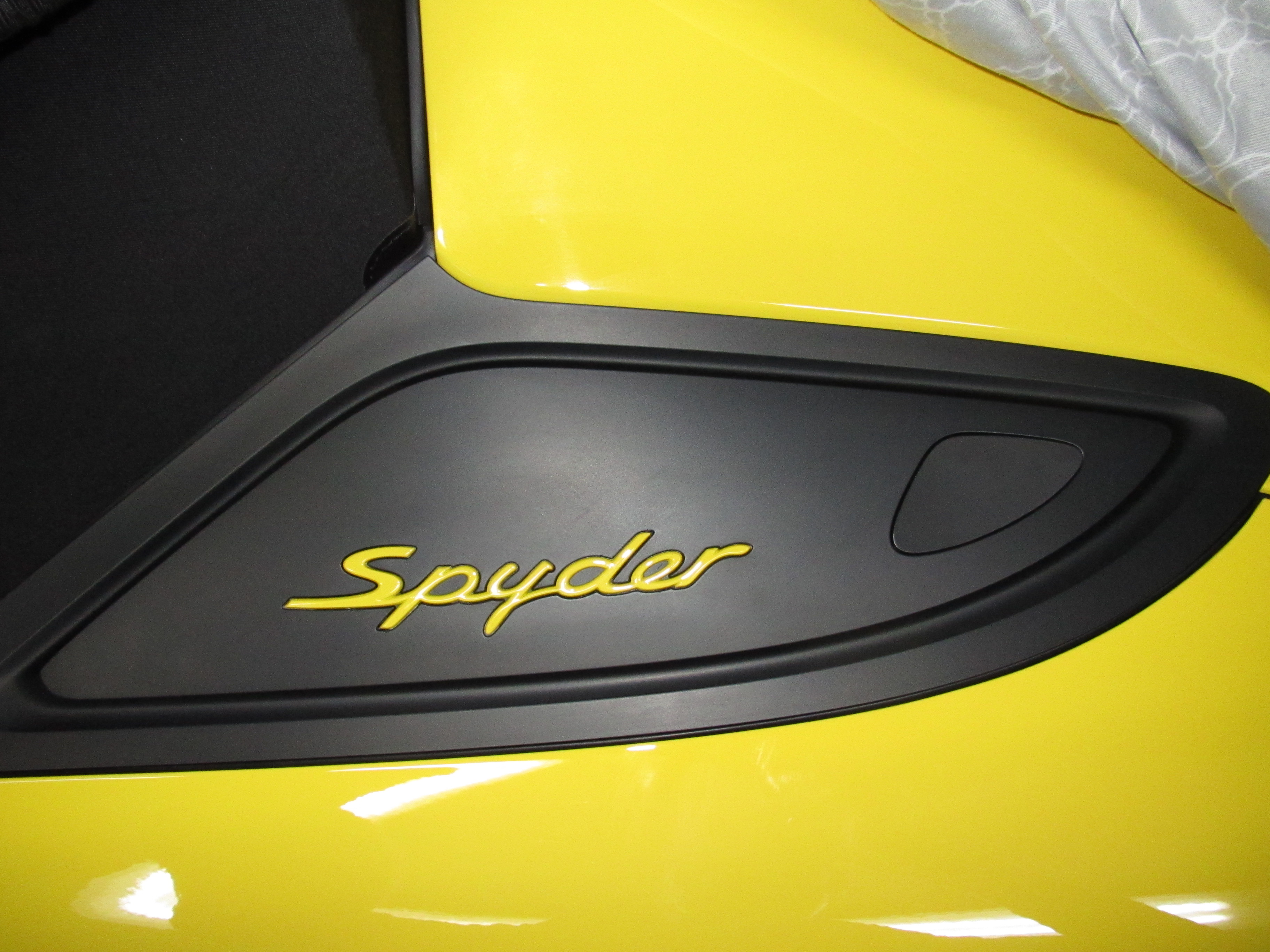

Photo of notch:
