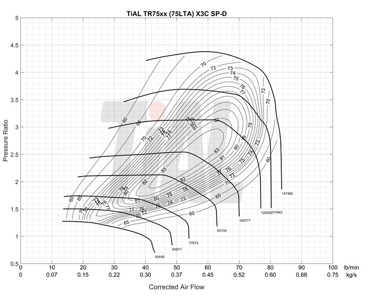

SirLapsalot wrote: Thu Mar 06, 2025 9:59 amWhat do you guys think about the G30-660 with 0.83 A/R for an 8V 3.0L running 1-1.3 bar of boost?
That sounds like a recipe for massive mid range through minimal torque lag and should flow just enough for whatever an 8V head with the 9R cam can offer with the stock inlet and IC. You don't mention the exhaust but I'm sure you will use nothing smaller than 3".

he is a map for the Tial set up i use for 3.0 street
figuring a 1.5 bar of boost at 6500prm you will be in the 83% efficiency range.
At 1 bar, 3500 you are down to 82% efficiency.
So its got you covered at both ends of the performance range.
Screenshot 2025-03-07 100900.jpg (105.54 KiB) Viewed 5331 times

That’s a really efficient compressor map.
First I have seen in the 80%.
I may just have to add one from you to one of my builds.
That of course will have to go with your cam time machine piece you made and I will guess a Link of some configuration.
Still going to do a twin scroll but that the plus side of having so many engine blocks now.
chris white wrote: Fri Mar 07, 2025 7:14 am he is a map for the Tial set up i use for 3.0 street

gruhsy wrote: Fri Mar 07, 2025 8:53 am That’s a really efficient compressor map.
it is impressive, teamed up with a stainless center section with replaceable mounting base and the great Tial SS hotside I think its a winner.
