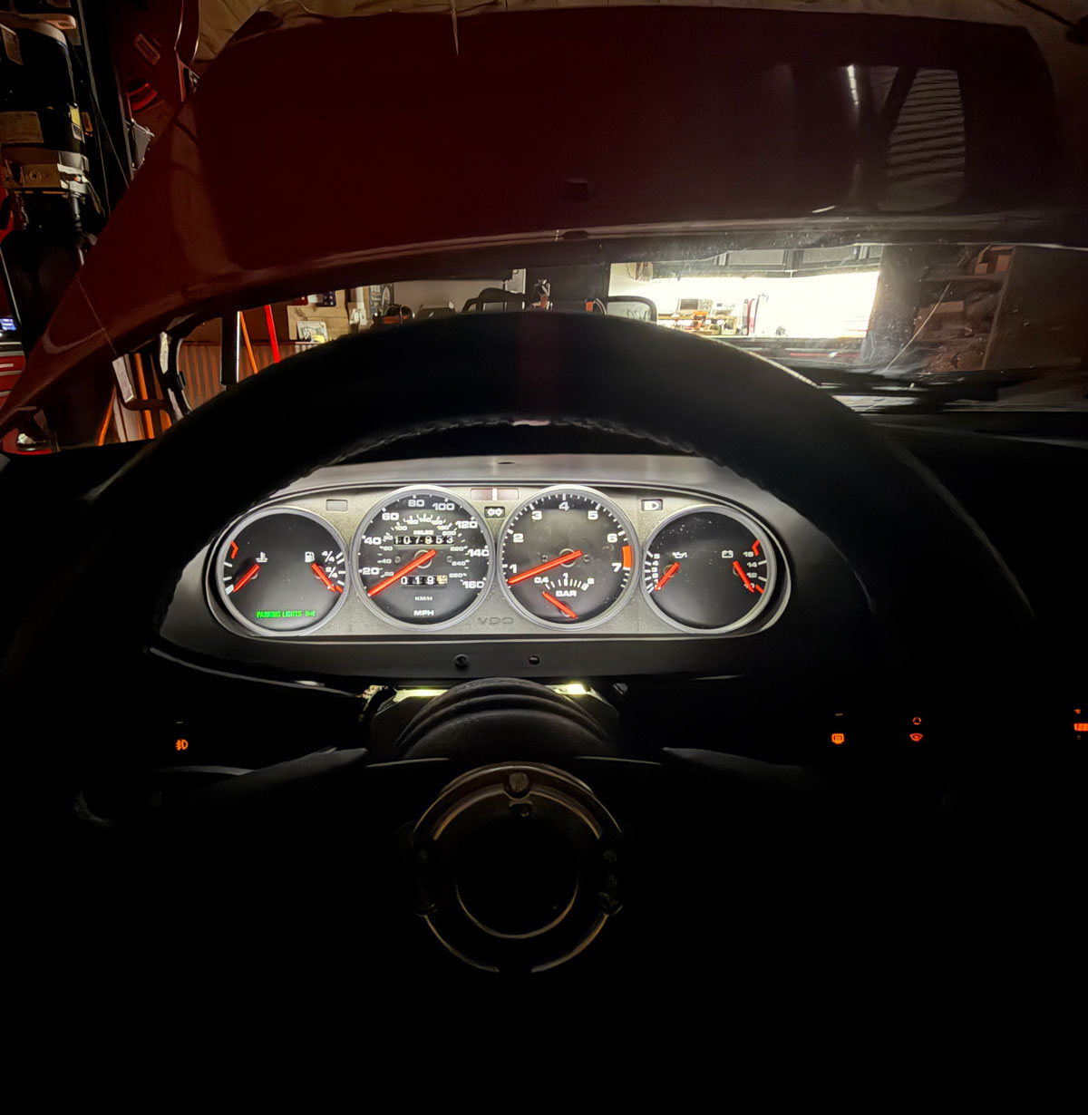

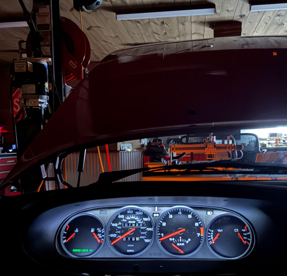

Just a public update on these kits. I have been working on updating the LED lighting for the last few months after someone pointed out a few esthetics issues worth addressing. As is my way, that resulted in quite the quest to get the light just right. It was already my favorite part of the kit, but the new design is even better IMO.
The update now has lighting from both above and below, with the lower lights now essentially replicating the factory parts (just much brighter). But enhancing the lower light alone left me with kind of an up-lit Halloween effect on the gauges -- so I added a second strip of light across the top and think it's the perfect touch. Still fully adjustable, from too dim to too bright. :) The net result is incremental improvement all around I think.
Still waiting on the updated PCB's, but once those are available in the next few weeks, I'll resume shipping kits and make the new lighting available as an upgrade to the existing kits for those interested. A very sincere thanks to people who ordered the kit and have been waiting on this -- your patience has been incredible!
