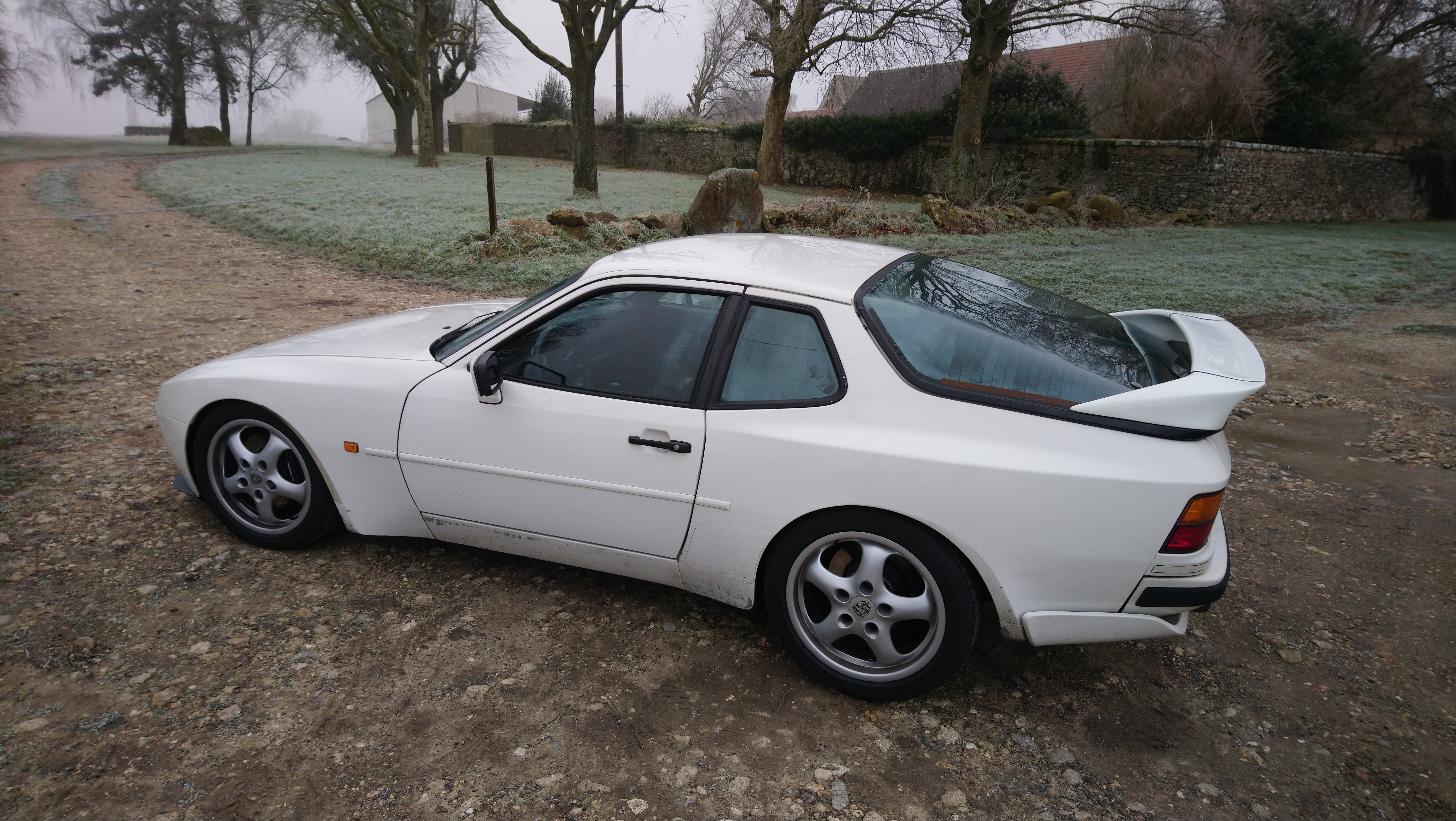

First drive of the year for the all weather warrior. I forgot the laptop and didn't do any datalogging but the engine loves such cold weather.

by 333pg333
The combination of very high power and lack of traction is compelling!!
