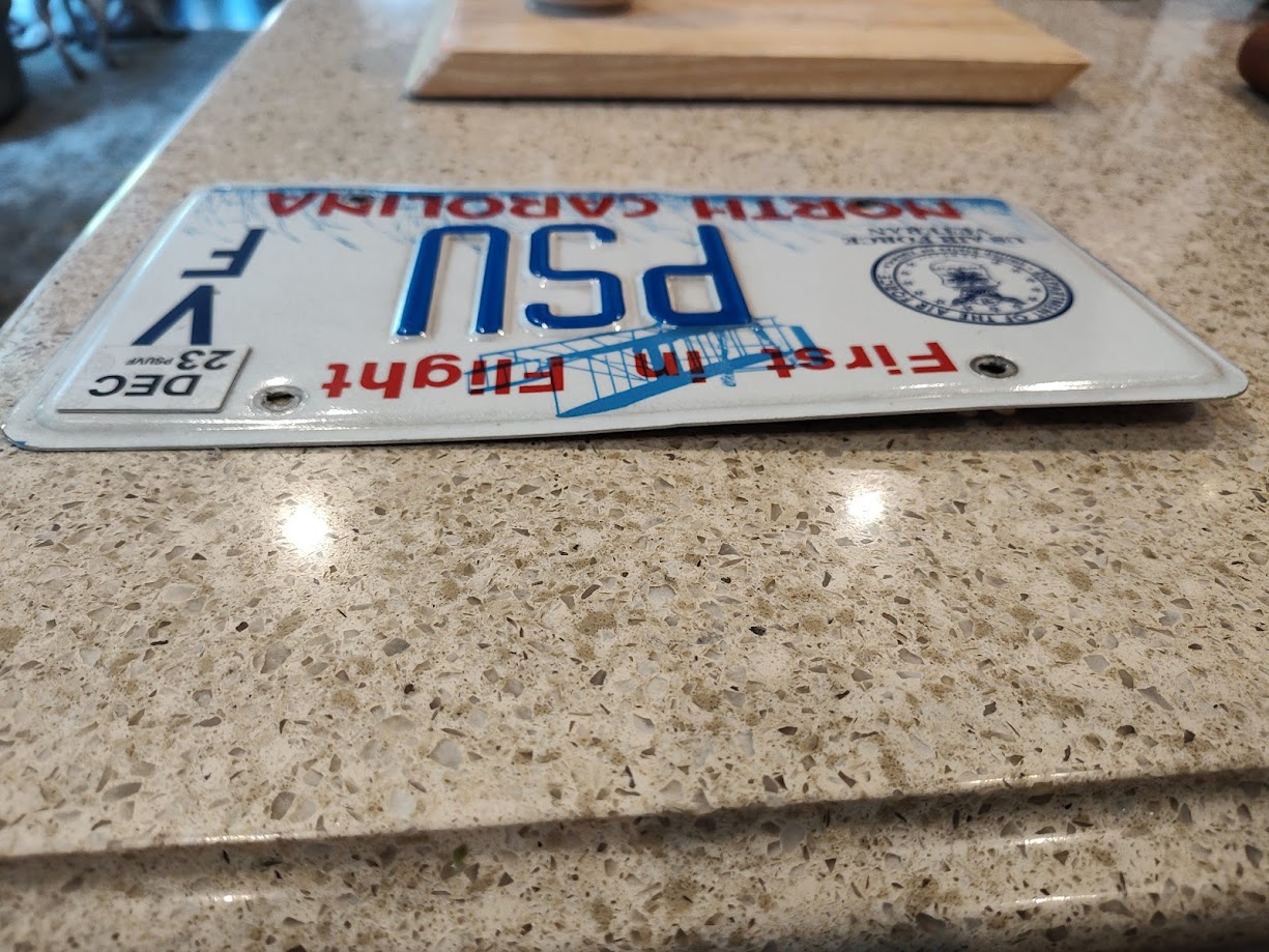

Thanks for clarifying that Mike! I ran out and snapped a picture of a twisted plate and was going to suggest you check yours on a table for flatness. I've had a few people report the mounts coming loose over the years and I think in every single case it is because the plate isn't flat. You can see in the picture how the plate warps up in one or two corners, which creates a constant pull on that mount. The tape is interesting. If you try to pull it off all at once, it will practically pull the bumper off before coming loose. If the plate pulls on it gently for months, combined with the vibrations of driving, it will eventually pull apart.
I'd say use heat on it, but enough heat to break down the metal memory would burn the painted side I assume. Hammering strategically can break the metal memory, but that's a skill metal workers spend years mastering. I'd sit at the kitchen table and keep twisting and bending until all 4 corners sit flat. The problem with giving up is that the same twist/pull will now be working to strip the holes you drill. What would happen if you turned yours in as damaged or lost it outright and asked for a replacement? Any change you have a flat front plate you could repurpose to the rear?

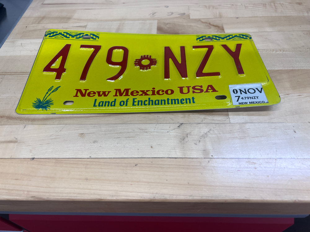

That's bizarre that NC plates are so twisted but it's probably not all that uncommon elsewhere too. I've certainly seen twisted plates.
I've had no issues with mine and one of my cars (GT4) is on track a lot where it not only gets jostled considerably but also where I remove the plate every event so that I can install the rear tow eye. But, my current plates are good and flat - no twists.
A few wild ideas here -
If the twist is of the nature that only one corner is lifting, might try to leave the M6 bolt off that corner. However, if that's how it's sitting, it still seems that the best option in that case is to add enough nylon washers to fill the void. However, that would be tough if there are two corners not sitting correctly.
Another idea is to ask the state to issue you a replacement plate. Hopefully it wouldn't be warped.
Maybe there's a shop that has a metal forming roller that would help, although it might ruin the plate. (That would get you back to the previous option of getting a replacement plate.)

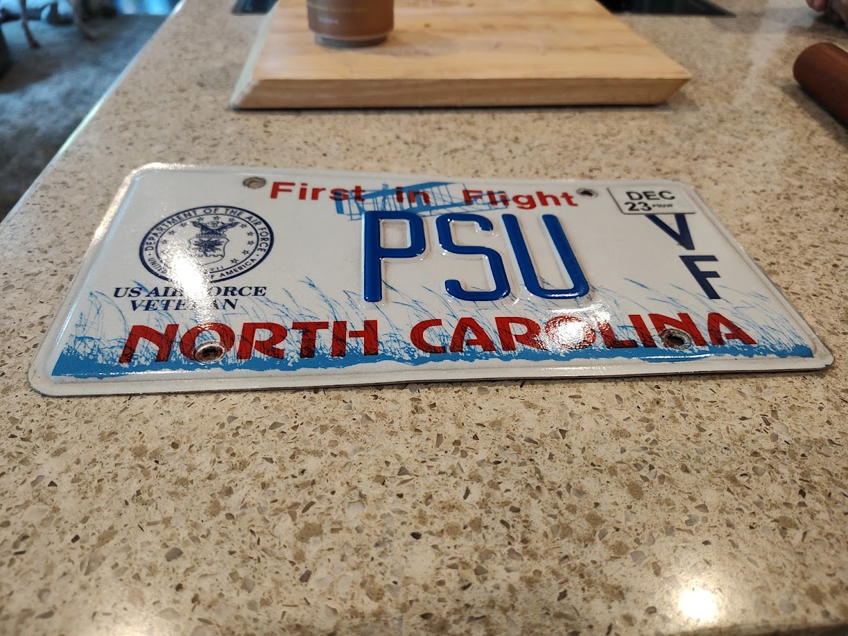

It is no way as warped as that plate and almost sits flat on the table. However, one corner comes up immediately as in 20 minutes after I apply it.
It is a custom plate with both AF Veteran and a vanity plate. I have used it for years with two Porsches and one Alfa with no issues (however screwed in). I have not found a way of replacing my actual plate on line but maybe I should try again.

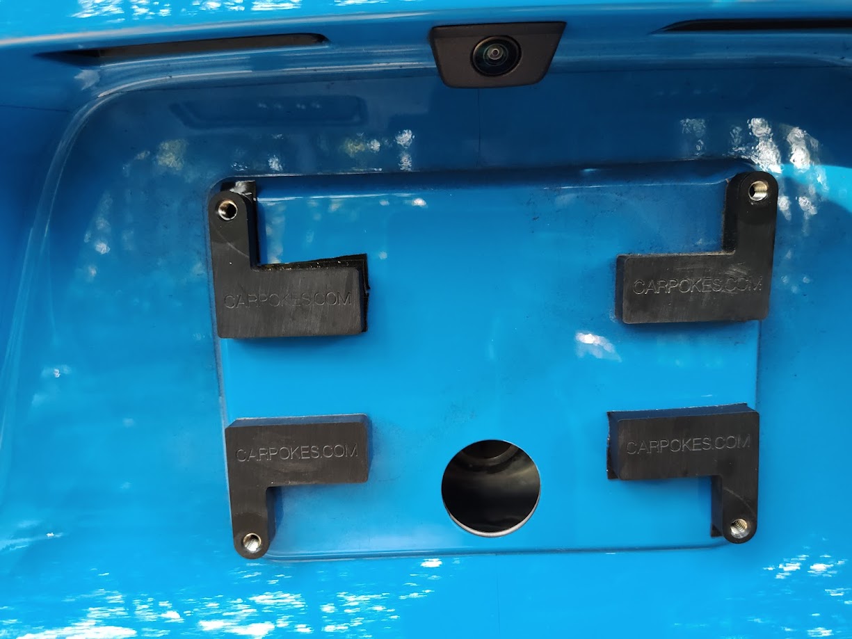

So, I went and pulled the plate off. It does seem like the upper corner is finally sticking although the lower right feels a little loose. Maybe putting 3M tape on 15 times removes ceramic coating?

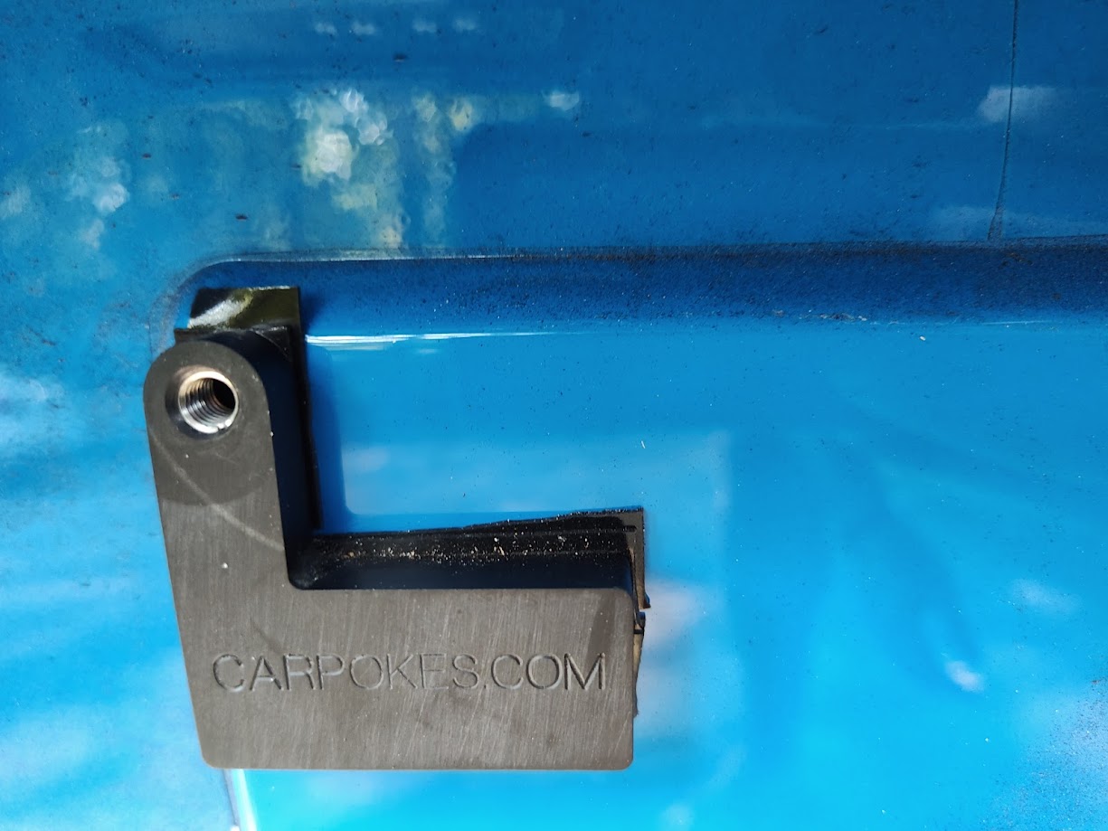

Here you can see where I doubled up the tape to try to help alleviate the stress since the washer trick didn't work and I figured that was adding more weight to the plate. I know my taping is sloppy, it was neater before but I got tired.

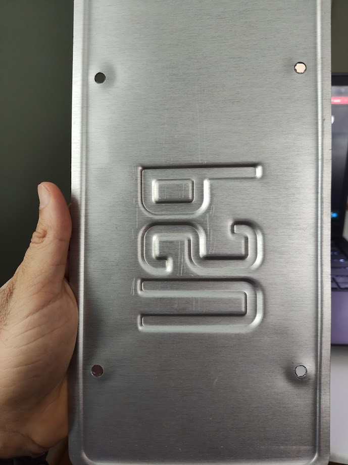

Here is my plate. Try as I might, the upper left and lower right corners will twist opposite of each other. I'm thinking that maybe the fact that it only has three letters may have made the stamping pressure uneven and caused the plate to twist the way it did.
Either way, if the corner is sticking, I'm not going to pull it off to polish so I will wait to see if it comes off.
