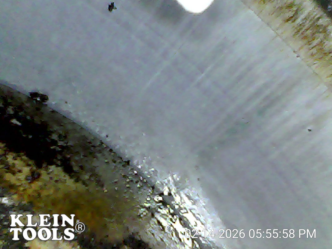

Well I took a look into my cylinders to find this
That streak down the cylinder wall is coolant puddling on top of the piston, there’s my smoking gun.

Poorsche44 wrote: Sat Feb 14, 2026 8:21 pm Well I took a look into my cylinders to find this8647468375765905512.jpeg
Well, shoot. At least now you know. :(
