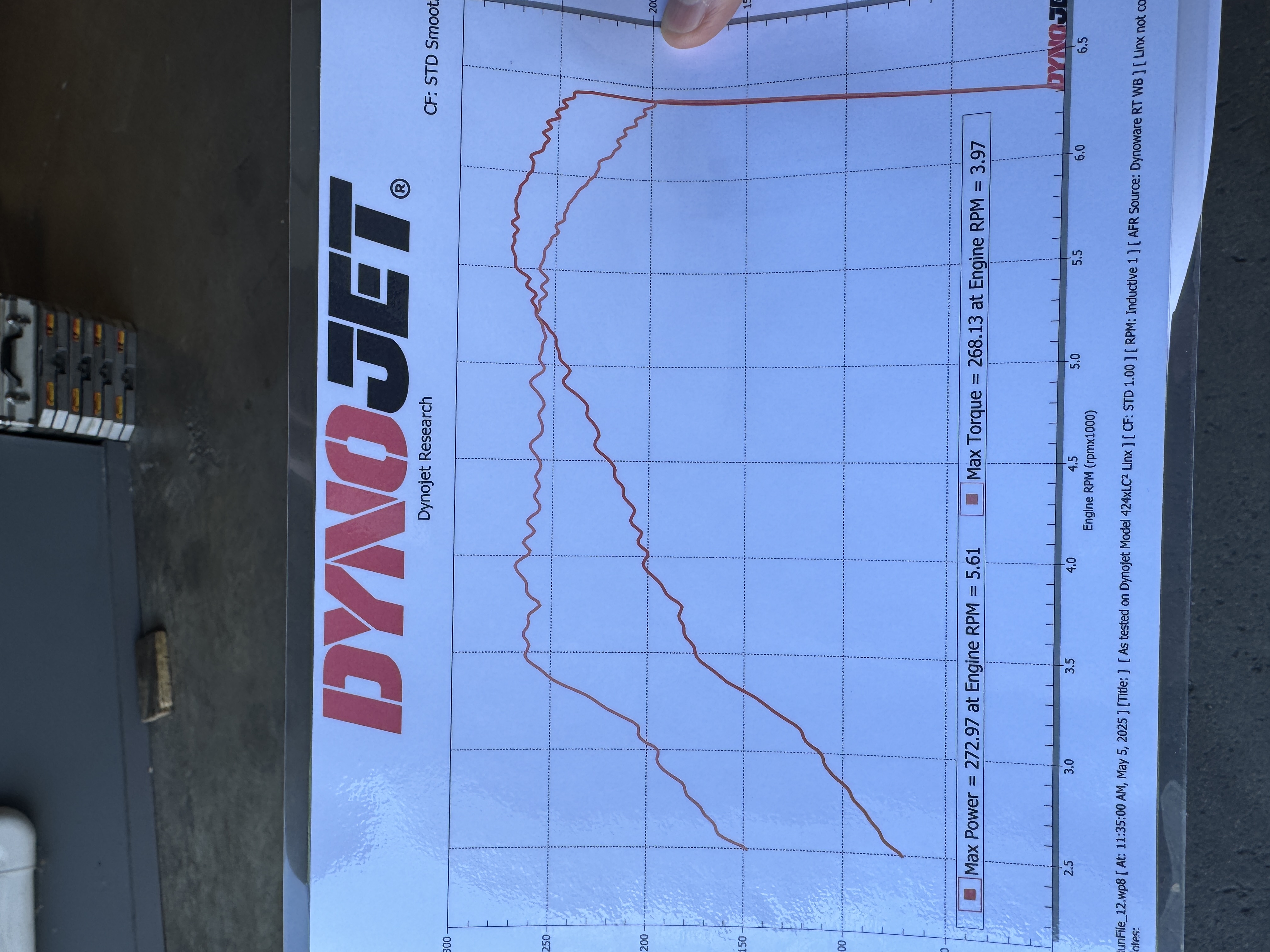

Sorry for being absent from my own thread, and your posts:) So here is the update on my build. It has been a Hell of a ride and, knowing what I know now, I would have just built a new motor and had a new harness made from Bas, or now from Kroon, for my MaxxECU Race.
To recap:
I got a little ambitious with my stock motor that has almost 150K miles. I thought a little more power with some bolt ons would be a simple affair and I'd enjoy the small boost in performance while I get a new motor built. I also thought I'd take the time to do some A/B testing between a set of chips and MaXXECU to help add some evidence to the argument, pro or con, for whatever it would be worth. First step in that brilliant idea was to get a new OEM style harness from Kroon. Great guys to deal with, fast turn around on a fresh order and it is a great product. I highly recommend these guys. This would allow me to use my Focus 9 Tech DME with OBD and some new chips. I decided to try a set from John Behe, the old racer in Maryland. I forgot how I learned of him but he would work with me to get the right tune if his original set didn't make me happy. He said once I had a dyno sheet for him he'd be able to dial it in with the second chip. Then, I'd simply use the harness and MaxxECU from Drivestore.se and do an A/B comparison.
My build. I ordered the RaptorX from Charlie and had a shop on Ebay I bought a used K26 from ship it directly to him. I had my new RaptorX in two weeks. I ordered the full 3" Fabspeed setup with 200 cel Sport cat as well as a 3" downpipe. Got the Tial F38 and adapter plate, and from Tim at SFR I ordered the Stage 2 4 into 1 header, which is a piece of art, Stage 1.5 intercooler which is as well very nicely made, accompanying intercooler pipes and intake. I wrapped the headers (will NEVER do that again) in DEI header wrap. I also ordered the crank mount 36-1 trigger wheel from 928-944parts.com where they pre-weld the trigger wheel onto a pulley wheel for you. Outstanding! Got a new front timing chain cover setup, the Nissan alternator mod, Lindsey Racing 3X oil cooler kit (this thing is awesome!) and every sensor in the engine bay was replaced as well. When it came time to install the new headers, it was discovered that one of the manifold bolts had to be retapped into the head by a previous owner and they went in at the wrong angle, hit a water passage, and simply patched it with silicon. Worked pretty damned good apparently since I had no problems for the two years (up to then) that I owned the car and it survived the initial 12 hour drive home when I bought it. Got a new refurbished head from Tim at SFR and that was that. So many little problems here and there getting it together that I can't begin to document it all. The problems came to a head a few weeks ago when I had the car home, after what I thought was the last time it would be at the shop for this build, and I was prepping to drive to Southern Cal for a Porsche Rally. The night before the event, I washed my car and was going for a quick spin to dry it off when i noticed smoke coming out of the engine bay. Fire. Oil had leaked badly from the cam cover and onto my header wrap. Luckily I had my extinguisher and put it out before any damage was done. Back to the shop.
F my life.
Technician error from not torquing down one of the bolts, like at all, because the damn thing was missing! Needless to say it was dismantled and put back together at no charge along with some new coolant hoses. I love my shop and they've become like a second family to me (I was there every other day for eight months) but from now on, only the owner is touching my car, no underlings.
The outcome?
The chips from John Behe were trash. The car wouldn't even start up. In fact, the stock chips fired the car up just fine. With some spotty communication from John, I decided to ditch the idea of A/B testing since I didn't want to wait two weeks in between chip testing, not to mention dyno time in British Columbia costs entirely too much money. I told John I was ditching his chips and what I thought and he didn't even bother replying, much less offering anything resembling even a partial refund.
Enter MaxxECU and the harness. It wasn't church bells and rose petals getting the thing to run right. The base tunes from Drivestore got the car running but the 300hp tune was trash. We had to play with it a lot to get it running. I then used some guy recommended to me by a 944 specialist who is based in the mid-west somewhere and does remote tuning. He was way too arrogant and kept trying to push my turbo to 17psi after I told him three times I wanted a conservative tune since my bottom end was old and unopened with a lot of miles. He got it to open up a bit more but he had the timing dangerously advanced and it was clear to me he had no idea what he was doing with my car. Connection severed. More money wasted. My mechanic and I dialled it back down to something safer. Drivestore guys were a mixed bag. Erik was cool, very patient with me, and understanding and helpful. I like him. His partner Thor is a dick. Impatient and even insulting. He made some derogatory comments to me when I was trying to grasp what he was trying to explain which he then deleted in our Whatsapp conversation quickly thereafter. I gave up dealing with them altogether. A few weeks ago I finally got some dyno time. Again, the goal was more power but conservative. My mechanic and I decided to go no higher than 13 psi just to make it fun and keep it safe. We wound up at 14psi.
Yes, it is not a lot of power given the mods I have. We could go to 17 to 18 psi and the car would be transformed but it might also grenade on me. Everything that can be bolted on to make more power has been bolted on. Every sensor, new harness, etc. etc. It all started out with just wanting "some" parts bolted on but it seemed like every new part bolted on revealed something else that needed to be done, be it a modification to make the new part fit (SFR crossover, meets Tial F38, meets Fabspeed Sport Cat = custom welding job) or replacing something I didn't plan on replacing because it was literally broken (cylinder head) and everything that goes along with it. The motor isn't in top shape with some cylinder scoring. Here are the numbers before it was in the shop for the bolt ons.

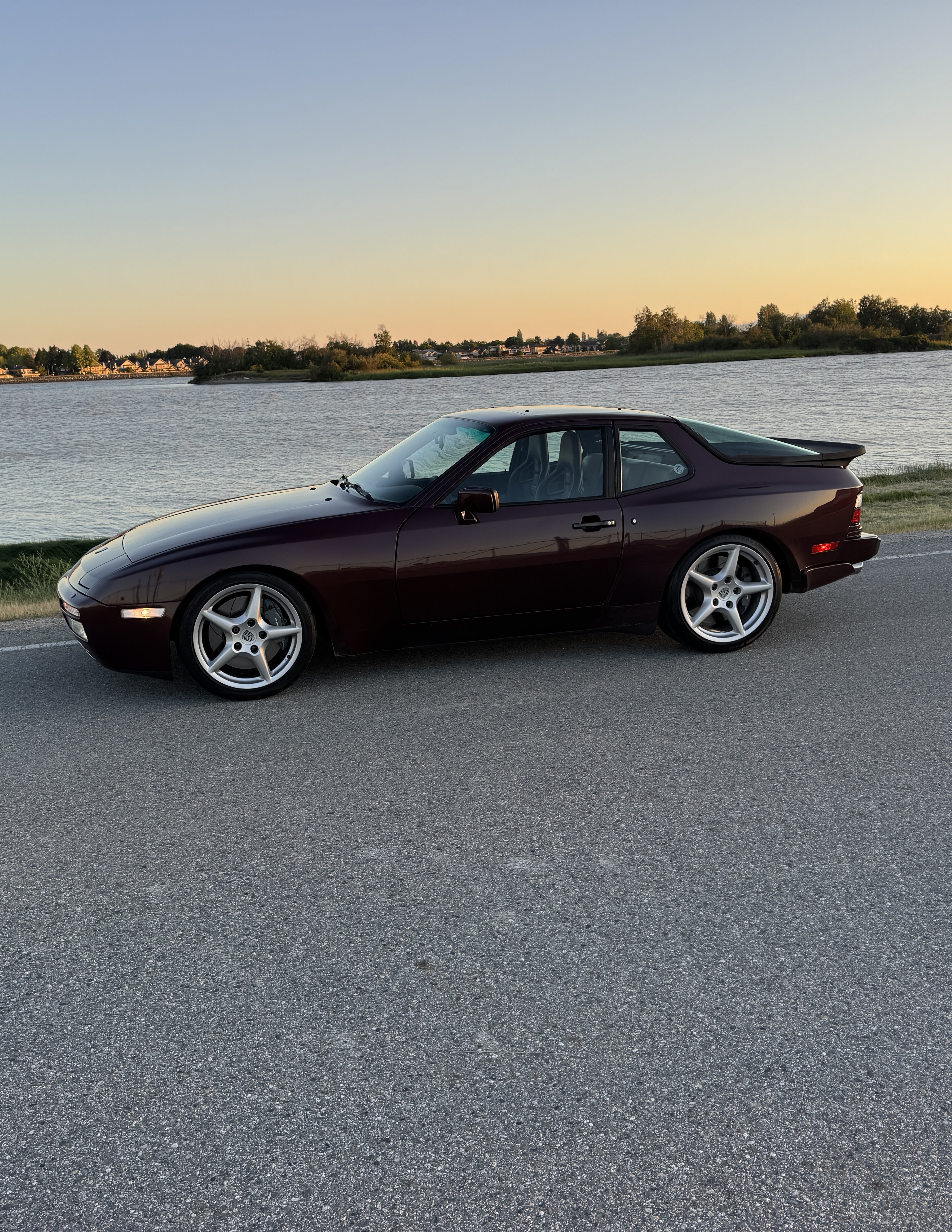

Meanwhile, such a great-looking car! Good pics too. :thumbup:
