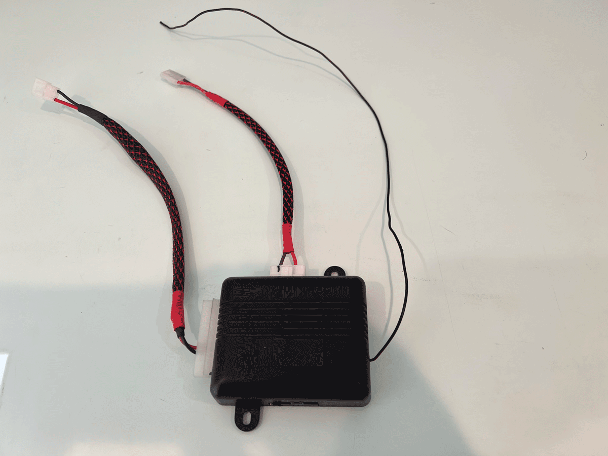

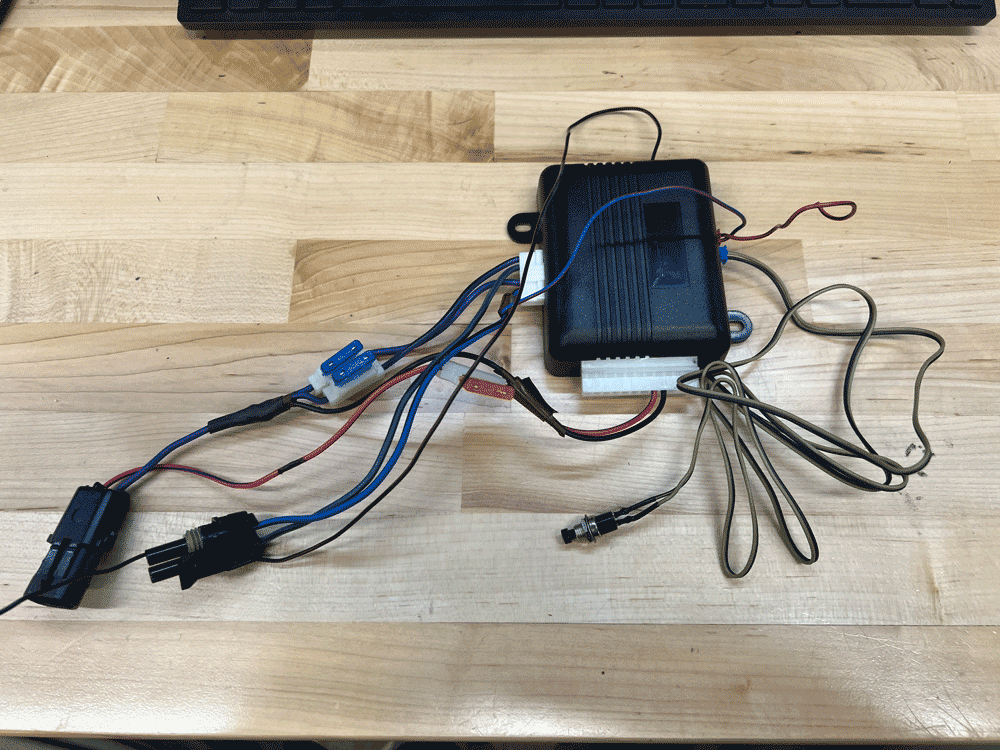

Before:
After:
Re: Under dash "while you're in there" jobs....
Posted: Tue Feb 15, 2022 9:19 am
by audi4t
Very professional !!!!
Posted: Tue Feb 15, 2022 11:39 am
Thanks. I just wanted to get rid of the rat's nest, but may have gotten carried away. ;)
