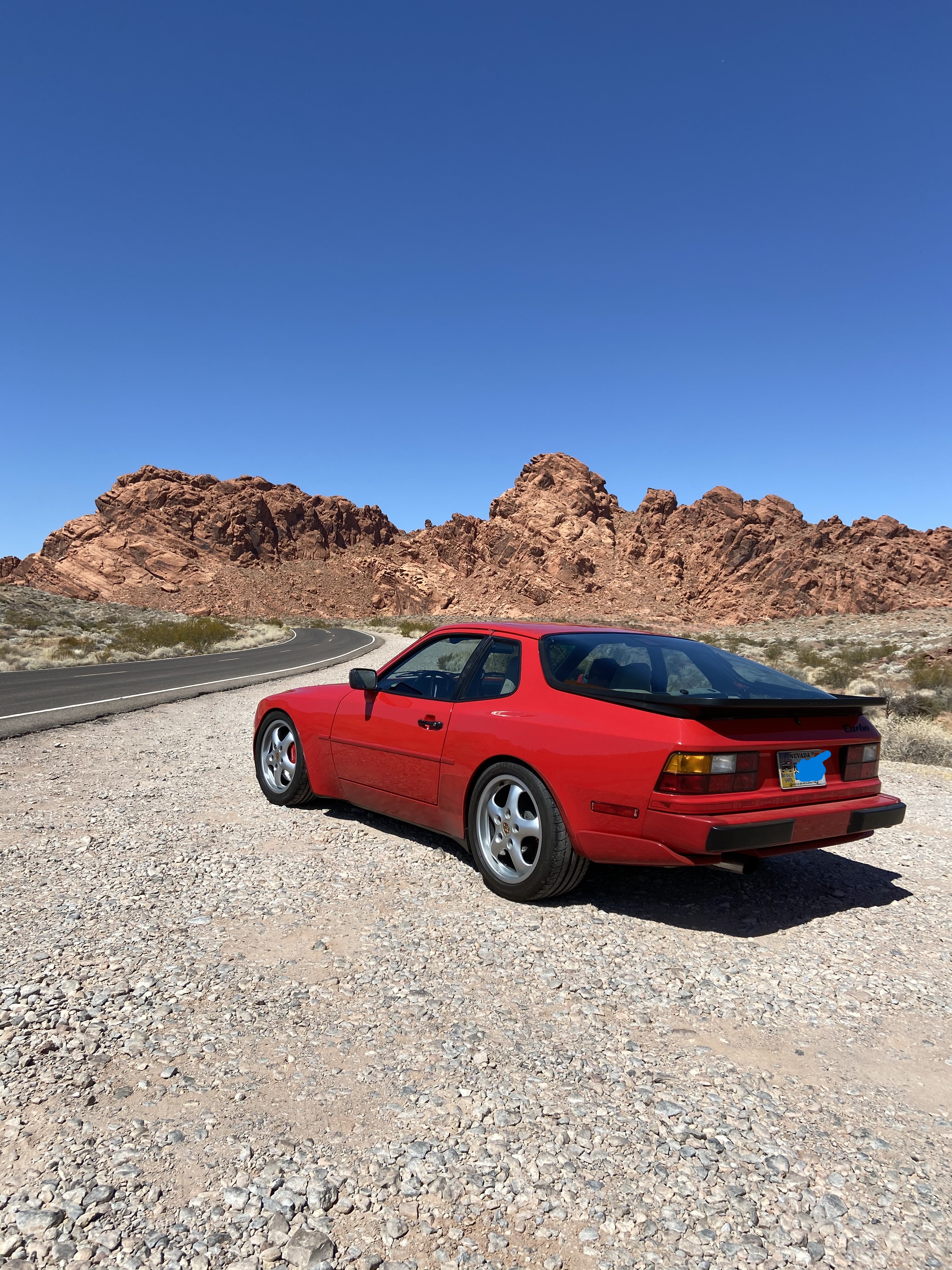

And finally...on the road
951 - Valley of Fire, SEPT 2022 v2.jpg (3.31 MiB) Viewed 428 times

Nice - that's what counts!! :thumbup:

Good job and nice-looking car. Love the Cup 2s, though I'm biased.
