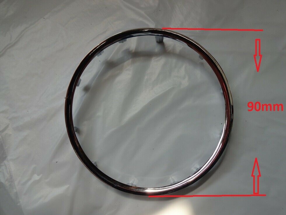

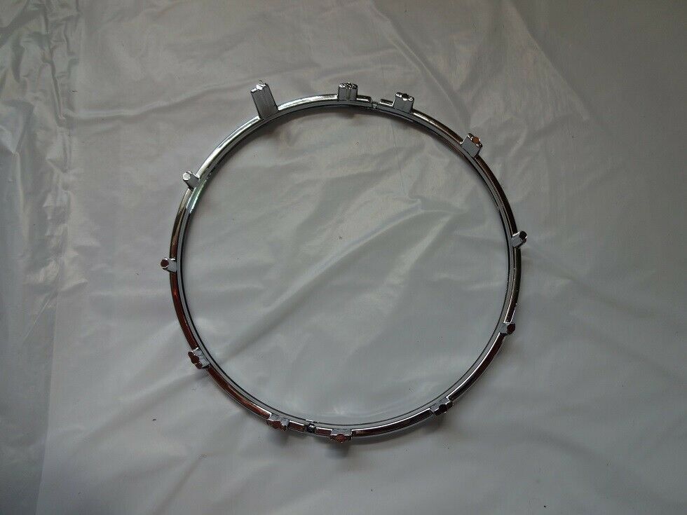

They are the same on all P-cars. The ring ends are melted on that back side so as said above it will not be reusable when removed. The replacement is not the same material as it is rigid plastic but identical otherwise so when painted it looks 100% stock. Personally, I used a dental tool to get under it and then started pulling until I get a pair of needlenose on it and then it is just a matter of pulling it out as you move around the ring.
trim ring front.jpg (63.89 KiB) Viewed 2778 times
Trim ring back.jpg (59.58 KiB) Viewed 2778 times
