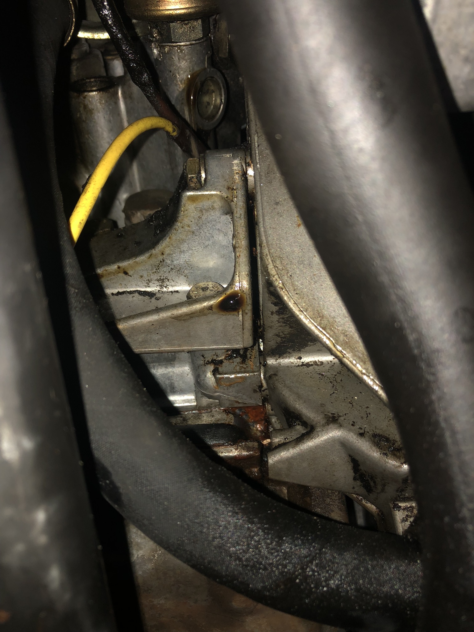

I am however seeing lots of oil. Not unexpected after so long sitting. Seeing oil drops forming at the rear of the oil pan on the passenger side, and on the power steering bracket, below the oil filter housing. I’m unable to find the source however, just the low spots where the drips form.
Has anyone seen similar leakage and where would you recommend I start?
Thanks,
Scott
Re: New member with stupid project!
Posted: Thu Aug 29, 2024 2:20 pm
by Black944 turbo
Could be coming from many places, front seals, cam tower, etc…. I would suggest cleaning it up and see if you can track at after a quick drive.
Posted: Thu Aug 29, 2024 5:14 pm
by Swaggoner
Did that and drove a much slower speeds so to not blow the oil around. It mostly seems to be on the front side of the engine. Cam tower and filter housing looks dry, I’m thinking all the balance shaft seals, and all those other things I should have addressed when I replaced the belts and water pump!!!
Well, If you want to get good at doing a job, do it twice...
Posted: Fri Aug 30, 2024 6:21 am
by Cruise98
There is a cork gasket on the back of the cam tower that will leak onto the crossover pipe. It is a tight space to work in, but you can change it without removing the cam tower.
