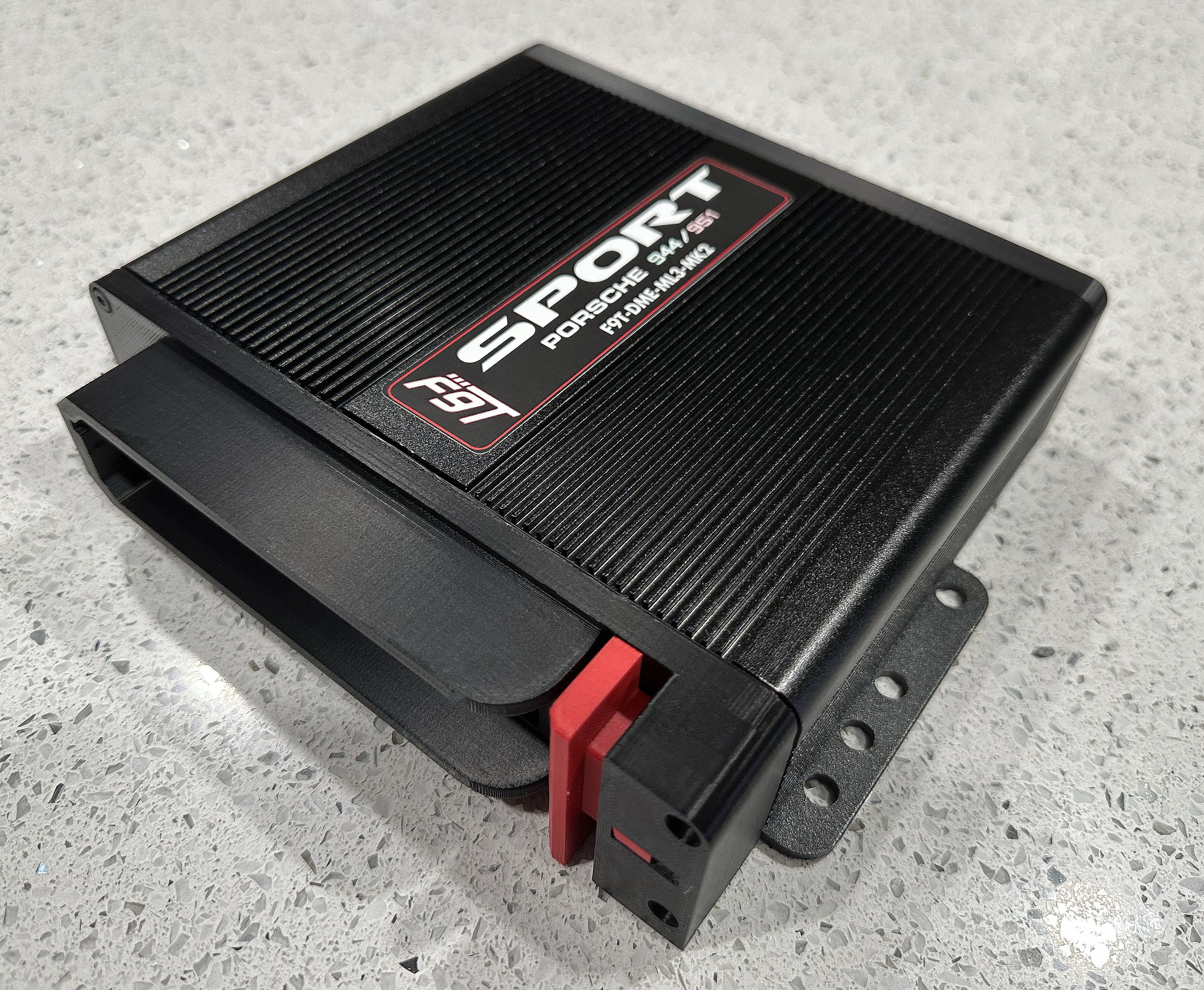

ImageHi Everyone!
Well, it has been about a year, and I believe I have worked out all the issues with the "all-new" Sport DME design. I should have full production units next week. Assuming c5_pilot continues to be happy with the prototype he is testing, I expect to lauch in a week or two!
F9T-DME-ML3-MK2 RC1.jpg (2.7 MiB) Viewed 4762 times

Hmmm... How does this differ from the other ones you are/were selling (i.e., the one I got) :shifty:
Any plans to make a KLR?

Obviously, the main difference is no core DME is required, once an order is placed, I just ship it. Other than that, there four significant updates/options.
Flywheel Senor Circuit
First, the flywheel sensor circuit is completely redesigned and is much more sensitive than the factory circuit based on the S100 chip. This means it will keep you running on a failing flywheel sensor much longer.
Injector Driver
Second, the injector driver is also completely redesigned. It is now a standard "peak-and-hold" driver rather than the factory "Peak-and-Modulated Hold" driver. This should solve compatibly issues with modern low-inductance injectors.
ZIF Socket
Third, you will be able to order it with an optional ZIF (Zero Insertion Force) socket. This is the same kind of socket you find in chip programmers and makes removing/installing the DME chip simple, even with bent pins.
Ostrich Cable Support
And fourth, there will be an optional back plate to feed the Ostrich programmer ribbon cable through. This back place will also have a built-in strain relief for the cable, so you don't need to worry about the cable coming loose or yanking the plug out of the EPROM socket by accident.
