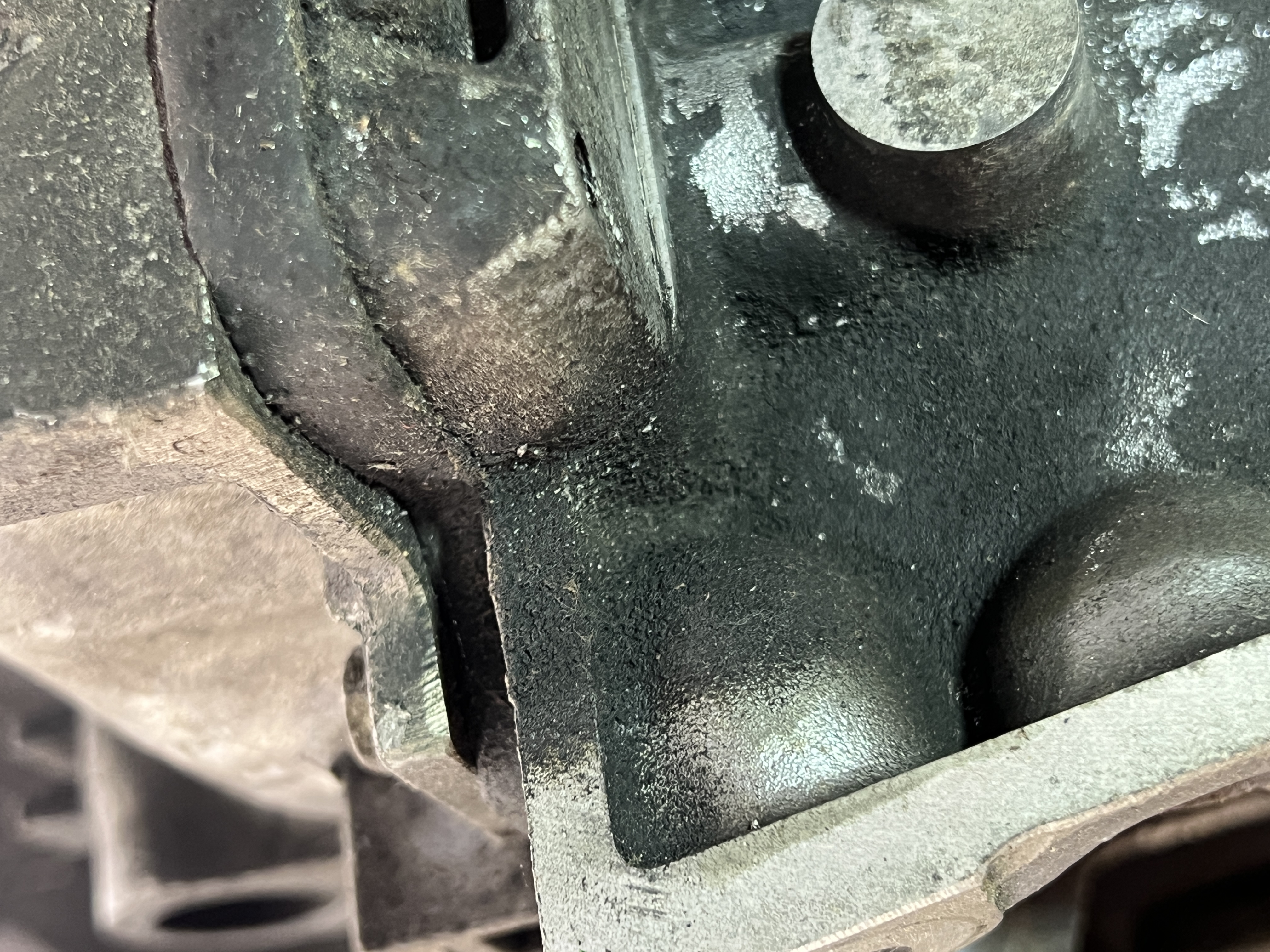

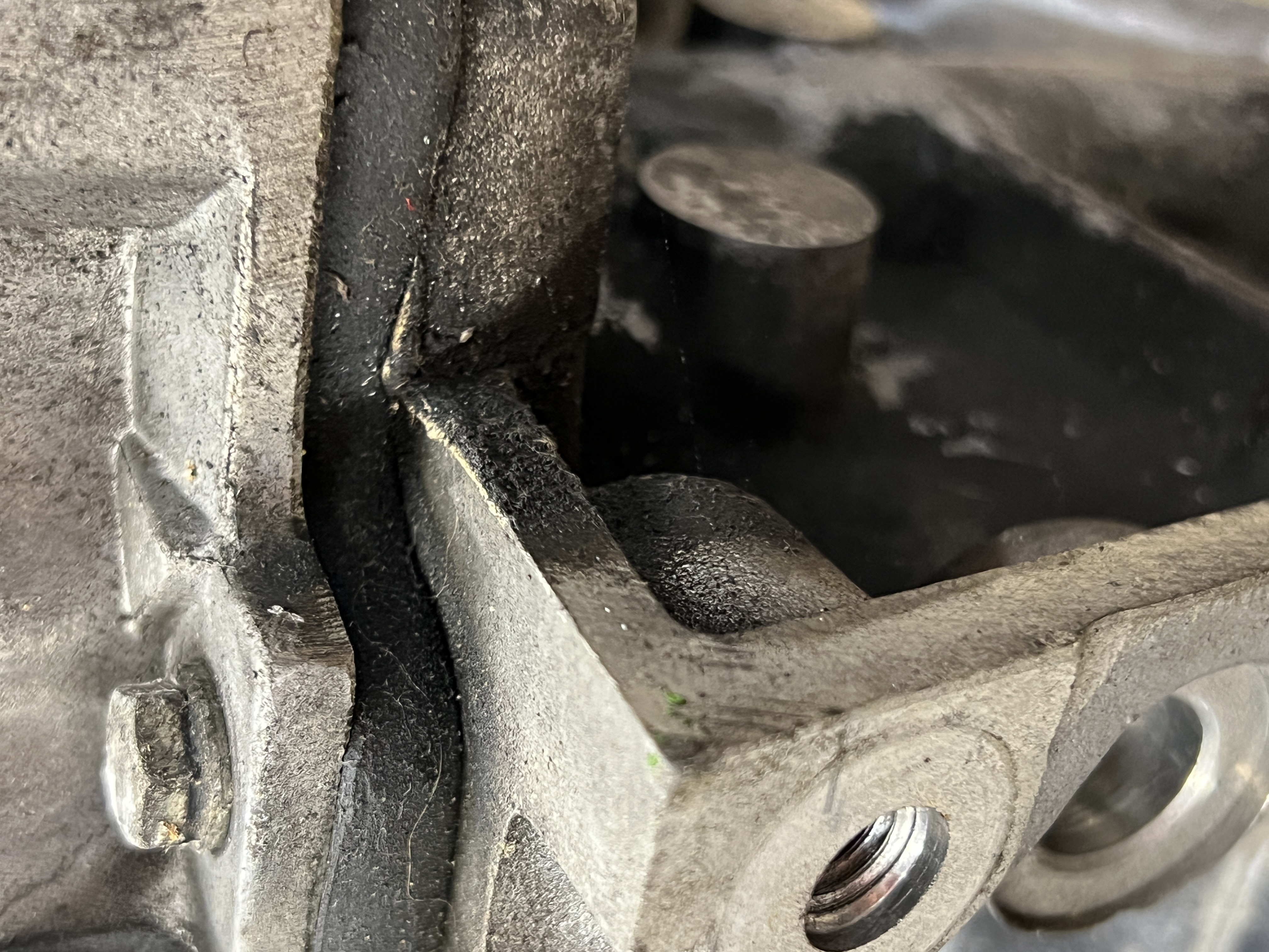

I think that's just how it is...? Here's that corner on an old motor in my garage. The gasket follows the pan/block on all the other corners, but much less so in that one corner.
Oil pan gasket sealing

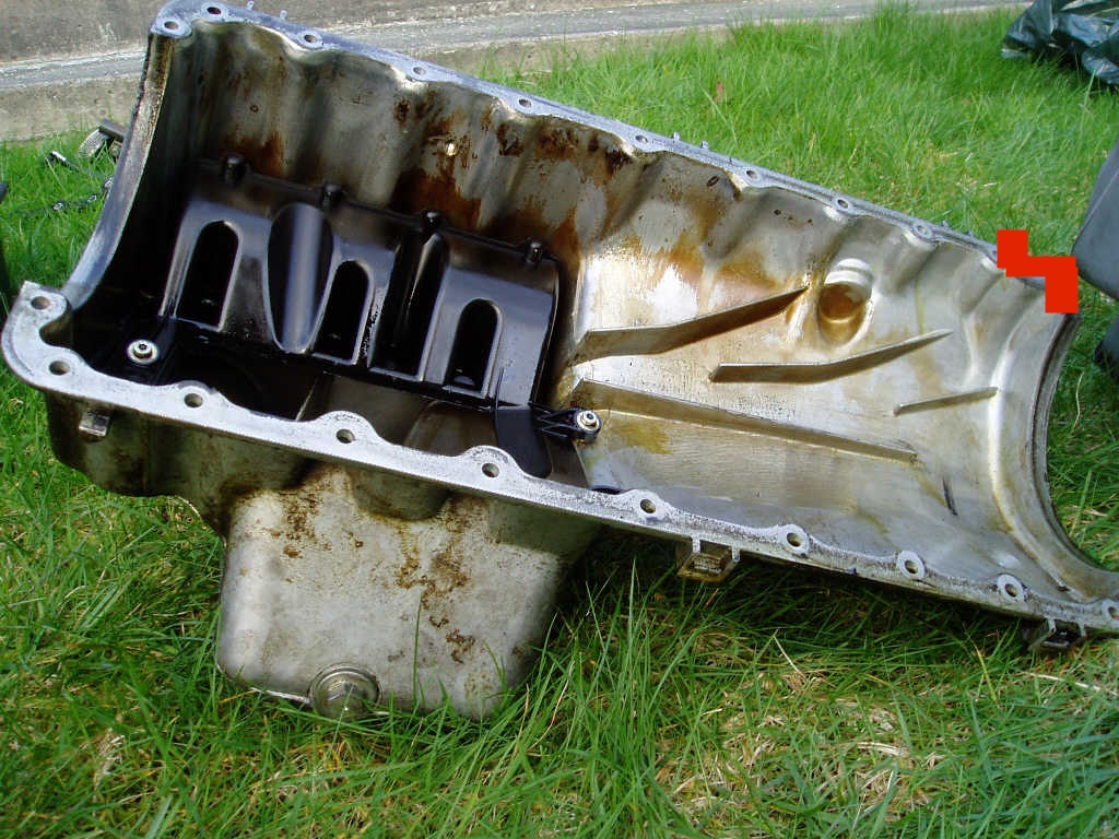

One more clarification...
Put a bead of Loctite 574 along the oil pump seam at the front of the side rails. It should be at same level as the pan rail.
Do you mean in the area I shaded red? Not on the semicircular part...?

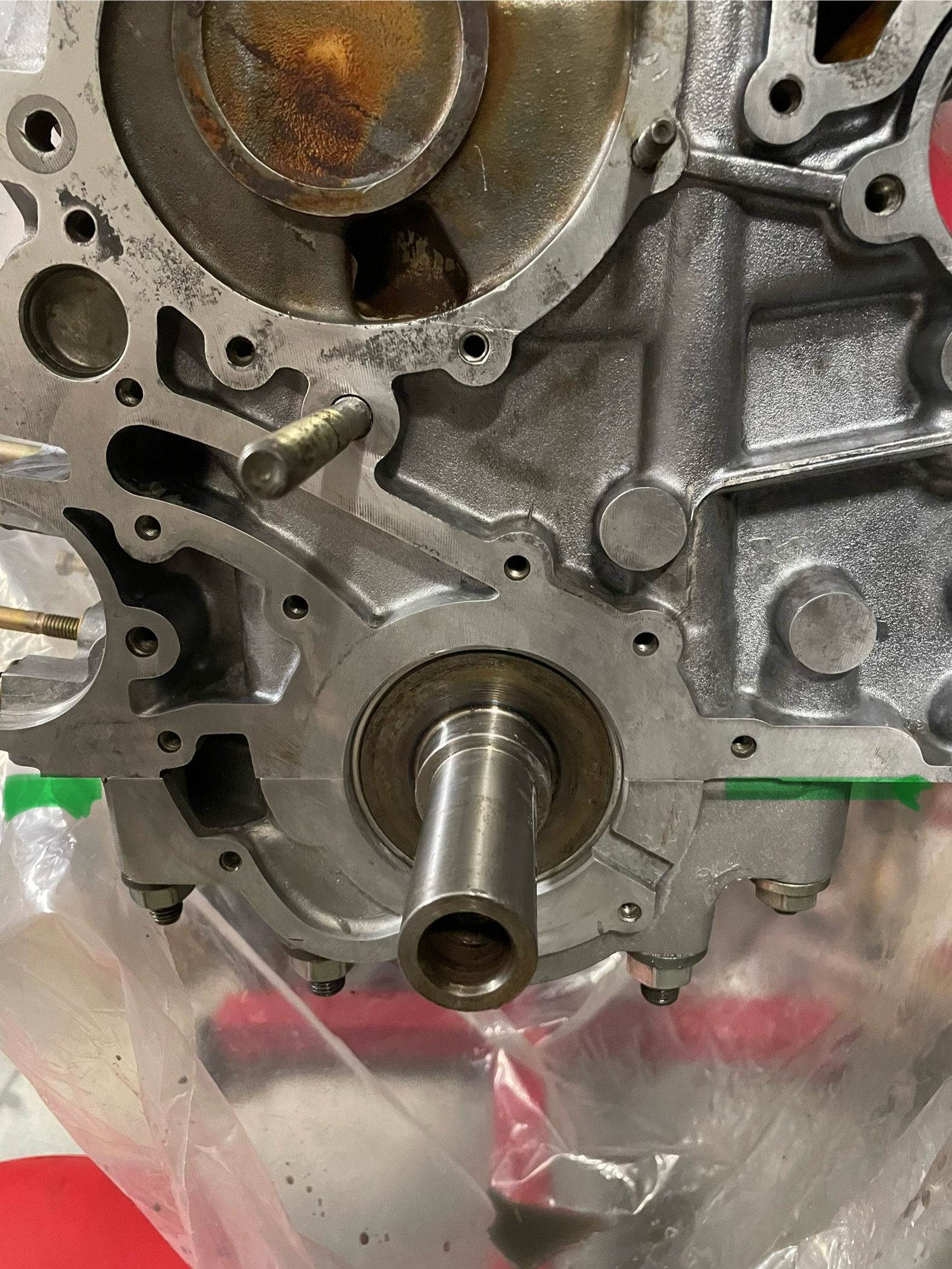

No, not the area in red. I mean the seam on the block where the oil pump meets the block. This is on the BLOCK, not the pan. Just a small bead of 574 on top of that seam.
Does this clarify?
Does this clarify?

So old pic of reassembly but you mean this seam…green lines
- IMG_0781.jpeg (1.94 MiB) Viewed 763 times
