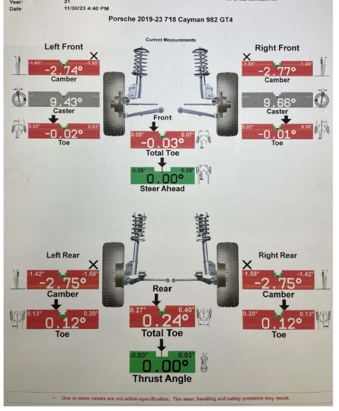

blueline wrote: Tue Aug 29, 2023 6:11 pm I stepped down to 19" x 9" and 19" x 11" wheels (the Apex forged SM10RS) for track use which allows 265 ft and 295 rear. On the GT4 I could go to 305 in the rear but the well clearance is tight and therefore questionable.
I'm running stock 20" wheels and I regularly use 305s on the rear. I haven't had any problems. How are the 19" wheels different?

rbpeirce wrote: Fri Oct 04, 2024 5:33 am
It's not that 305s won't work but rather that there are additional considerations that make 295s better for my use.
I'm using Tarett Engineering suspension upgrades which allow considerably more negative camber than can be achieved with stock 718 suspension components. At -2.75 all around, the clearance is tight and 305/30 at the rear will stand a very good chance of not mixing well with hard track driving. IE: hitting the inside inner wells.
Also, OEM rear 20" tires for a GT4 are 30s whereas the 19" MPSC2 available are 35s. With 35s, the circumference, sidewall height and overall diameter is higher, (respectively by approx 5%, 17%, 5% - per online tire size calculators). With the 295/35 I'm pretty much already at the limit for clearance.
