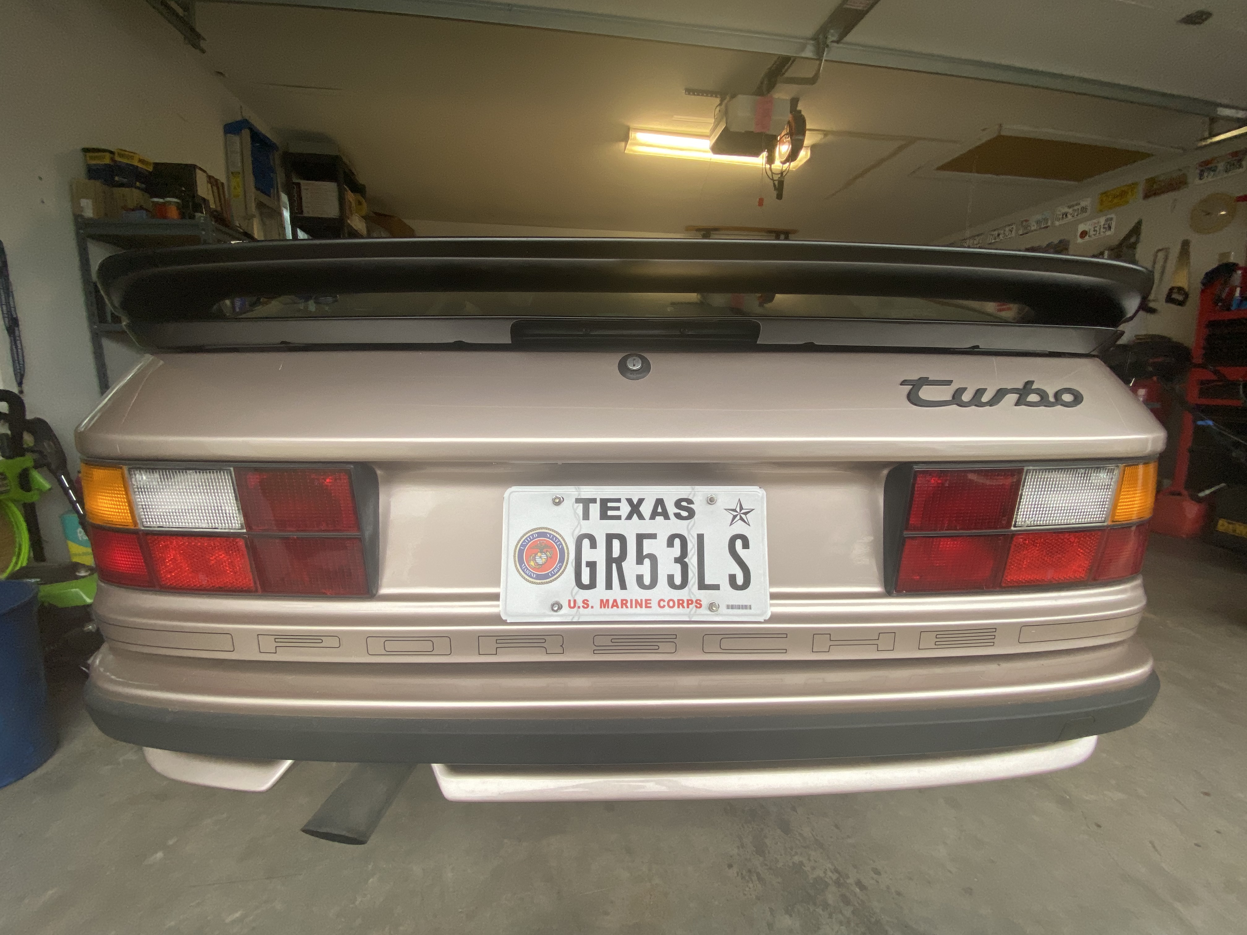

Today I spent some time adjusting my hatch so that it actually sits properly on the car. I know everyone has said that the 944 hatch and 968 hatch are bolt on replacements for each other, but after actually dealing with a 968 hatch I believe there are slight differences between the two.
I had an issue where the rear 1/3 of the hatch actually didn’t touch the seal, and the frame at the top was so close that it actually put significant strain on the hatch frame. I ended up making two shims out of .090 aluminum and it seems to have fixed my issue.
Here is a before shot showing how far separated the rear of the hatch was from the body.
Here you can kind of see the shim as well as a gasket I made out of some stuff I had in hand. I need to get the proper gaskets.
Here is the end result. I’m pretty happy with it but may keep tweaking it a little.
What do you guys think?
