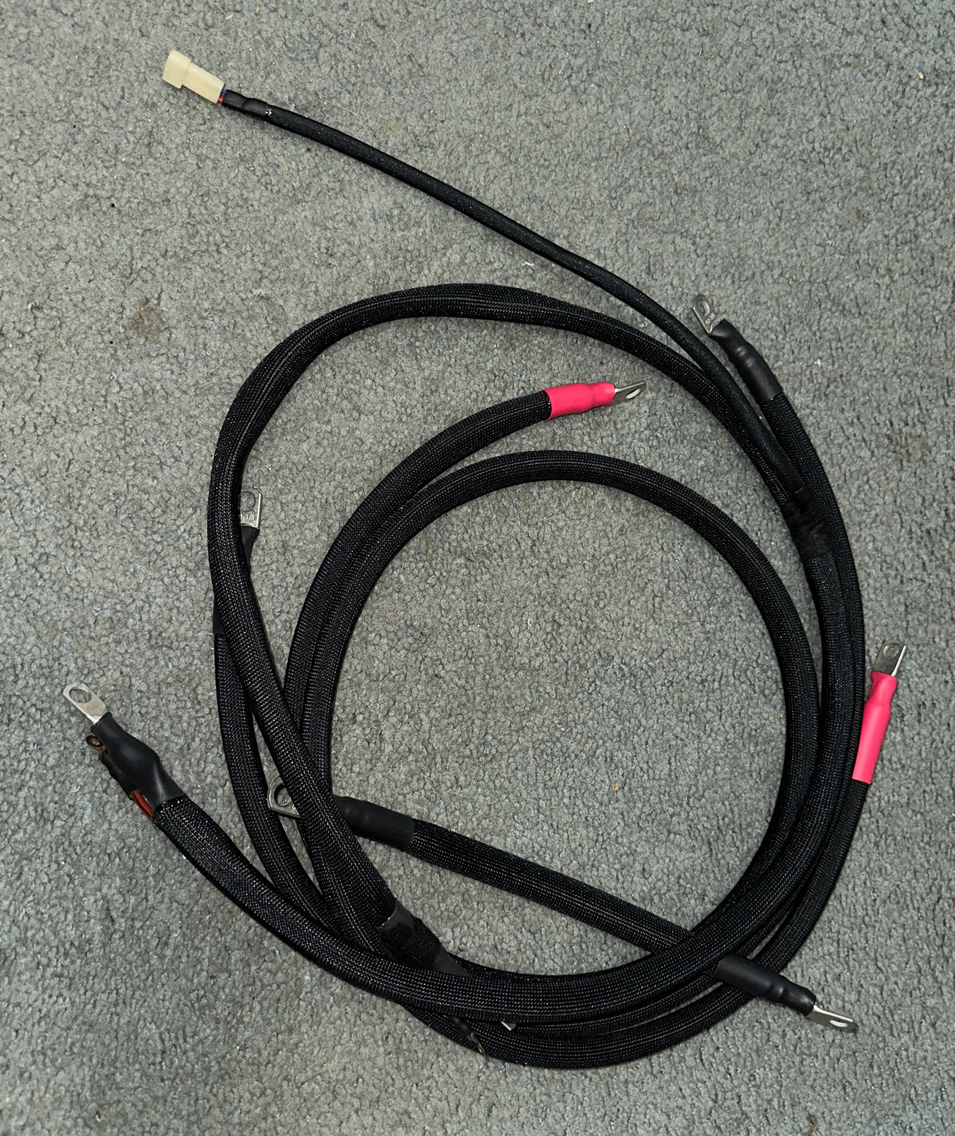

I made my own, I used marine grade tinned copper cable and lugs, covered everything in high-heat/flame retardant tech-flex, the heat shrink is high heat/high abrasion and adhesive lined, so I should be golden. The 1ga cable is pretty flexible, but not great.
Honestly it's complete overkill, the cables in my car are 30+ years old and the only real failure was on the ground cable where some of the insulation was cracking. The way the cables are routed (at least in a base 2.5/2.7L car) aren't around any serious heat, should never see any caustic chemicals, etc. Basically if you want new cables, buy new OEM cables, they will last another 30+ years.
Oh and it cost me more to make my own cables than it would have to buy OEM cables, and that doesn't include the tool side (which I already had), crimping 1 and 4 ga cables is not easy without a proper crimping tool.
