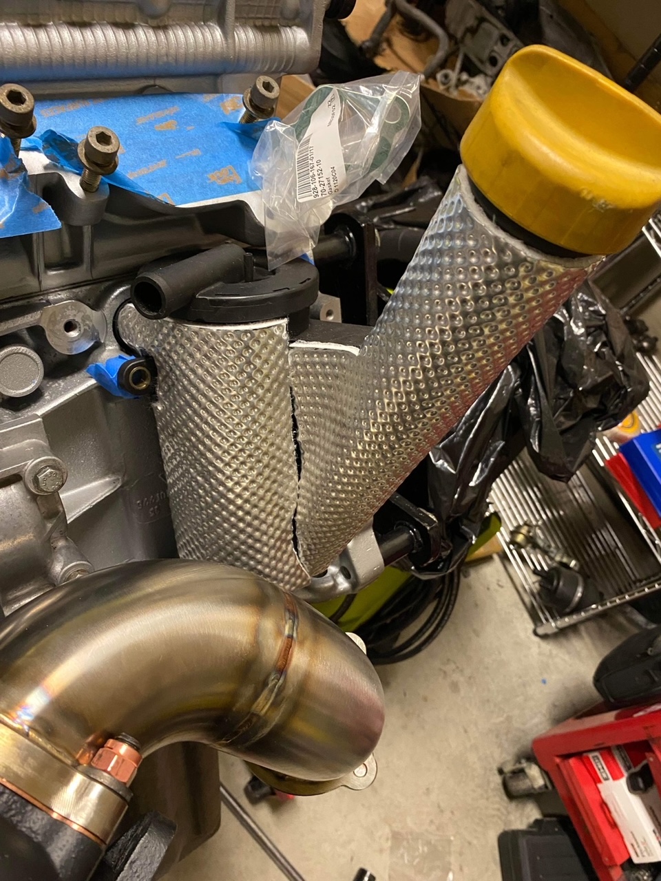

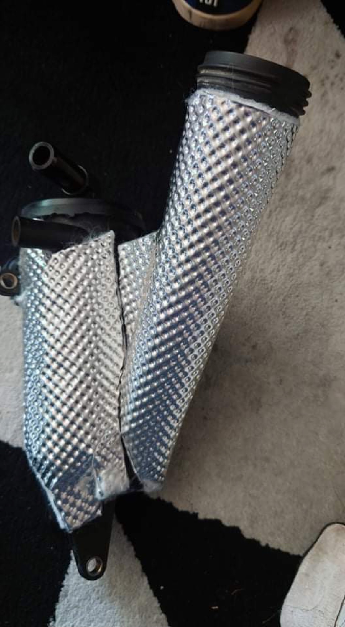

Yep, Some of the voodoo turbo guys are running into that issue as well. Mostly on long full throttle pulls that factory shielding isnt enough . Here are some solutions

In my experience none of the sticky heat shieling stays in place. the glue wont take the heat.
