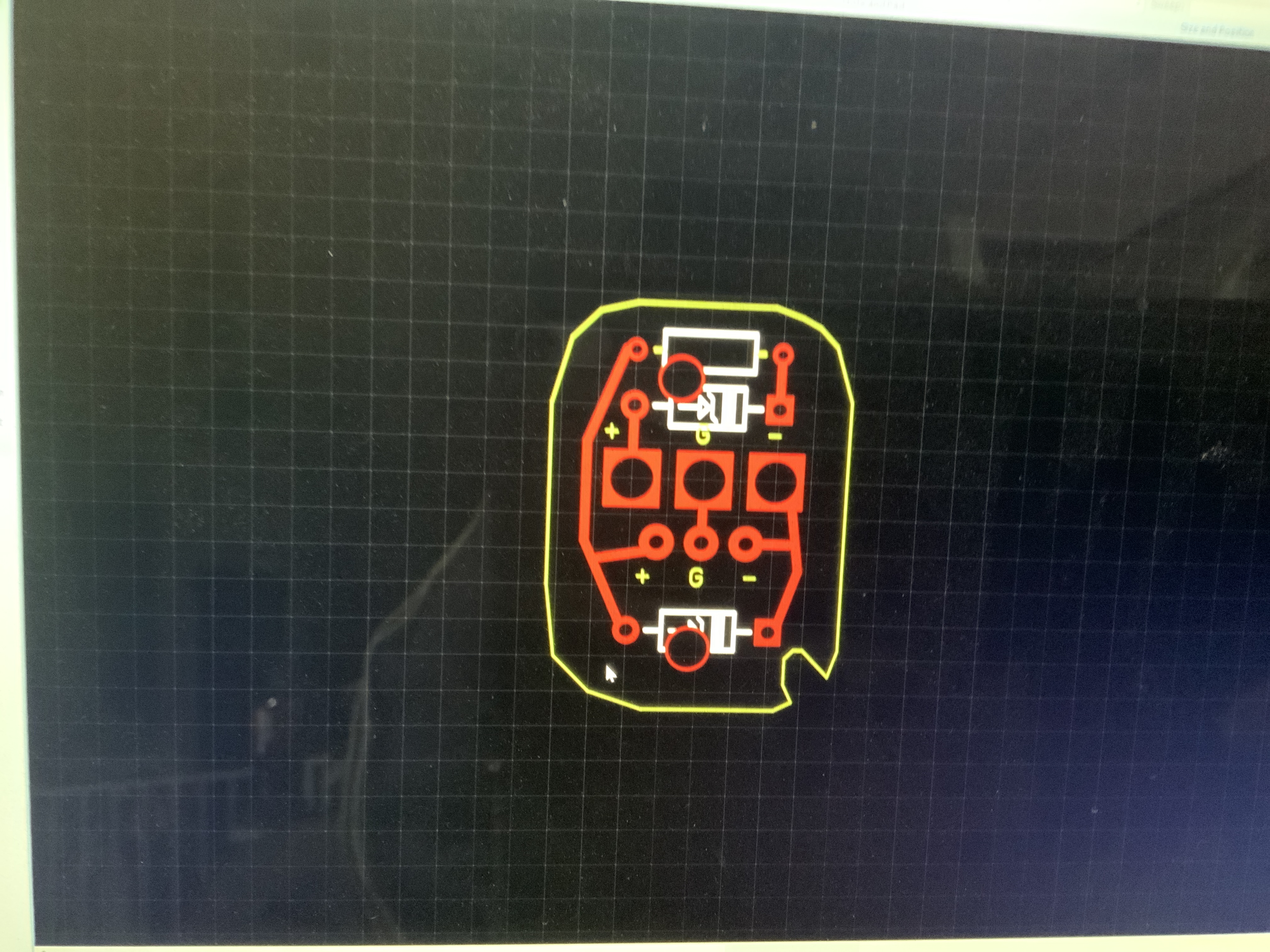

Re-soldering was a no go, found out those things are super fragile, and the Hall effect sensor quickly became detached from the pins. Upon re-soldering to the pins still doesn’t work. Here is the underside of the board. Feels like something that can be re-produced.

You could probably do a one-off with just a perf board since there is so little to it. I've used a number of places to make small-batch PCB's though if you wanted to go that route and needed help. I'm no pro by any means, but have Eagle for circuit design and could do something like this fairly easily. Just need to confirm the values of the parts, and how they connect (i.e., the circuit).

Tom wrote: Mon Jan 30, 2023 6:35 pm You could probably do a one-off with just a perf board since there is so little to it. I've used a number of places to make small-batch PCB's though if you wanted to go that route and needed help. I'm no pro by any means, but have Eagle for circuit design and could do something like this fairly easily. Just need to confirm the values of the parts, and how they connect (i.e., the circuit).
I’m using expressPCB to build out the board necessary, looks like a diode, resistor, and perhaps a small farad cap. since i have two boards from two bad sensors, I’m validating the copper traces in the factory board via continuity testing with a volt ohm meter. I’m going to see what i can make work in terms of Hall effect sensors in the factory spot with a new board.
What I’ve learned is the gear in the transaxle turns the magnet in the sensor which i think as it rotates changes polarity that triggers the hall sensor into sending ground pulse on the middle pin of the sensor.

Got my PCB designed from a circuit perspective, gotta tweak the size and try to get it the correct shape to fit the factory housing.
