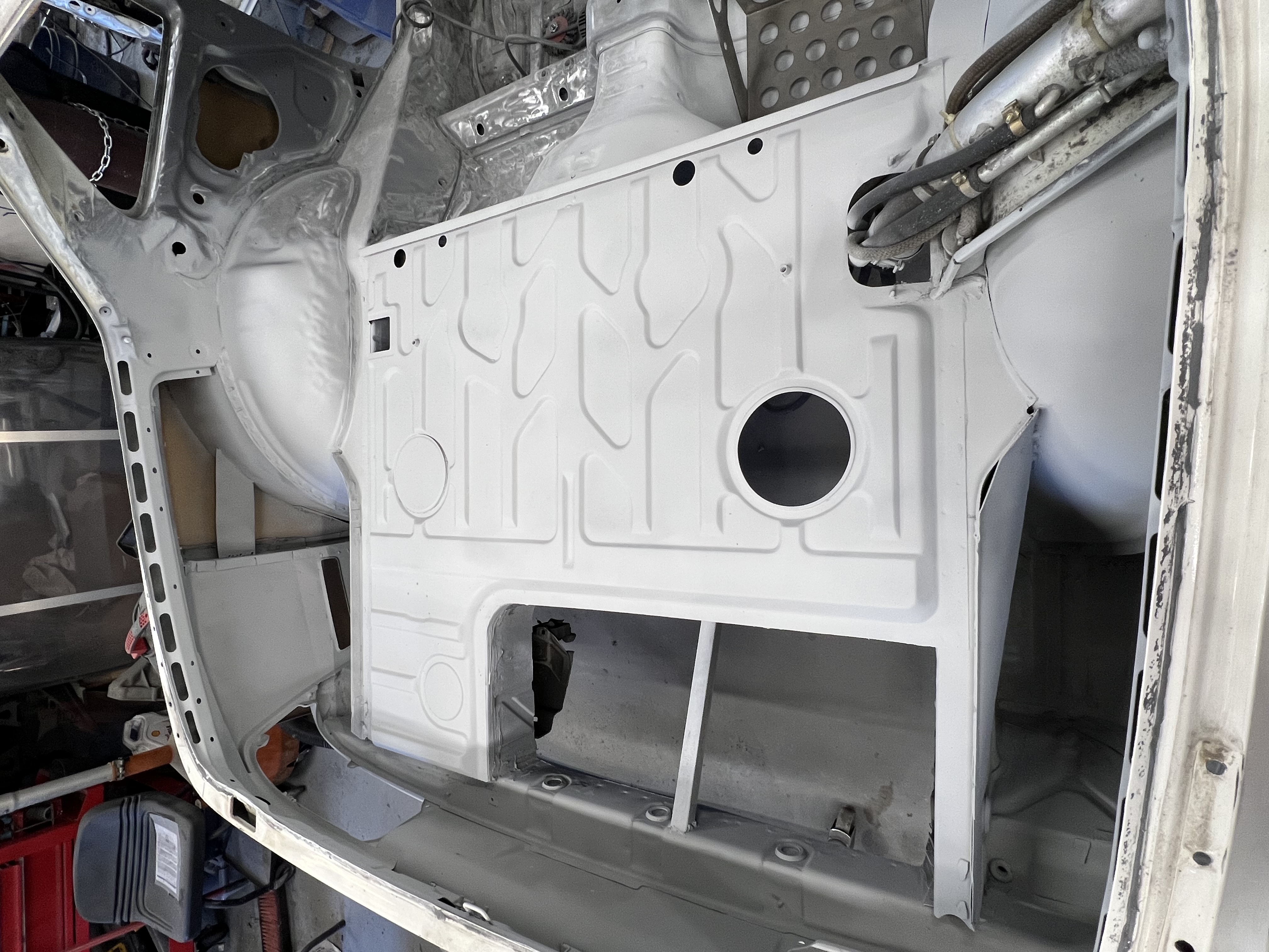

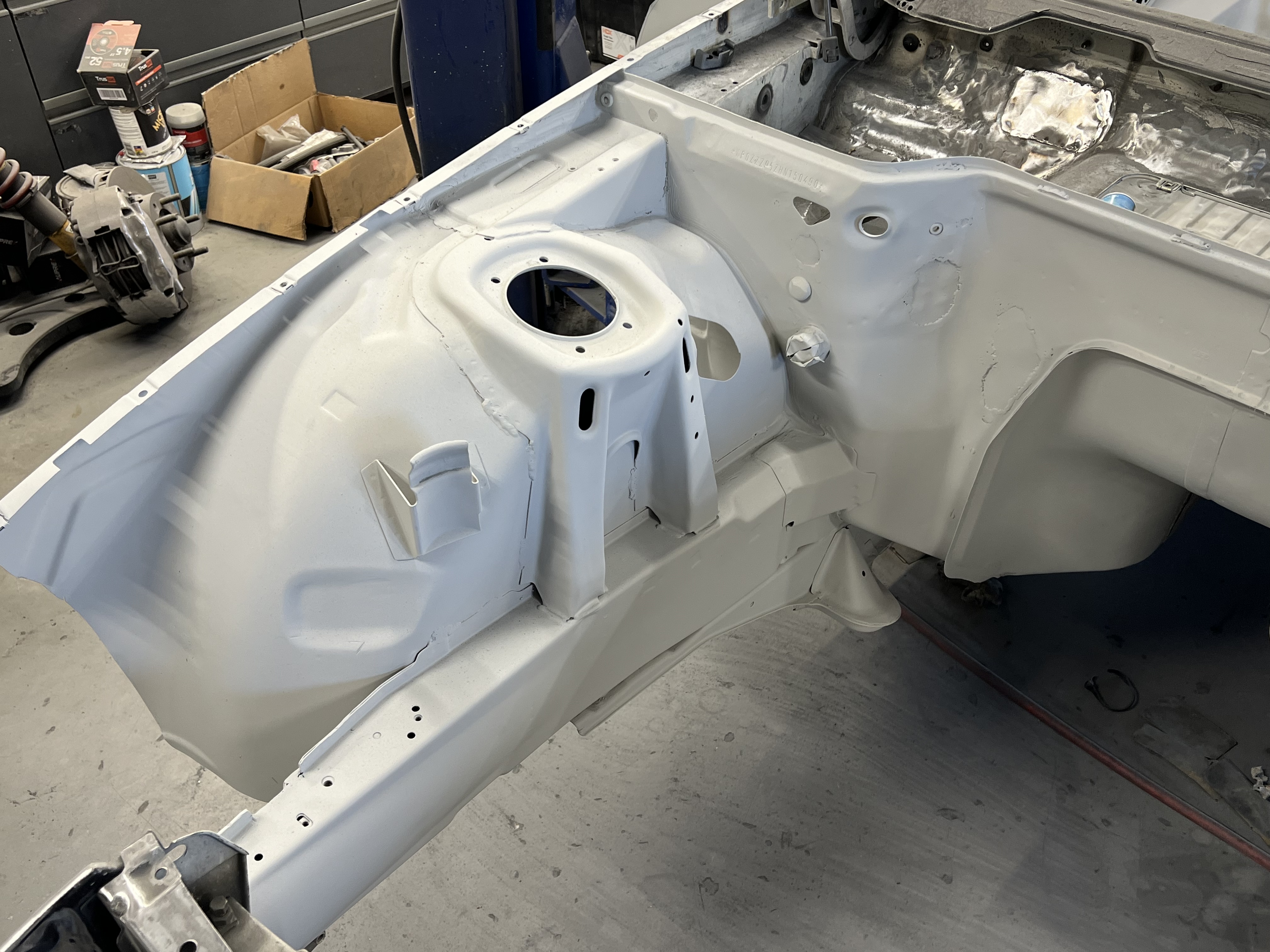

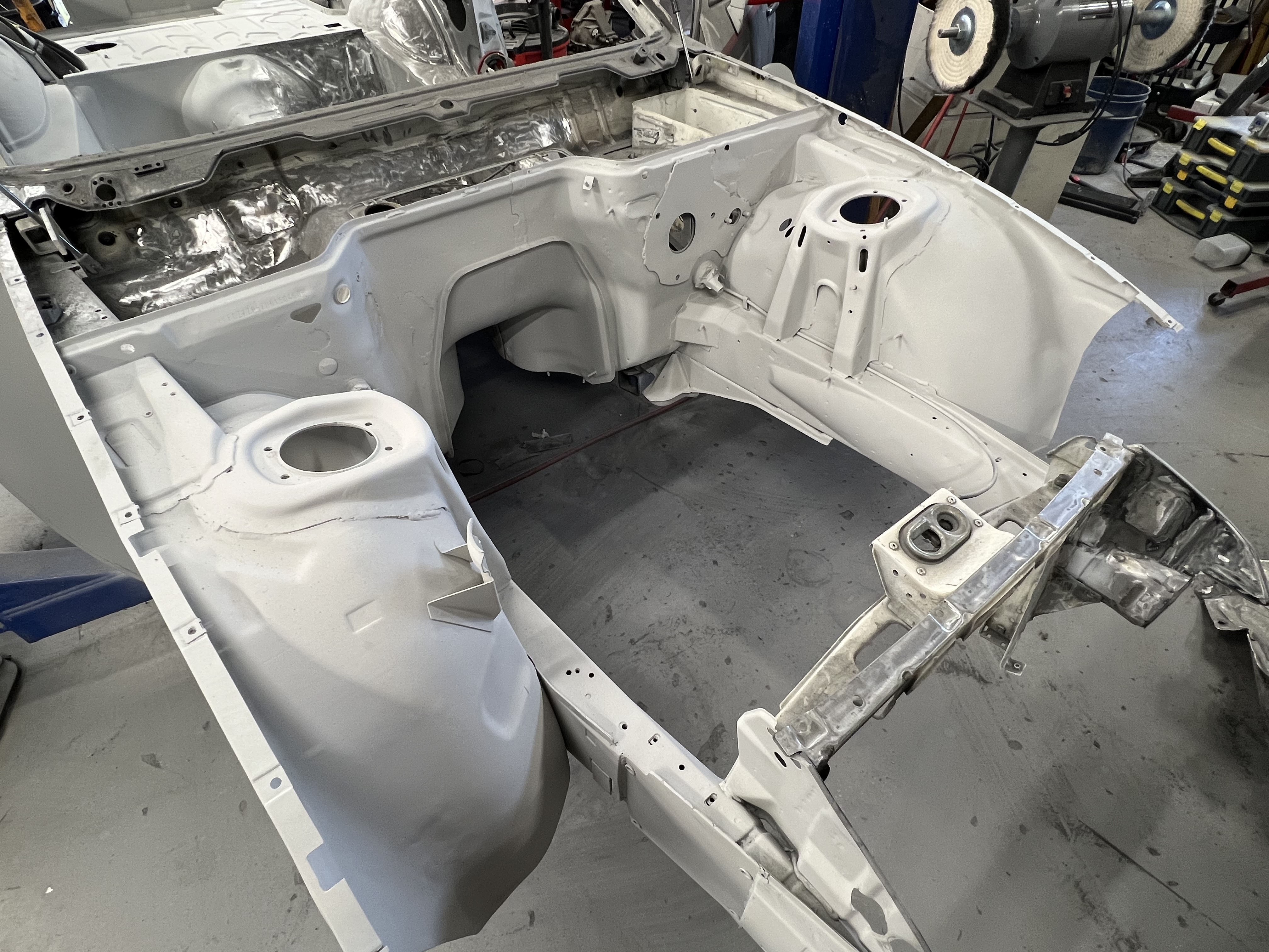

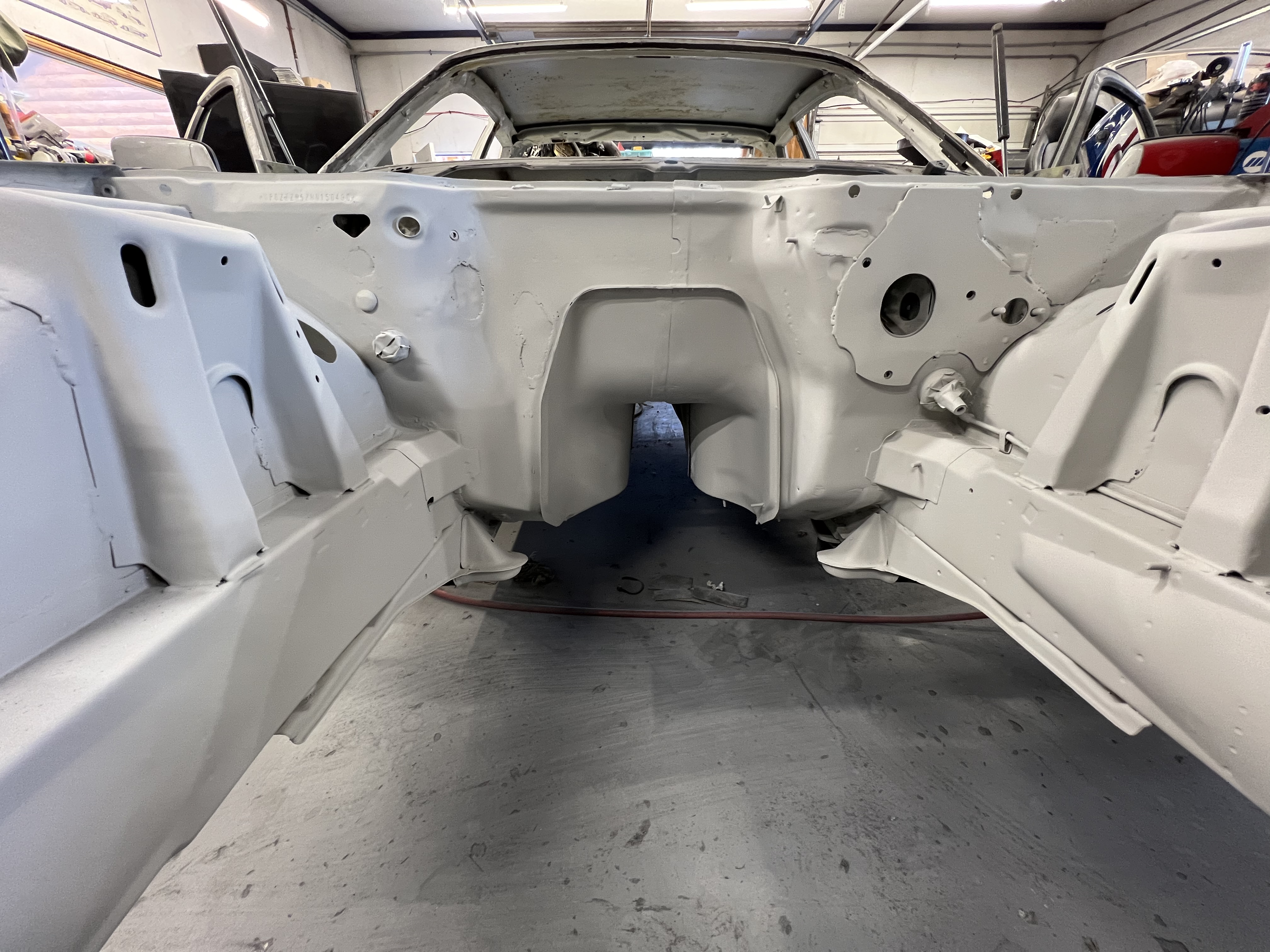

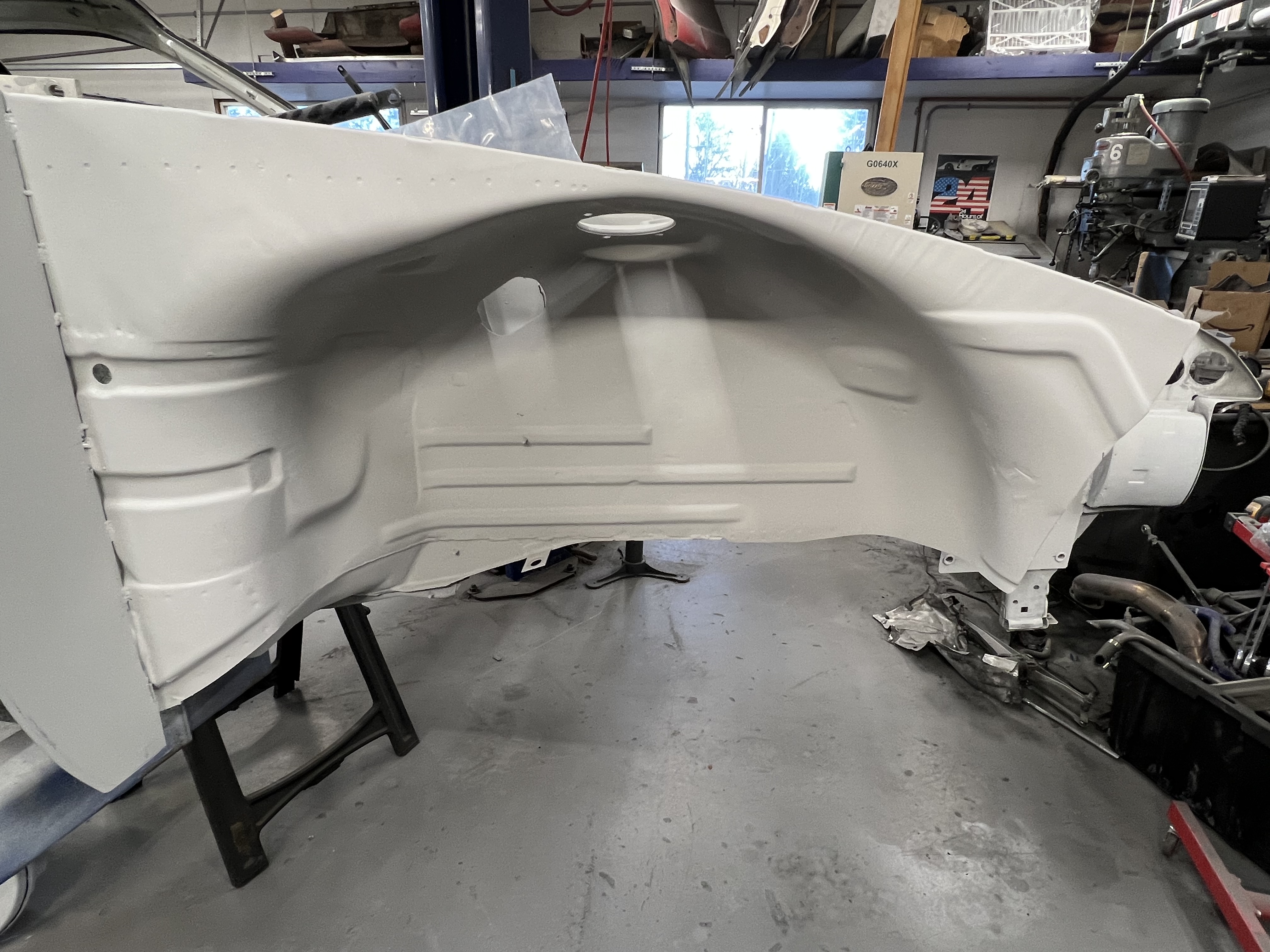

Progress!!:
Progress!!:

Awesome! You are making big progress - congrats on the hard work and dedication. Keep us in the loop as the build continues.chris white wrote: Fri Dec 30, 2022 8:11 pm To me the guys that look like they are having the most fun are spec 944 / boxster and Miata’s, lots of good competition and skills work better than $. I have always felt that the challenge of good track driving is to extract the mist out of what you have on any given day.

Wow, looks like a whole different car painted like that. Did you paint it in place? Drop cloths? Makes me feel exceptionally slow and lazy since I still haven't even finished my tiny little rust patch on the Mercedes yet... Very much looking forward to watching the progress as the car come together.

I'm using 2k Epoxy primer that comes in a spray can. Good stuff, you have to break a seal inside the can and mix the two parts and then spray. Minimal overspray and the overspray that does fall on the floor is already dry and can be swept up easily. I planning for top coat middle of the week - its supposed to be 60 here so I can open the garage door and have some ventilation. going with a 'normal' epoxy top coat and that will have a lot of overspray and fumes.

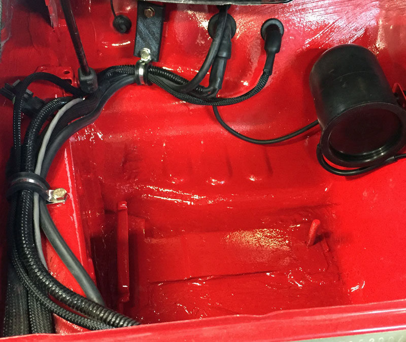

I love the Spray Max catalyzed paint. A local paint shop will mix to code and put any color I need in those cars. Among other things, it holds up to brake cleaner and other solvents that melt through un-catalyzed paints on contact. You don't get the same level of control as you would with a full spray gun set up, but for smaller jobs it take all of the hassle out of spraying true automotive paint. Here's my battery box done with that paint after patching rust holes....chris white wrote: Sat Dec 31, 2022 9:22 am I'm using 2k Epoxy primer that comes in a spray can. Good stuff, you have to break a seal inside the can and mix the two parts and then spray. Minimal overspray and the overspray that does fall on the floor is already dry and can be swept up easily. I planning for top coat middle of the week - its supposed to be 60 here so I can open the garage door and have some ventilation. going with a 'normal' epoxy top coat and that will have a lot of overspray and fumes.

It’s really handy stuff, lots less over spray than a traditional gun.Tom wrote: Sat Dec 31, 2022 3:02 pmI love the Spray Max catalyzed paint. A local paint shop will mix to code and put any color I need in those cars. Among other things, it holds up to brake cleaner and other solvents that melt through un-catalyzed paints on contact. You don't get the same level of control as you would with a full spray gun set up, but for smaller jobs it take all of the hassle out of spraying true automotive paint. Here's my battery box done with that paint after patching rust holes....chris white wrote: Sat Dec 31, 2022 9:22 am I'm using 2k Epoxy primer that comes in a spray can. Good stuff, you have to break a seal inside the can and mix the two parts and then spray. Minimal overspray and the overspray that does fall on the floor is already dry and can be swept up easily. I planning for top coat middle of the week - its supposed to be 60 here so I can open the garage door and have some ventilation. going with a 'normal' epoxy top coat and that will have a lot of overspray and fumes.
