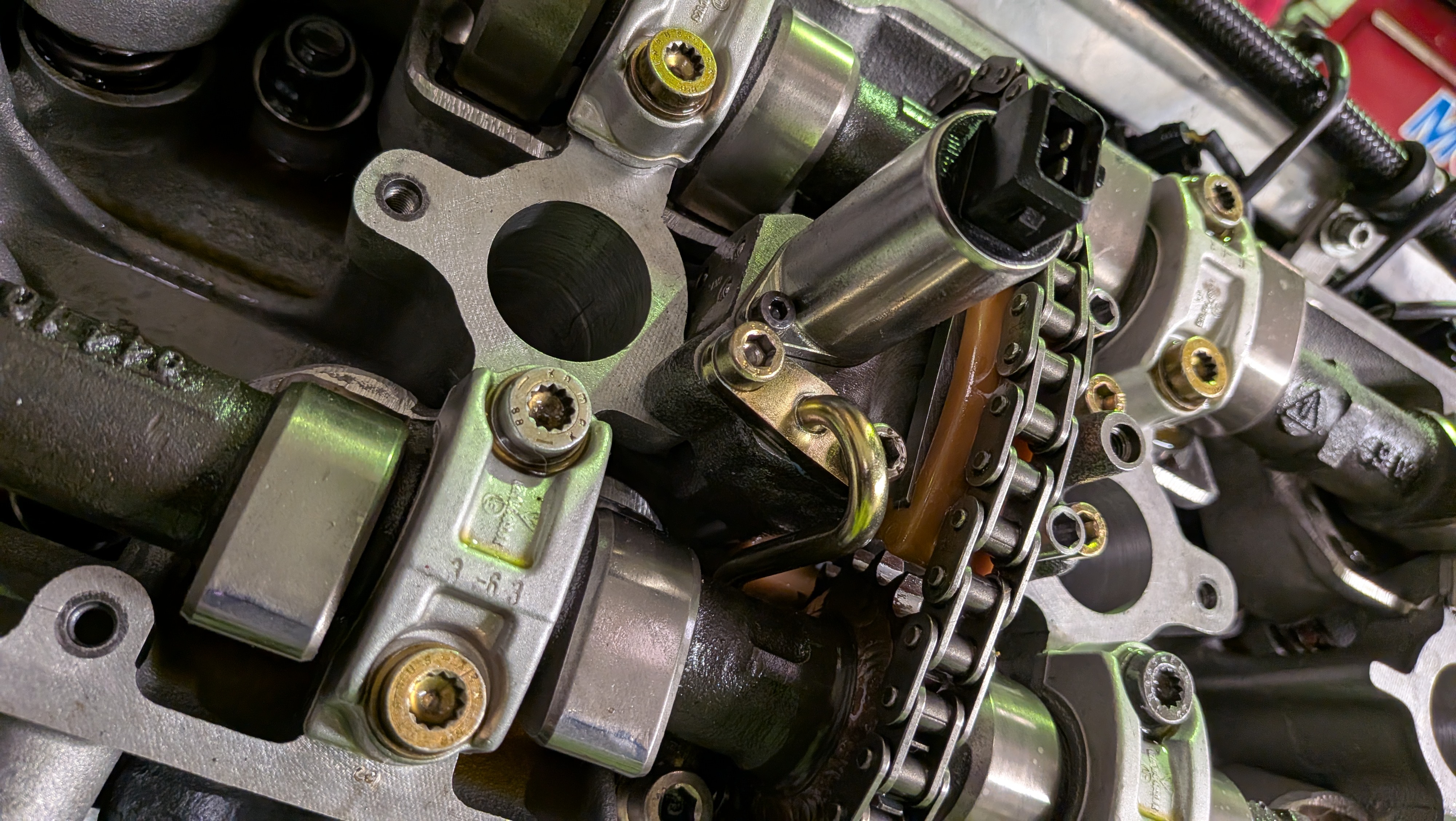

Wonder if the tensioner could be rebuilt with new seals sourced from local bearing/seal shops.
They're not all standard sizes, I've found someone in the US who has sourced some of them, I have a damaged tensioner I found cheap on the way to dissect to look into the feasibility of DIY repair.

Weve changed the tensioner for a refurbished one and replaced the feed tube/check valve for a new one, didnt fix the issue unfortunatly. At a loss what it could be now. Only happens at idle when its hot so its not lifters, sound disappears with revs.
Oil pressure is on the low side when its hot (1.5bar), I put a new pickup in when we built it and we checked the balance shaft timing was still good so I doubt its cracked.

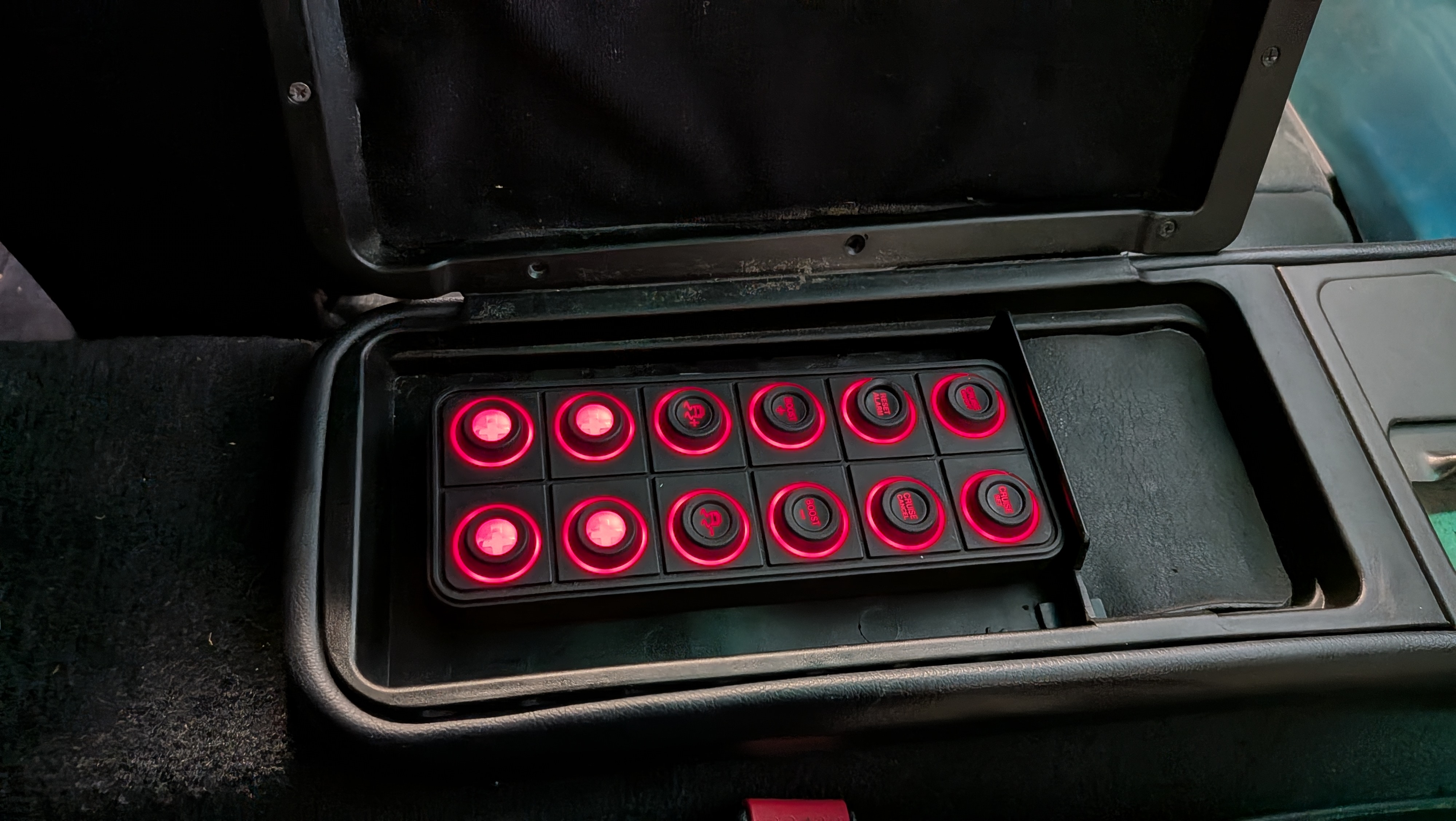

Ive installed a CAN Key pad too so I can now start playing with adjusting the traction/boost control on the fly. The car is hard to drive in the rain without hilarous power slides in every corner.

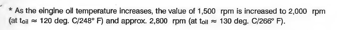

A factory documentation explains that the tensioner is not energised when oil in the head exceeds a certain temperature (as measured with the sensor specific to the 968 head). I can't remember the triggering temperature though but IIRC it's quite high, perhaps 120°C?
Anyway, does the rattle change depending on the tensioner position?
Re: 944S2 16V Turbo Build
Posted: Mon May 25, 2026 4:16 am
by Bergerac
Im running Mobil 1 15w-50, from memory oil temp was around 95degC. TBH 3Bar seems high? I remember my car dropping under 2 at idle with the old engine, there is no issue with pressure at 80degC/5000rpm, its well over 5bar.
Its never deactivated, the trigger point just gets raised

Sorry, yes, this is the doc.
