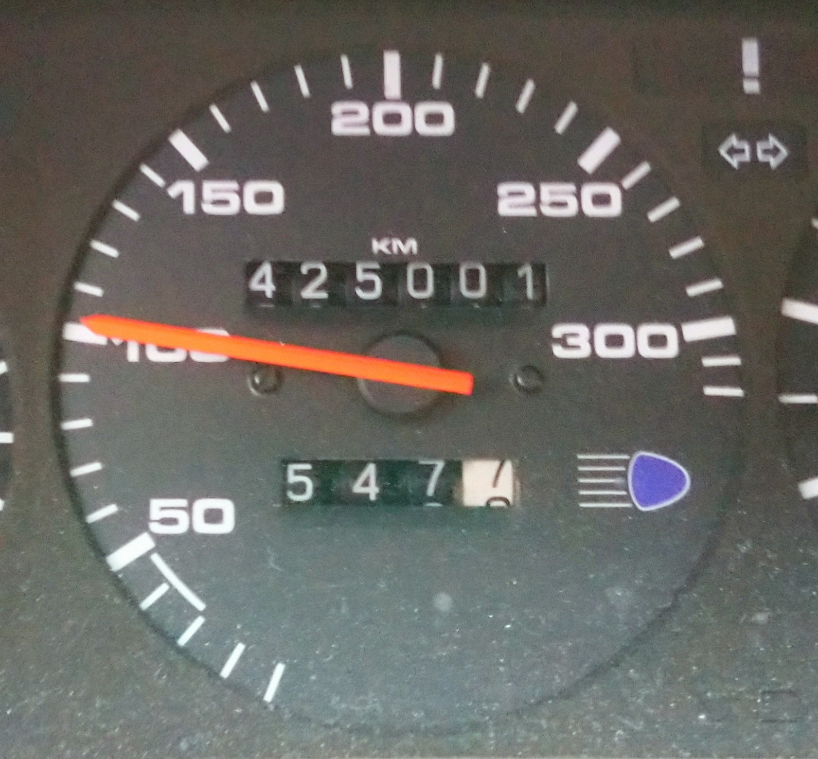

I racked up another 3,000 km since last week, enjoying a "business" trip to Romagnia, Italy. The 944t loves the highway and keeps returning 30 mpg cruising in 6th at 150 km/h at ~3000 rpm. My passenger, who daily drives a Panamera V8S, owns 2 vintage Bugattis and is generally extremely critical with all cars, eventually admitted the experience was just "fabulous".
