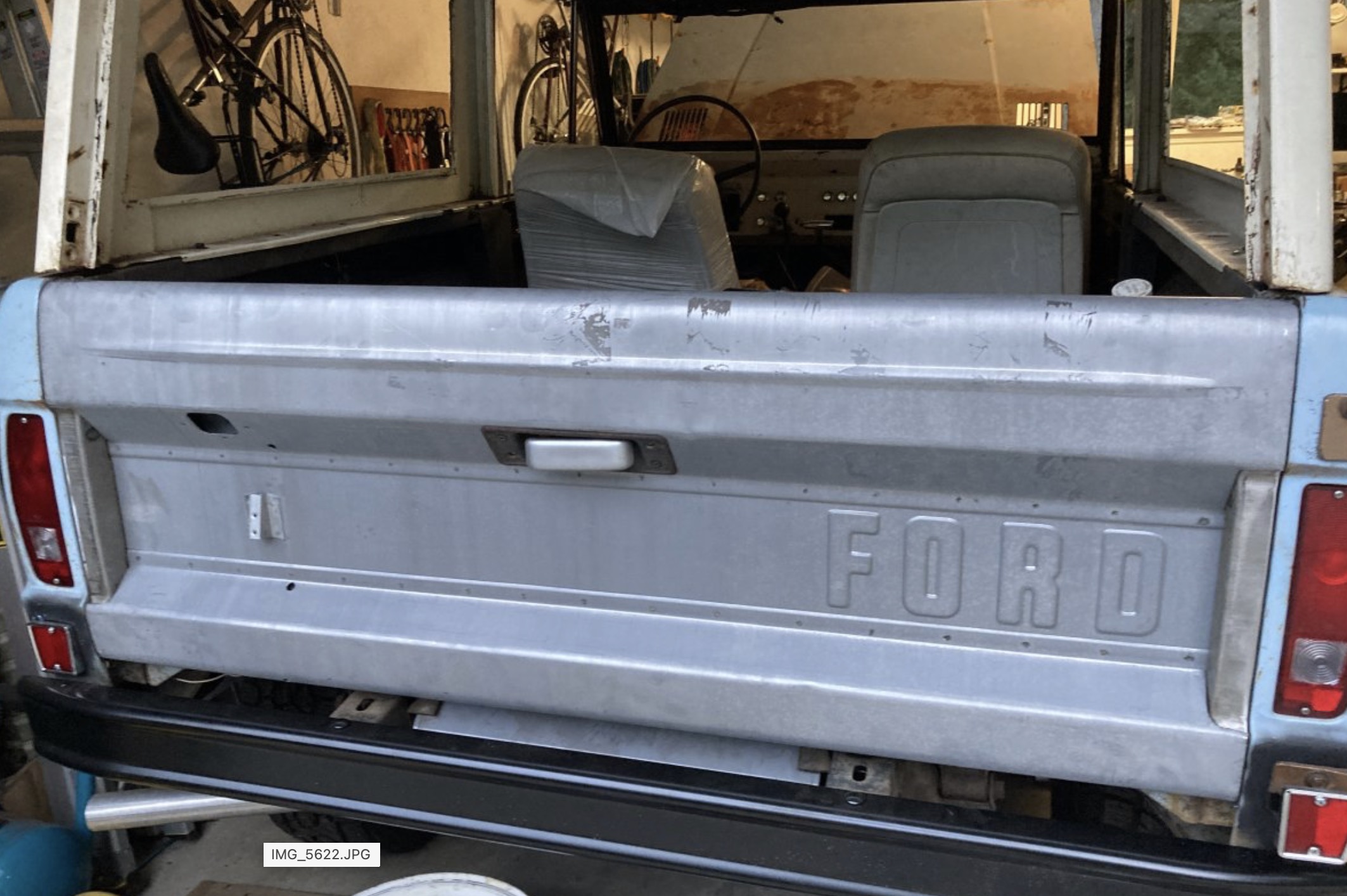

Finally getting around to the rest of the brake work/upgrade. The entire system is now new—hoses, hard lines, all hydraulics, the works. Upgrades are front discs, and power assist. This should complete all the major mechanical work. Moving on to prep for body and paint, including a new tailgate that I didn't know I needed until I poked a finger through a rusty spot...

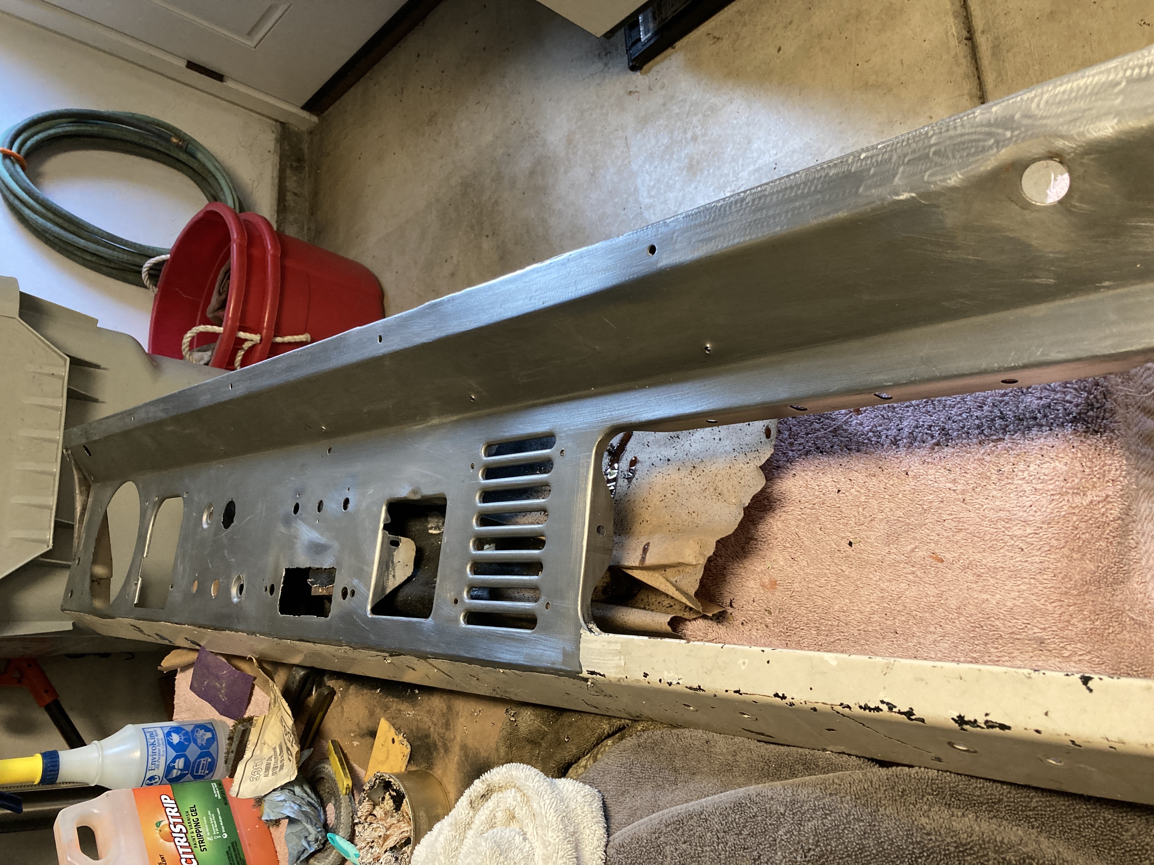

Earlier this week I pulled the steering column and dash out, and installed pre-formed firewall insulation. Then I installed the rebuilt heater box, connected the new heater core using molded hoses, and refilled the cooling system. Started and warmed the engine, and tested the heater successfully.
After the heater was in place, I spent some time doing final tidying of all the new wiring under the dash. The fusebox is mounted so that it will protrude into the back of the glovebox, after I cut a hole for it. The only wiring not done yet is the wiper motor, as I want to paint the windshield frame before fishing the wiring through it.
As for paint prep, I've started stripping the dash panel to bare metal. I hope to get primer and paint on it over the weekend, but there are other things around here that MUST be done before the weather turns, so the dash work might stretch later into next week.

Took longer to get the dash restored than I had hoped, a lot going on around here. (Weather, new grandbaby and elder parent care all at once.) But it's essentially done (stripped, prepped, primed, painted and dressed) and ready to go back in whenever I get the behind the dash area painted.

Looks really nice. I assume that's not spray paint in cans? How did you spray it?
Re: Arne's non-Porsche projects - Now a 1969 Bronco
Posted: Sun Oct 19, 2025 8:28 pm
by Arne2
Tom wrote: Sun Oct 19, 2025 8:18 pm Looks really nice. I assume that's not spray paint in cans? How did you spray it?
Actually, that is rattle can paint on the dash. Rustoleum 2X Satin Ivory Silk in this case. I've become fairly adept at getting good results from rattle cans on smaller items. This dash is about as large as I'll do that way. But in this case, getting the correct low-gloss paint to spray with HVLP would have meant having a whole quart mixed up. I can't use that much of that paint.
