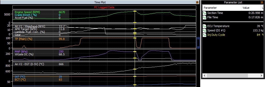

Here is another log of interest, with boost peaking at 1.8 bar @4500 rpm and tapering to 1.5 bar @6700 rpm.
Flooring the throttle @2500 rpm sees 1.0 bar at 3700 rpm, with open loop boost control.
100-150 km/h in 2.5s
100-190 km/h in 6.9s
This is with losing traction when torque kicks in at 4300 rpm and again at around 5700 rpm.

Well, it was unsettling the first times and still is but somehow you get used to it. Obviously you are only going to try this on a deserted straight and turn the knobs of attention and focus to 11, but the car pulls straight, at least in the dry. I drive with headphones on to listen for knock but it is not easy to focus on your hearing when driving requires so much attention.
I may try stickier tyres depending on how the car drives after figuring out the settings for closed loop boost control which I find more difficult to tune as the turbo is much more responsive than on the 8V engine, but this is a car used in all weather and I need good all round tyres.
