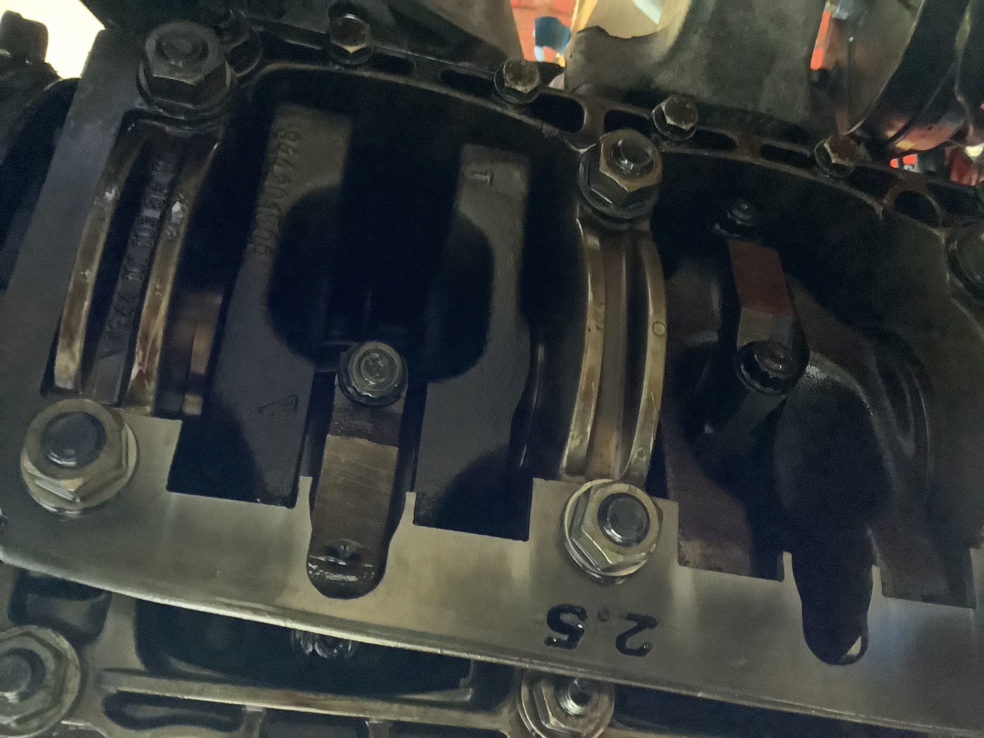

Did the oilpan yesterday after seeing oil around the gasket. Not my favourite job for sure the OP that assembled this engine somehow managed to strip 5 threads so no wonder it was leaking. I did a hack job and installed longer studs in place of the bolts with broken threads . I need :thumbdown: to helicoil these holes next time the block is on the stand. Just no room for drilling with the engine in car
Had to check the rod bearings while in there and decided to leave them as they looked to be the black ACL bearings with no wear.
After installing my “hack” with loktite on the threads it all bolted up nicely with the normal 8nm torque.
Now I noticed the lower balance shaft cover has stripped threads too . Going to delete those and maybe anchor that with studs.
PO spent big bucks at the machine shop with this engine. To bad he skimped on a torque wrench
