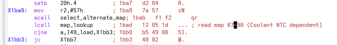

I'm pretty sure that Rogue's map is just not an rpm map. Yes it's an NTC lookup and the values look like plausible rpm values, especially with the map interpolation. But when that map is used in the code, the value that's read out is being compared to 49h (load):
That
Code: Select all
select_alternate_map
is where the code plug is checked, and one of the maps from 87 to 90 is selected. Now 87 and 89 point to the same map so there are really only 3, and the one from Rogue's XDF file is 87/89.
They apparently do have something to do with idle speed, but I don't know how. My best guess is that there's a kind of nested control going on. In other words, rpm is controlled by allowing the ISV to vary the load, but then idle load is also controlled to a target value too. Obviously that would tend to move the rpm. But I have heard it said before that idle rpm is controlled by spark timing too. I can see it's definitely controlled by the ISV in the code, but it could be that the ISV is coarse control, and limited to values that keep the load within an acceptable range. If more control is needed to get the idle speed on target then maybe timing is used. The only reason I can think of for that would have something to do with emissions.
I'll figure it out eventually lol.
The altitude thing, probably a red herring, sorry! The map selection that determines whether Tom's map or Dave W.'s map gets used depends on an ADC value that's described as "channel 5" in the code (in the opendme comments) and from the ADC channel info I have, 5 is "ground" which wouldn't make any sense so I thought they were counting from 1 instead of 0, which would make altitude channel 5.
But on closer inspection, they're counting from 0 so that's probably not it. I'll take a look at the ADC routine and schematic and see if I can figure out where that value comes from.
