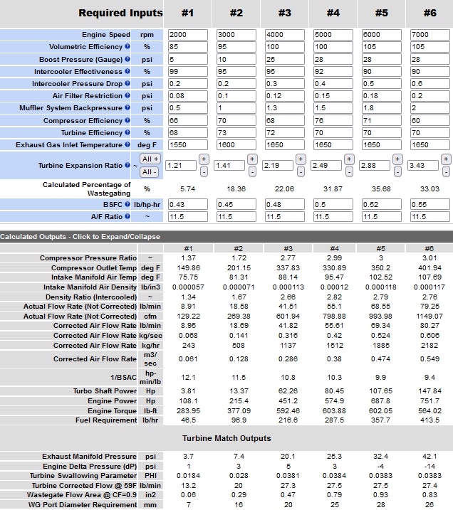

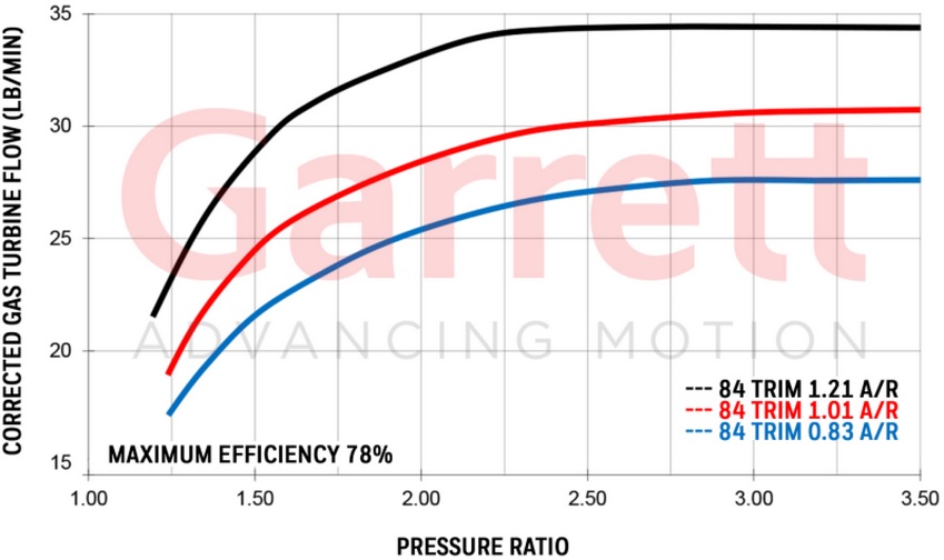

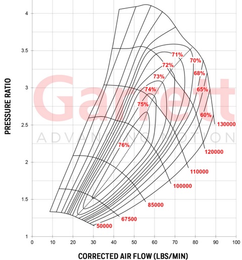

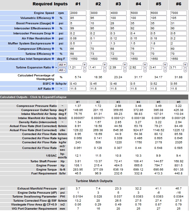

Here you go - GTX3584RS with a peak compressor flow of around 85 lbs/min and a peak turbine flow of 27.5 lbs/min with a 0.82 A/R housing.
As previously this is with pushing the boost as high as possible to get close to the peak compressor flow yet have plots that follow each other more or less realistically in the compressor map. The resulting figures are a bit ridiculous - 700 lbs.ft at 5000 rpm and 800 hp at 7000 rpm. The back pressure to boost ratio at 7000 rpm is 46.7/31 = 1.5.
To reduce these figures we can lower peak boost from 35 to 28 psi :
600 lbs.ft between 5000 and 6000 rpm, and 750 hp at 7000 rpm but the back pressure to boost ratio at 7000 rpm is still at 42.1/28 = 1.5. This is a huge amount of torque and we can certainly question its relevance, as according to the matchbot this is also what I get at 4000 rpm with the GTX3576R, and I certainly do not think this is the case in reality.
Rather than wondering about the accuracy of values it is perhaps more relevant to consider how they evolve in between engine speed points.
With the GTX3584RS we get somewhat of a plateau of torque from 4000 to 7000 rpm with power peaking at 7000 rpm.
With the GTX3576R the plateau is between 4000 and 5000 then an almost linear drop, though not severe even if it stalls at 6300 rpm with more than 23 psi.
For what this is all worth anyway, as I really cannot believe that exhaust manifold pressure can be any lower than boost pressure up to 5000 rpm. Also the maximum turbine efficiency mentioned on the turbine map most certainly applies to the largest housing.

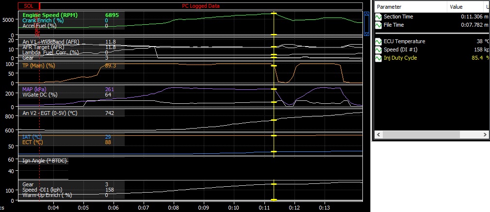

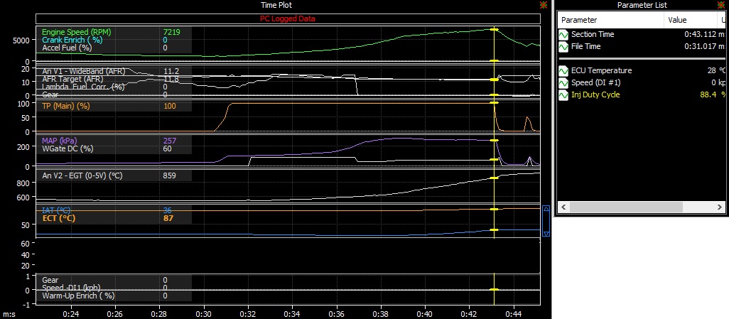

Perfect weather this morning for a bit of tuning. I have adjusted the boost to 23 psi (260 kPa) again and get spikes to 290 kPa (27 psi) at 4800 rpm. Here is some logged data, with an ambient temp of 22°C.
100 to 150 kph takes ~2.3s but 100 to 200 kph is not measurable as flooring the throttle after changing to 4th causes the rear to break loose, and what I had thought was the compressor running out of flow seems to be more of a mix between a loss of traction and the OS Giken LSD's remarkably progressive and smooth action that helps keeping the car (about) straight. It seems the LSD needed all that performance to finally show its true value, and at a boost level of 23 psi there is clearly enough compressor flow left above 6300 rpm where the match bot suggested the compressor would not keep up. The injector duty cycle suggests the 1200cc injectors are maxed out.
It is a lot of fun and now just below scary or perhaps I am just getting to grips with it. With improved boost control it should be close to perfect but at this stage with how hard the boost hits it is a bit of a "rough diamond". I have never loved that car so much in the 18 years I have had it.

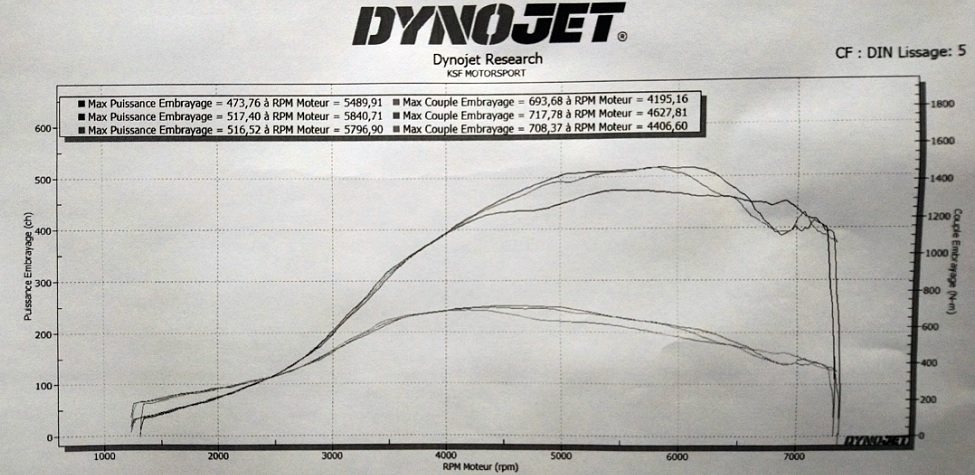

Back from the dyno... 517 hp / 529 lbs.ft (718 N.m) @23 psi.
(First run was at 20 psi (1.4 bar) of boost, the other two at 23 psi (1.6 bar). On the very first test runs the engine was overboosting to 30 psi which triggered the MAP limit so had to adjust on the fly the boost table to clear things up, whence that first "clean" run at 20 psi)
The tuner said I should redo the harness to the fuel pump as the power should be much higher than that with such high injector duty cycle values with 1200cc injectors. He also reckoned that the 0.82 A/R turbine housing was too small for a 3L engine. The loss of power above 6000 rpm as shown on the spreadsheet is not anywhere near as obvious on the road, though back pressure may be climbing fairly steadily above 6000 rpm.
The bottom line to me however is the plateau of torque of more than 370 lbs.ft (500 N.m) from ~3200 to ~6500 rpm which I hope illustrates a bit better what I meant about this set up being really good on the road.
