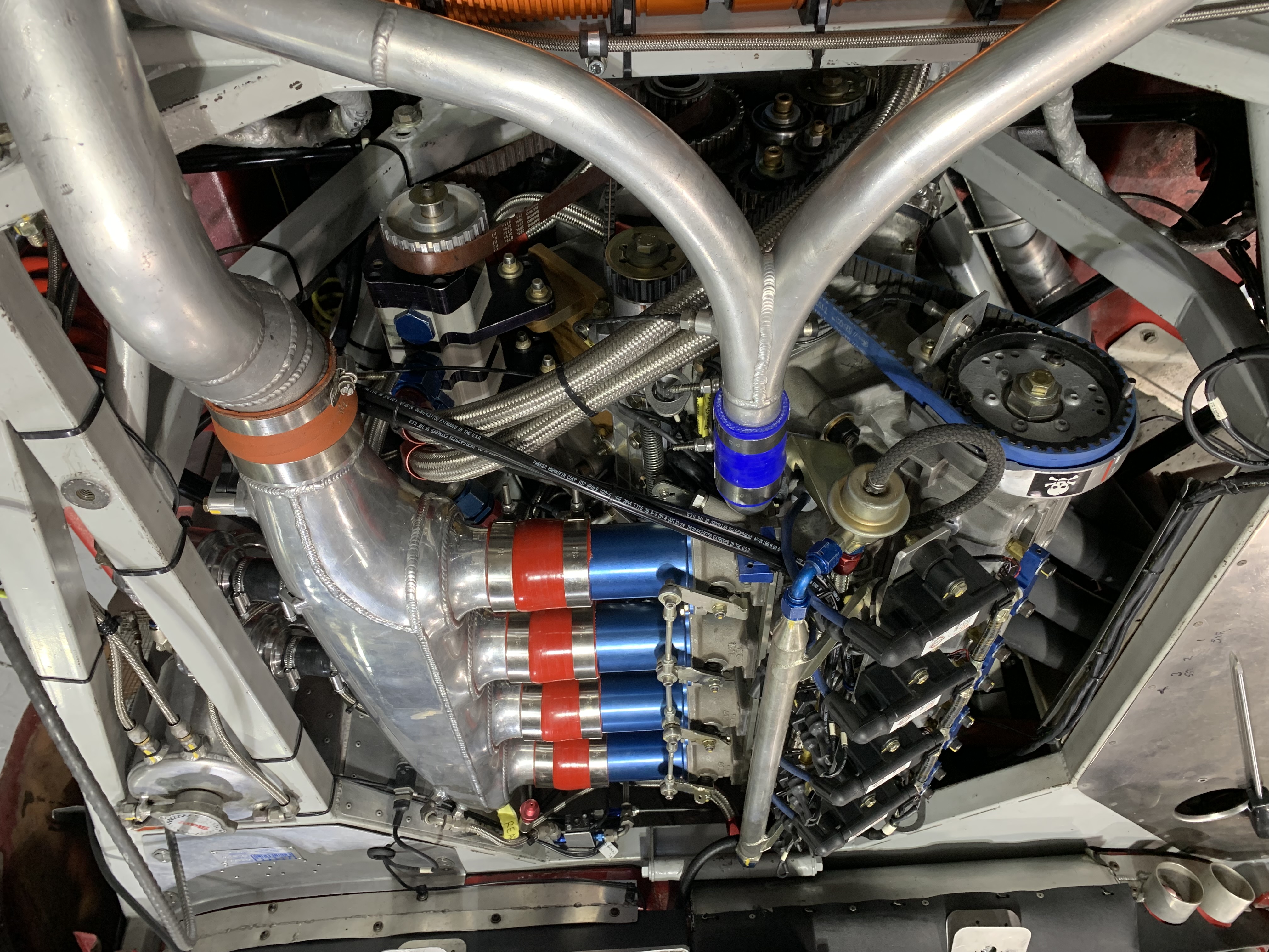

Re: Project status....
Posted: Sun Jan 05, 2025 3:22 pm
by michaelmount123
GTR Engine.jpg (2.56 MiB) Viewed 2734 times
The engine is back in the car. Cleaned up a lot of things, and hope to be on the dyno this week.
Posted: Sun Jan 05, 2025 4:33 pm
Can't wait for the dyno -- looks like modern art!!
Is the skull and cross bones sticker a 944 cam belt joke? :lol: :lol:

Was the intake plenum also tested on the flow bench? It would be interesting to know how balanced it is.

michaelmount123 wrote: Sun Jan 05, 2025 3:22 pm GTR Engine.jpg
So I was browsing facebook recently and came across the Porsche 944 GTR #3 page, and it appears to be the same engine. I believe only 7 of these cars were built. I assume this engine must be out of the #7 car?
Very very cool that you are working on one of these engines @michaelmount123! I think I read these make around 550hp?
