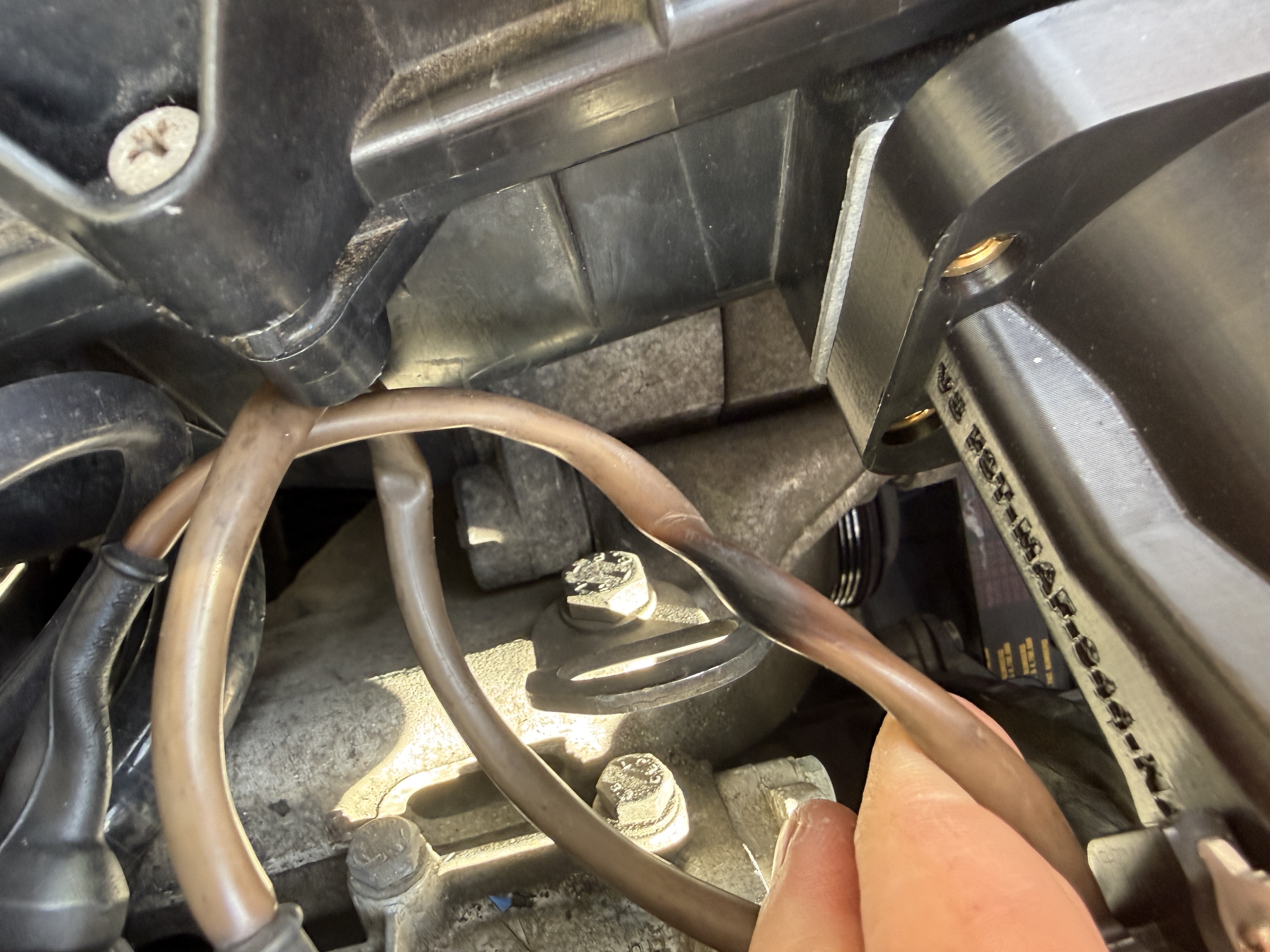

For what its worth, I realized I left out the photos from the DME testing.
This is where I got 0.75 k-ohms, sorry, it was the first value I saw. Then 0.78 and then my videos of 0.85
Also, I saw this burn mark on my TPS pigtail, so I cut it back. Wires look perfect. I imagine the rest of the harness cant be much different, I haven't seen any other signs of serious wiring decay, even the grounds were not to bad.
