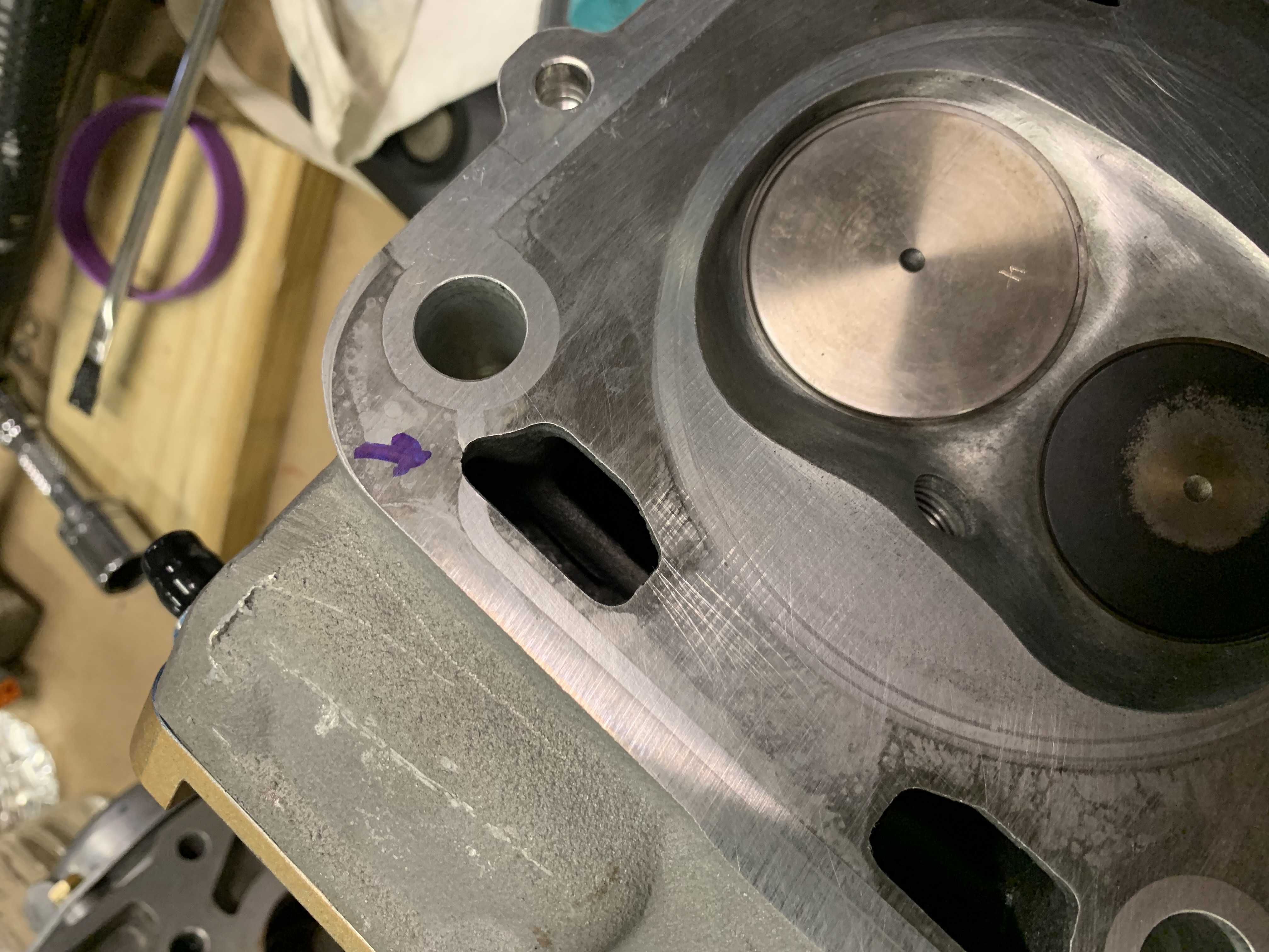

Interesting flaw...
Here's a photo of the GTR cylinder head surface that shows the source of a coolant leak. Although it only leaked when cold, it was frustrating to have to monitor the coolant level and refill between track sessions. The photo shows where the head gasket seal missed the corner of the water passage. A dab of additional sealant in the flawed area will hopefully address the issue.
