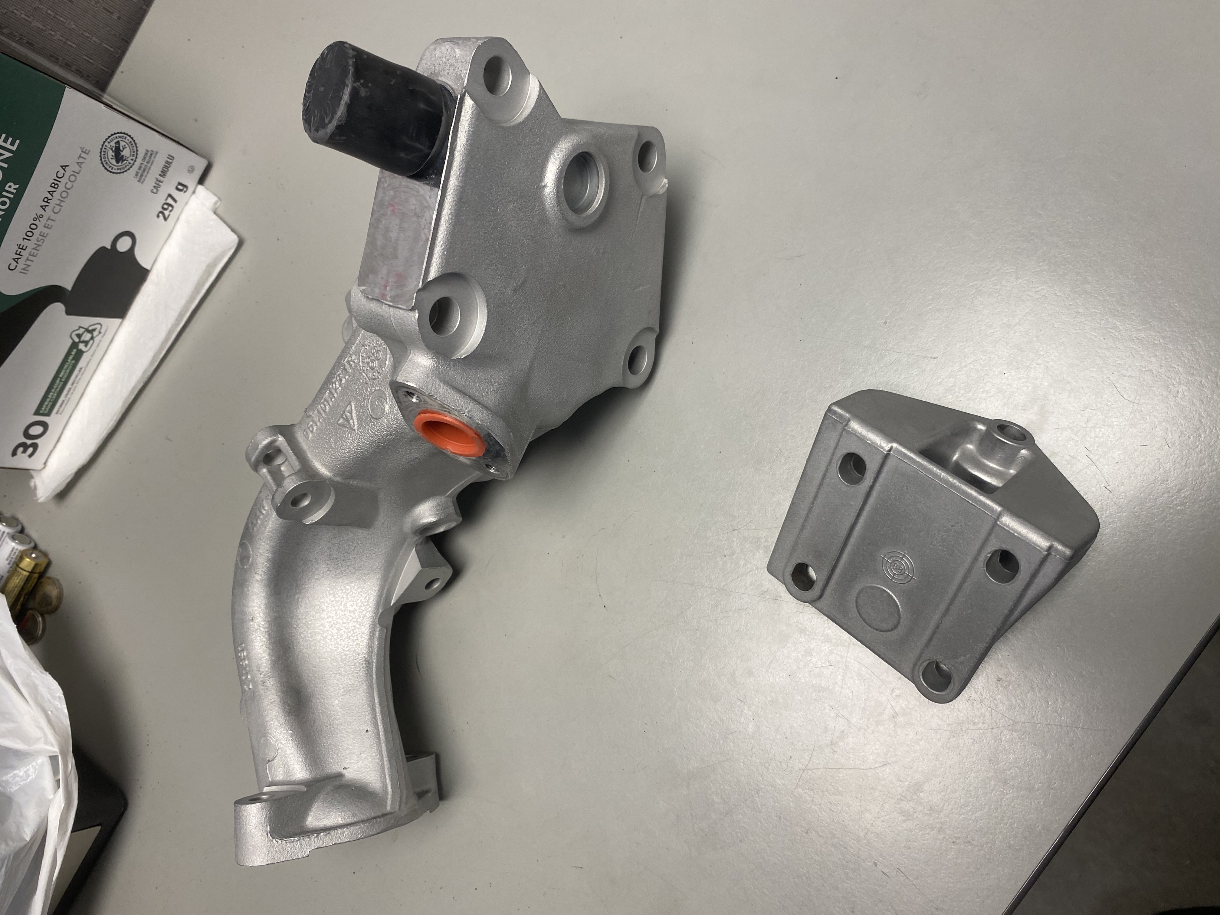

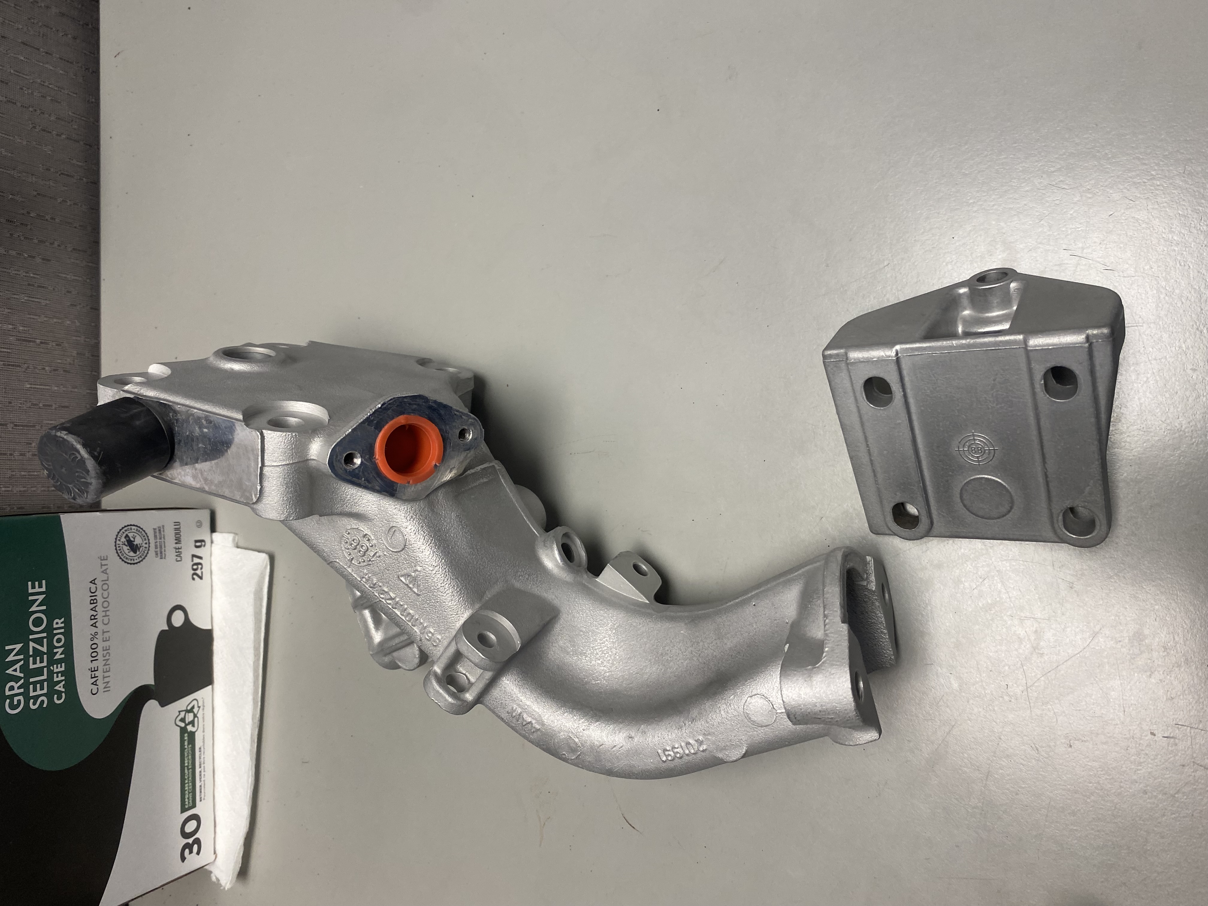

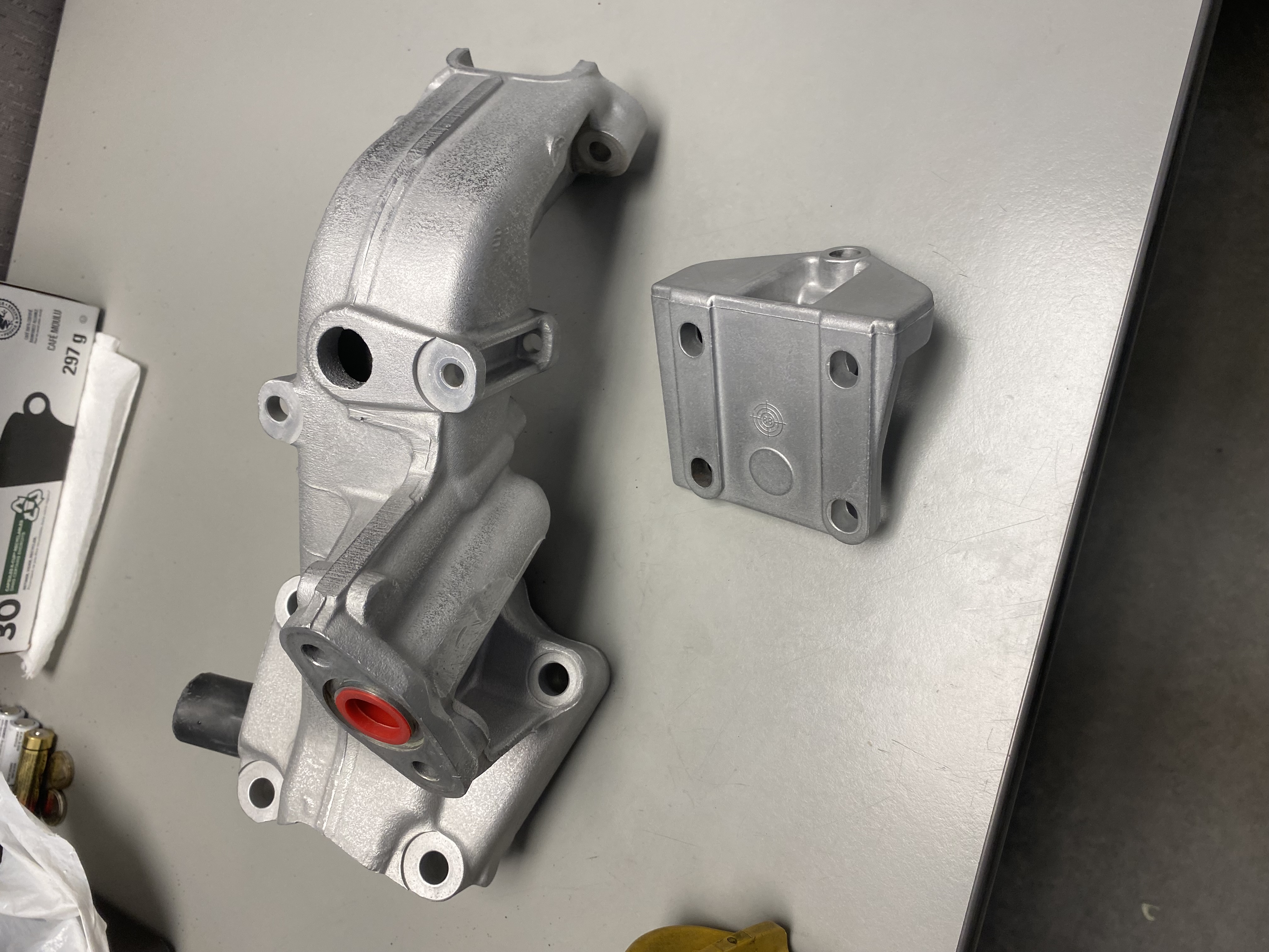

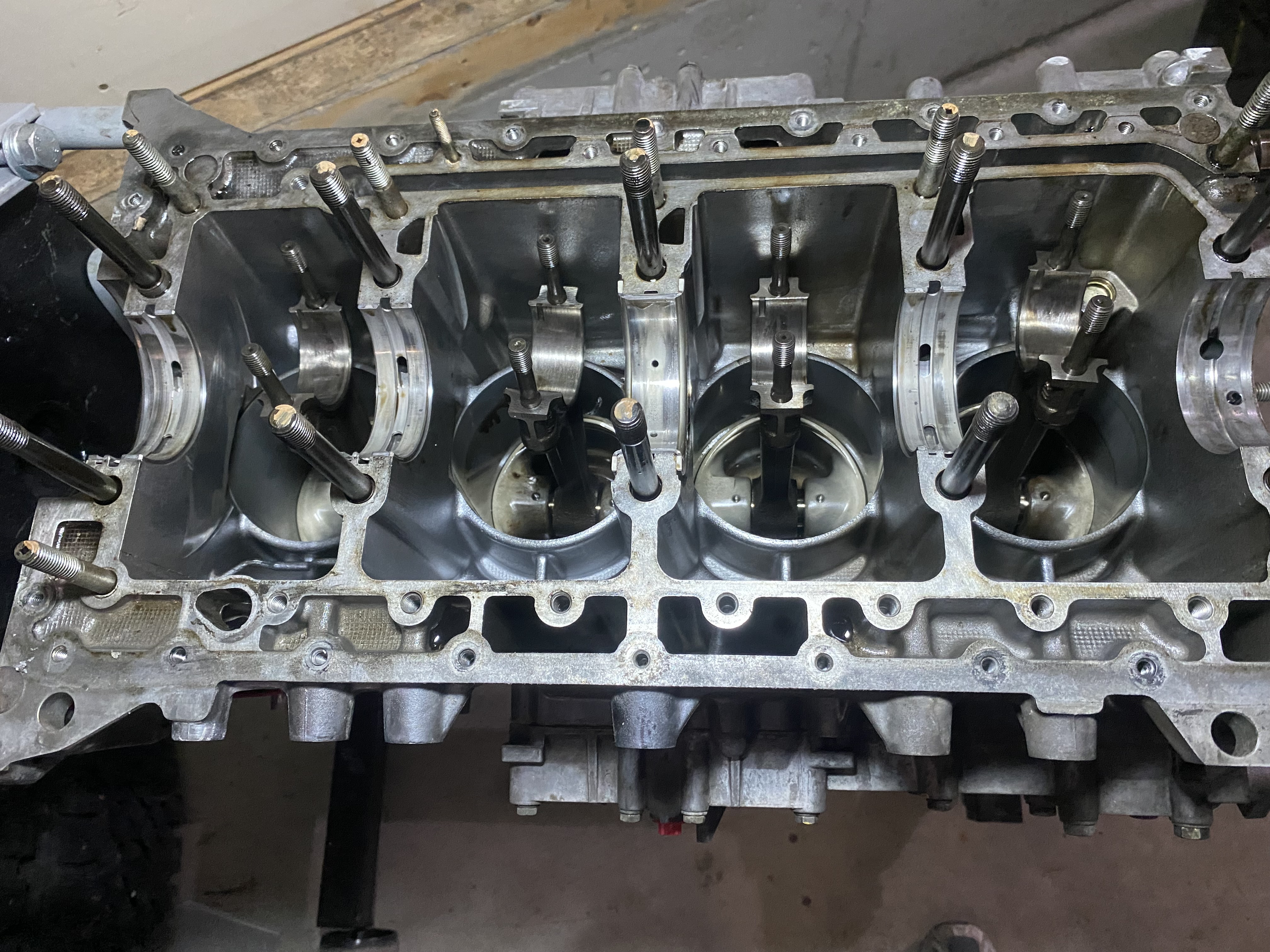

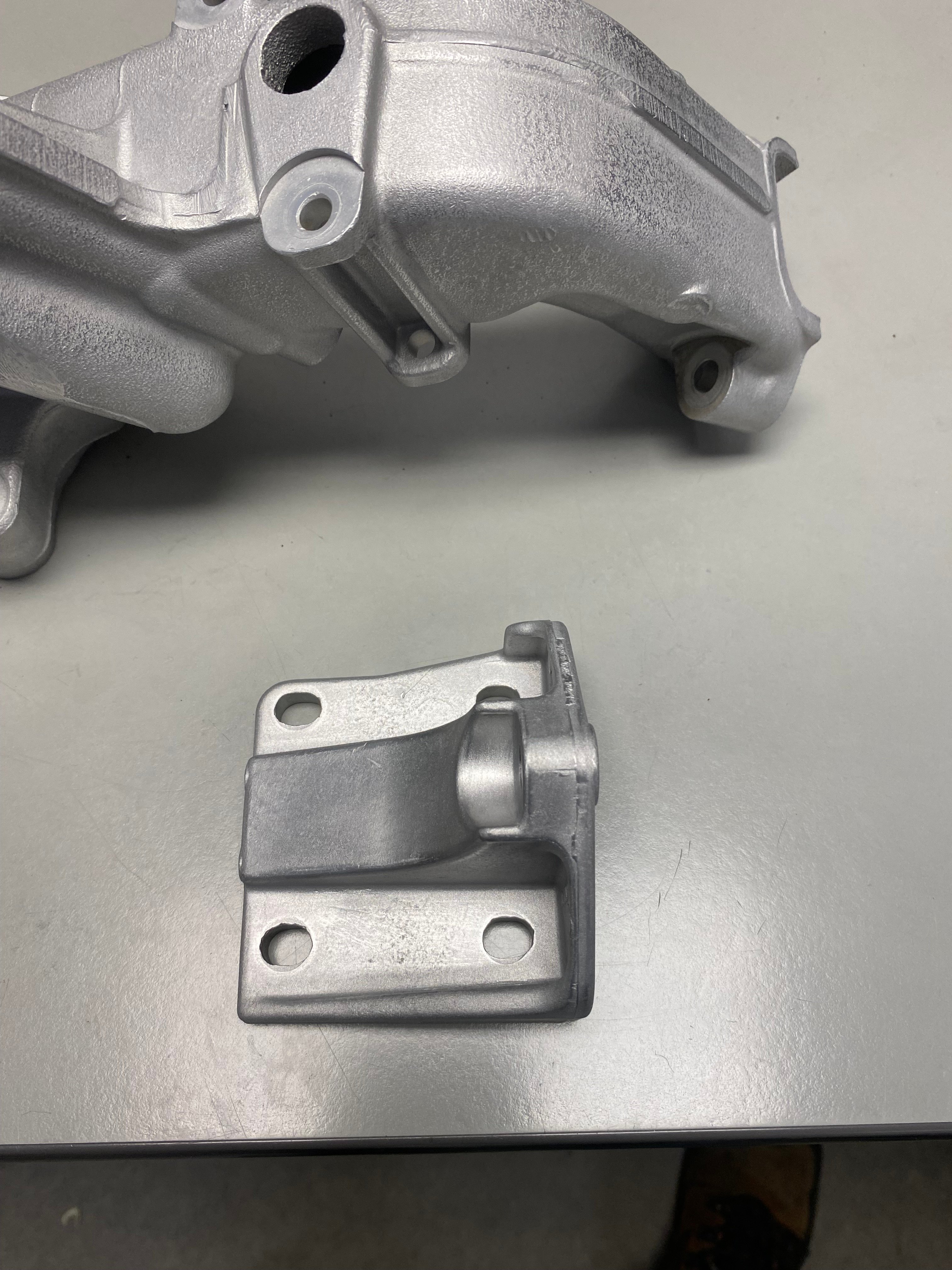

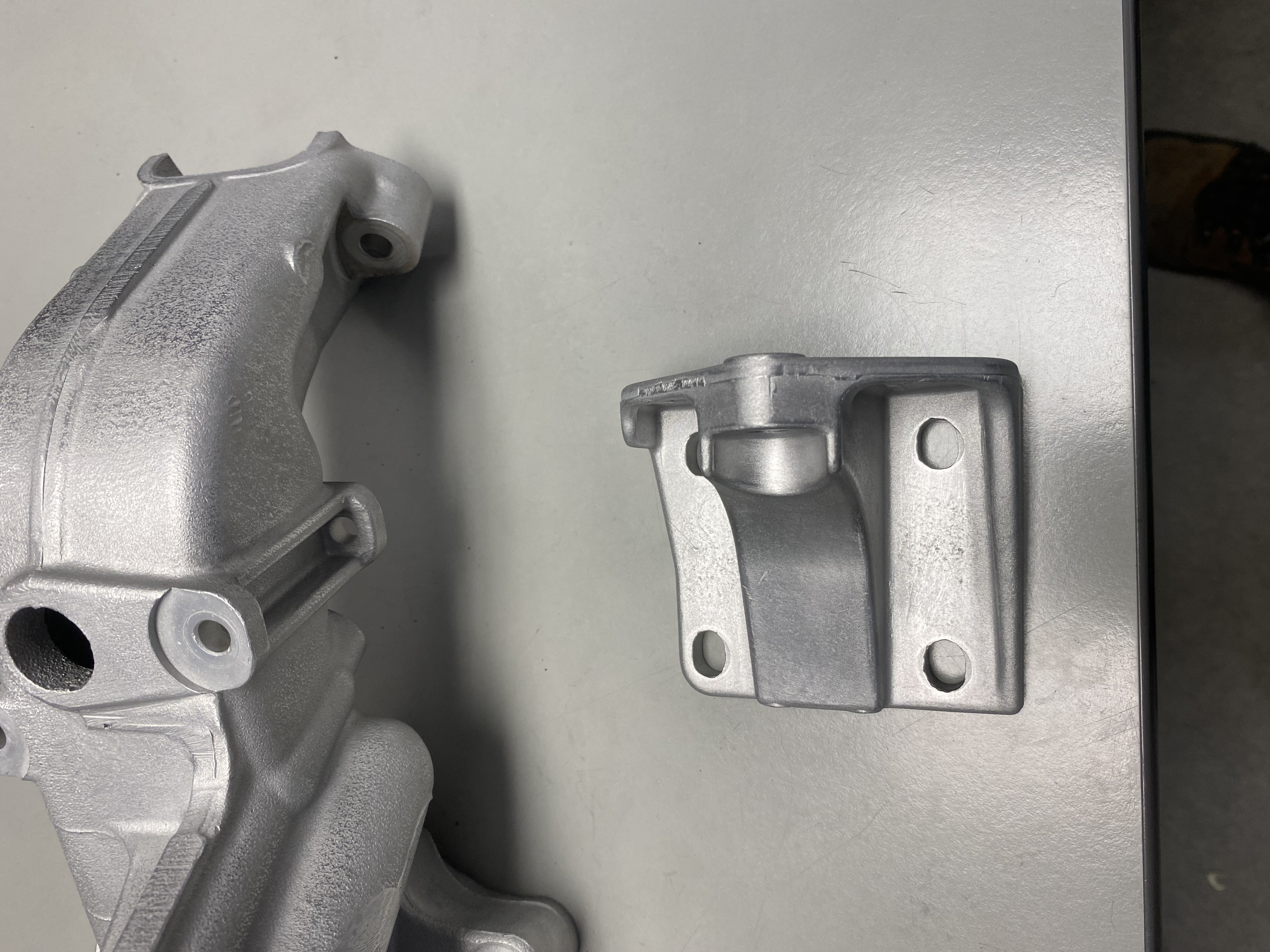

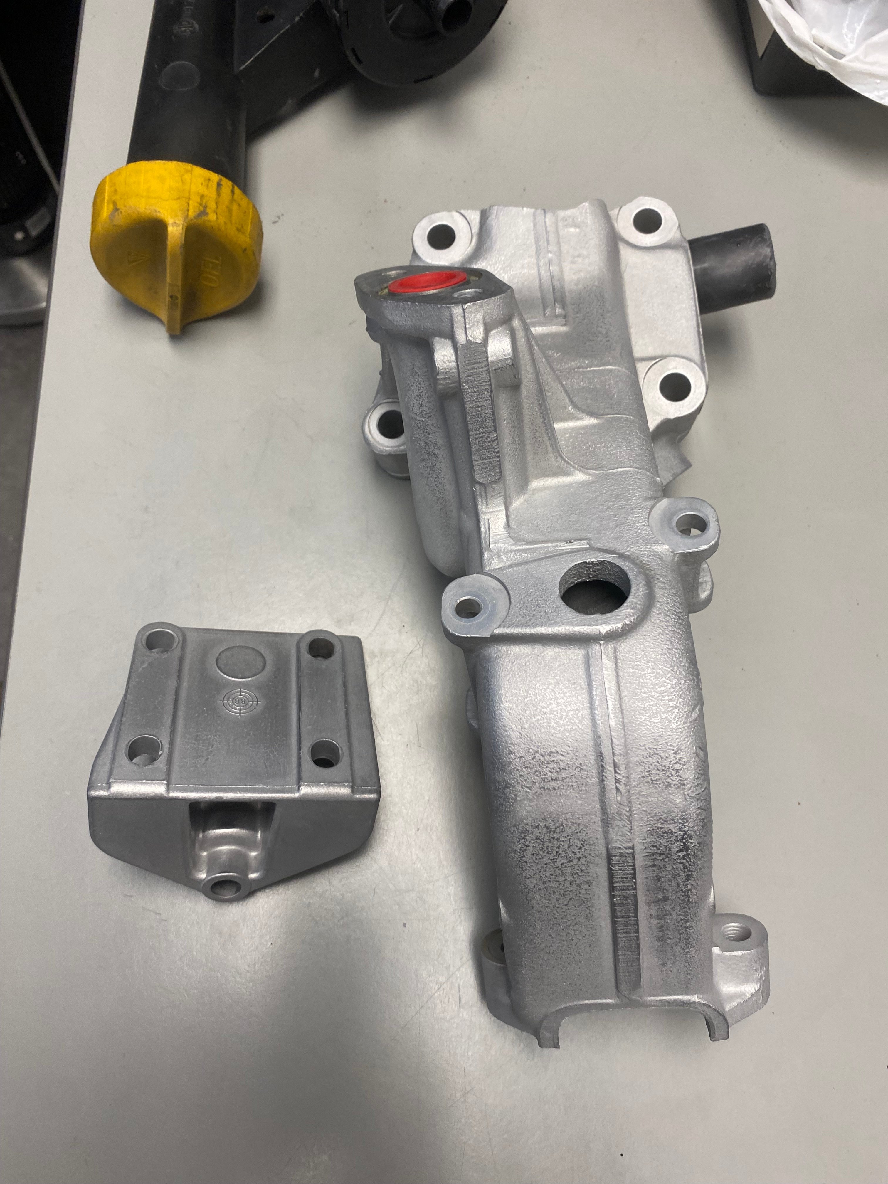

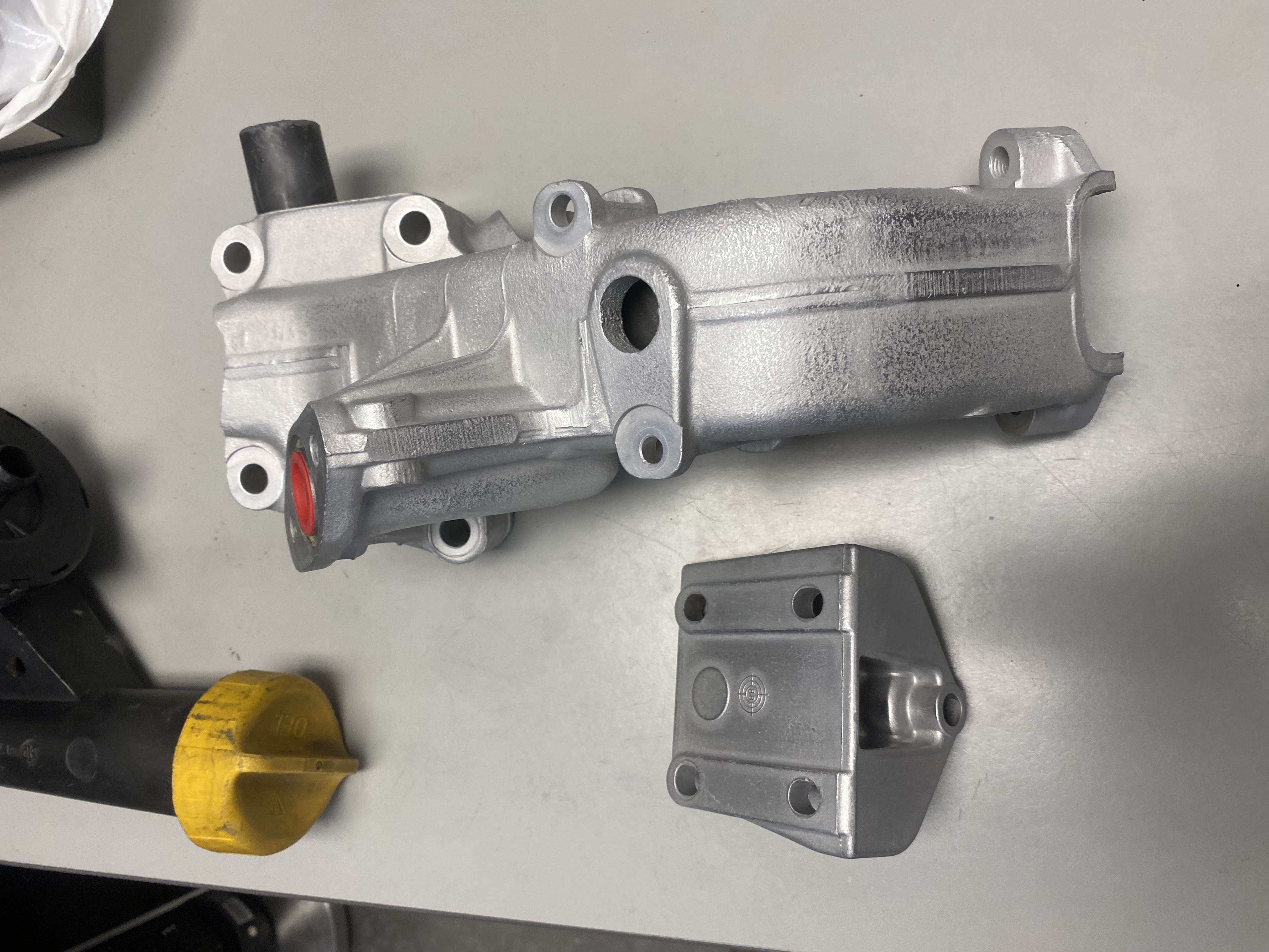

Little bit cleaner and nicer looking.
#102
Posts: 8988
Has thanked: 947 times
Been thanked: 4040 times
Wow, looks great. What process did you use to get such a silvery finish?
#103
gruhsy
Posts: 517
Has thanked: 48 times
Been thanked: 81 times
Tom wrote: Wed May 03, 2023 1:49 pm Wow, looks great. What process did you use to get such a silvery finish?
Bead blasted then light hand sand with 320.
Will hit it with 600 later

Try a drill mounted wire brush - it makes for a nice shine and it also smooths the surface so it doesn't trap dirt as well as the stock finish. Also very easy to touch up later!

chris white wrote: Thu May 04, 2023 5:30 am Try a drill mounted wire brush - it makes for a nice shine and it also smooths the surface so it doesn't trap dirt as well as the stock finish. Also very easy to touch up later!
I will potentially do that. I used a brass brush on my balance shaft covers and it gives it a slight gold color.
I would love to find an oil shedding clear coating as well.

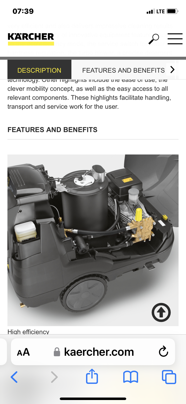

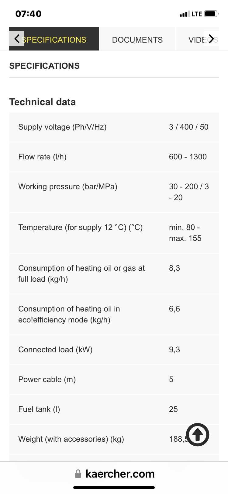

After cleaning 7 blocks so far I want to come up with something that makes the job easier.
I want to buy a steam pressure washer so badly. Quite a few models to choose from and I like the 155C / 311F range ones the best.
They also have separate soap pump not the crappy siphon type. These models are still made in Germany I believe.
https://www.kaercher.com/int/profession ... 19270.html
I used one of my first turbo in 1994 to clean the engine and it was phenomenal. Nothing works better.

I usually have the block / head soda blasted as part of a build. that does a great job cleaning but leaves a surface that really traps oil/grease/dirt.
Try a steel wheel brush - I really like the finish it leaves on the alusil block - kind of shiny and smooth and seems to shed oil easily.
I also pressure wash the blocks / heads after any machining. Not much fun in winter!

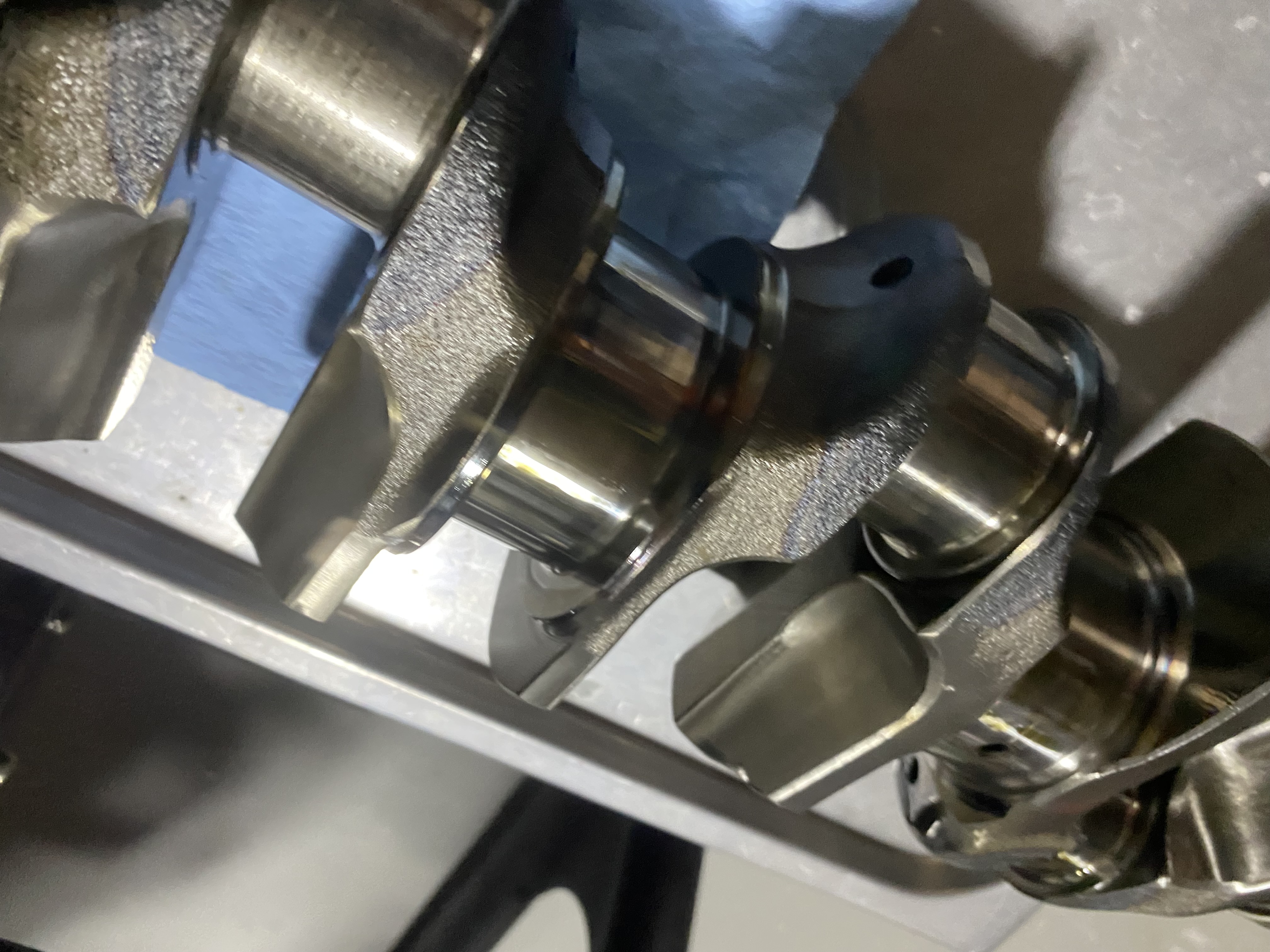

And more bad work
No Loctite on the crank girdle.

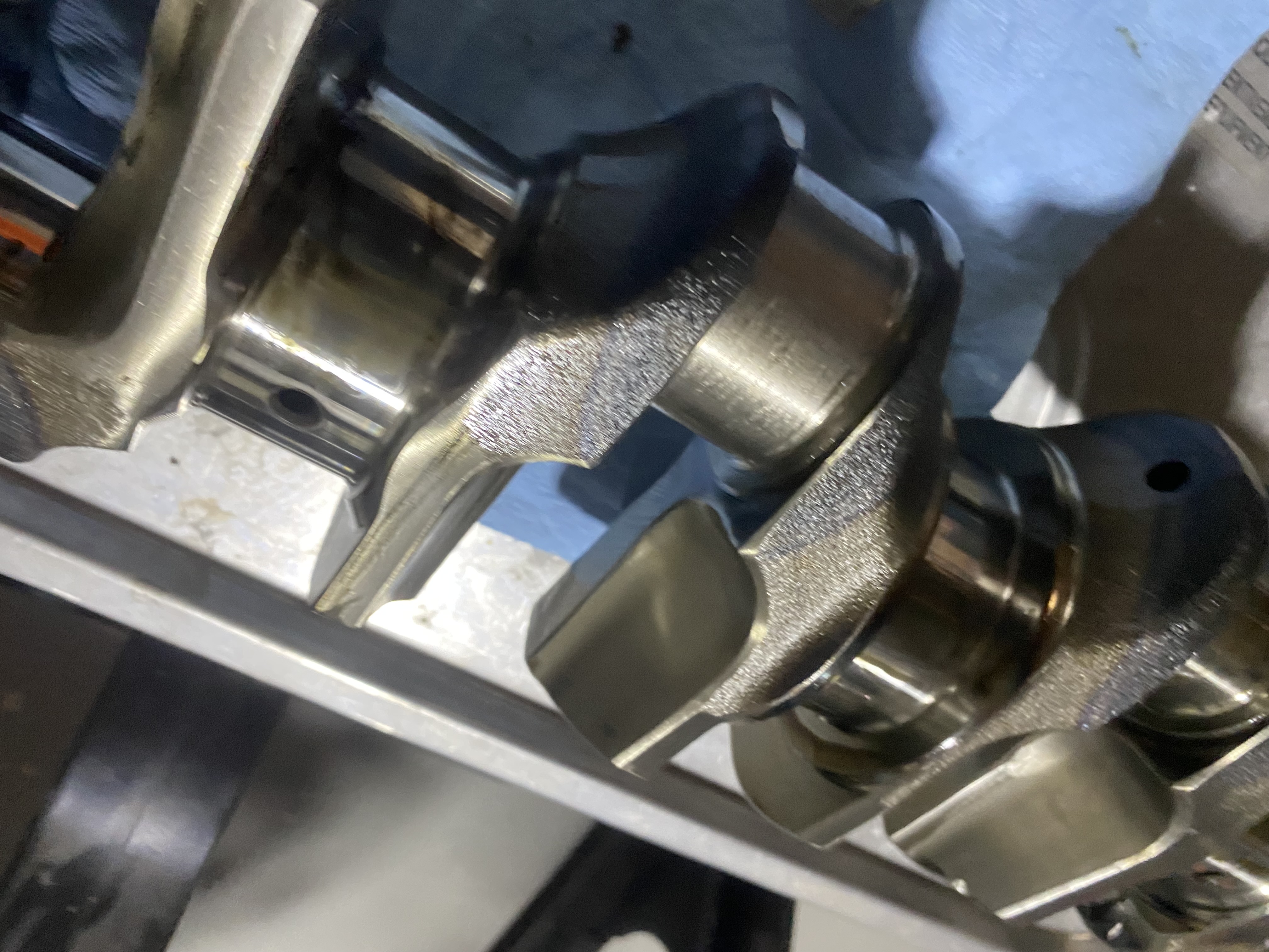

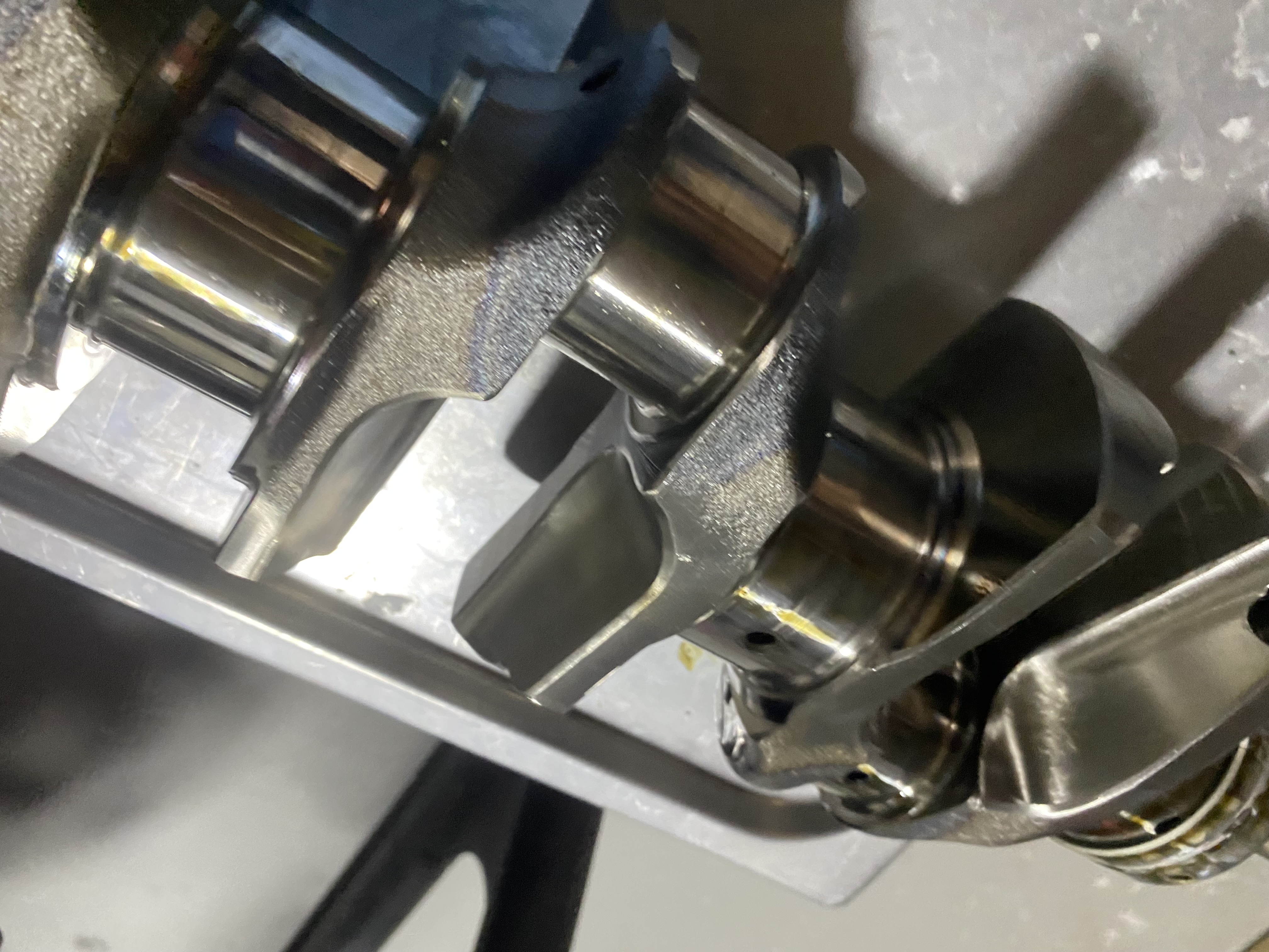

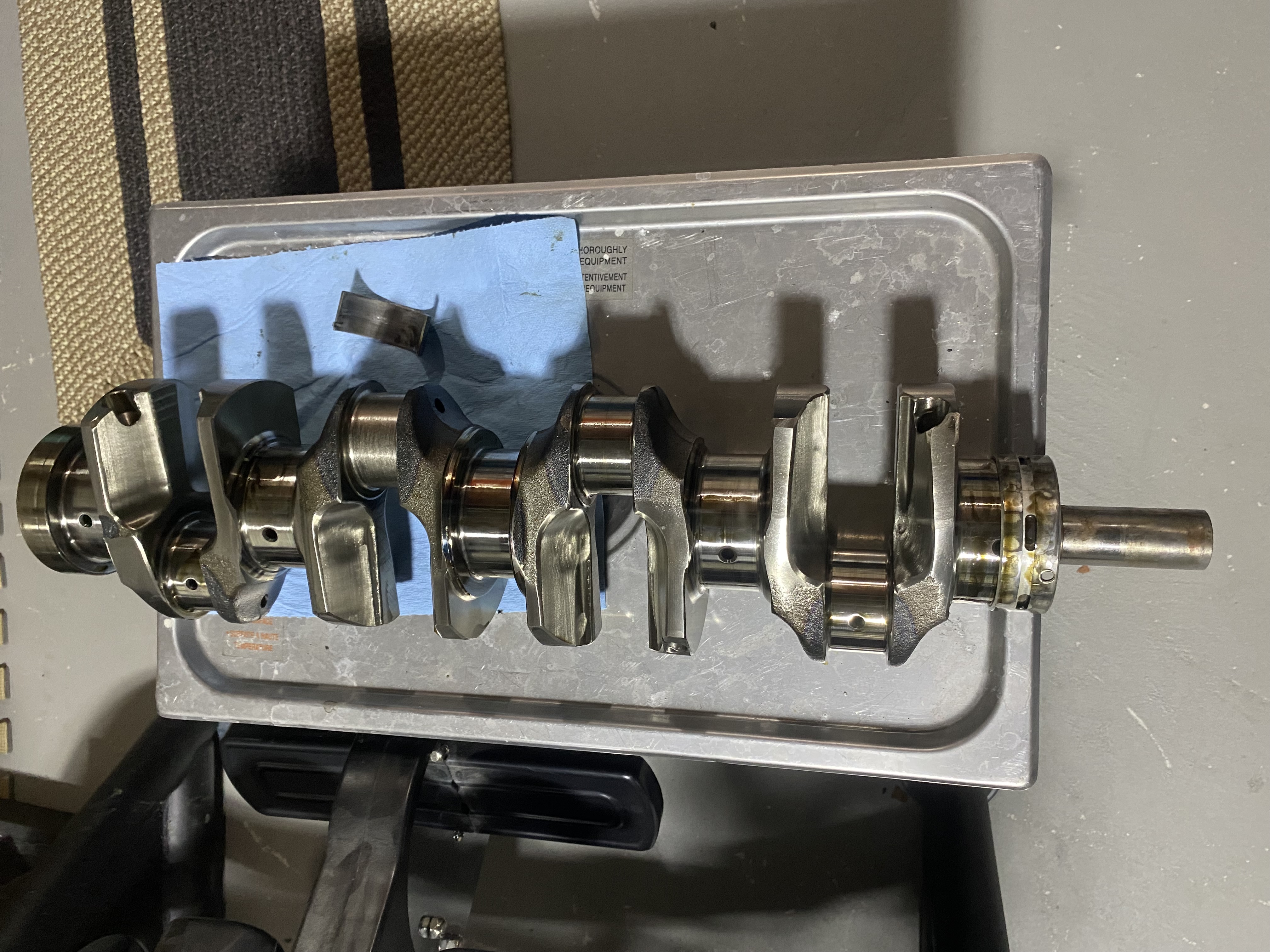

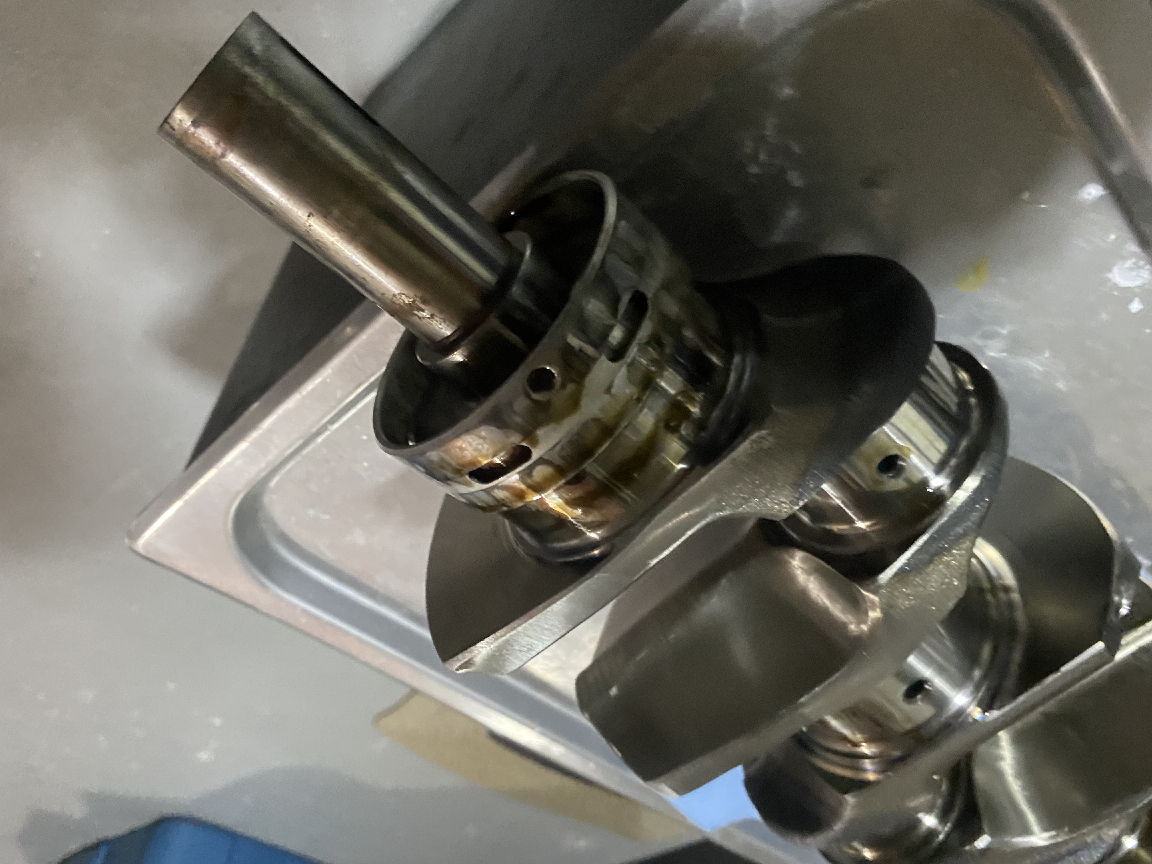

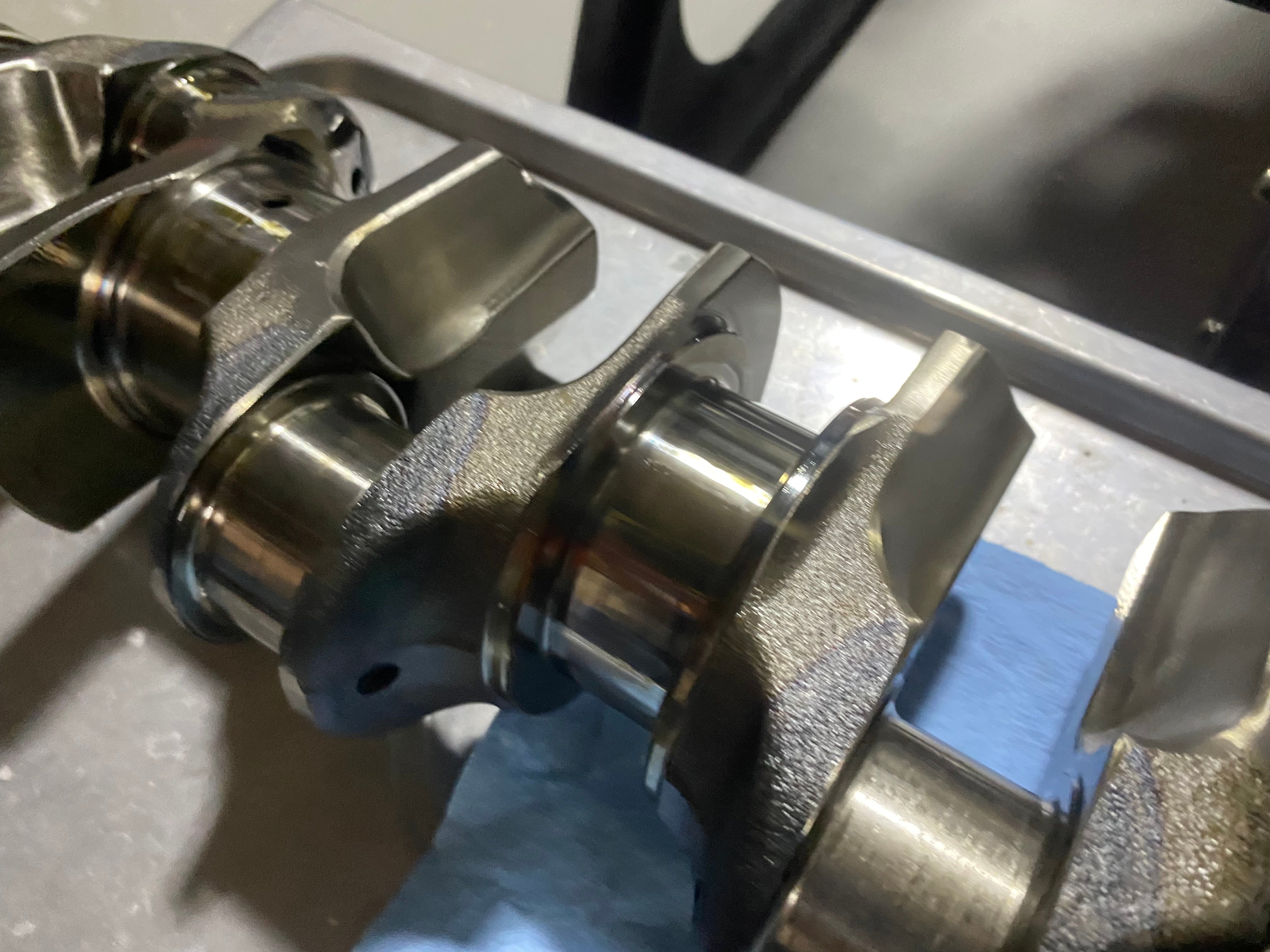

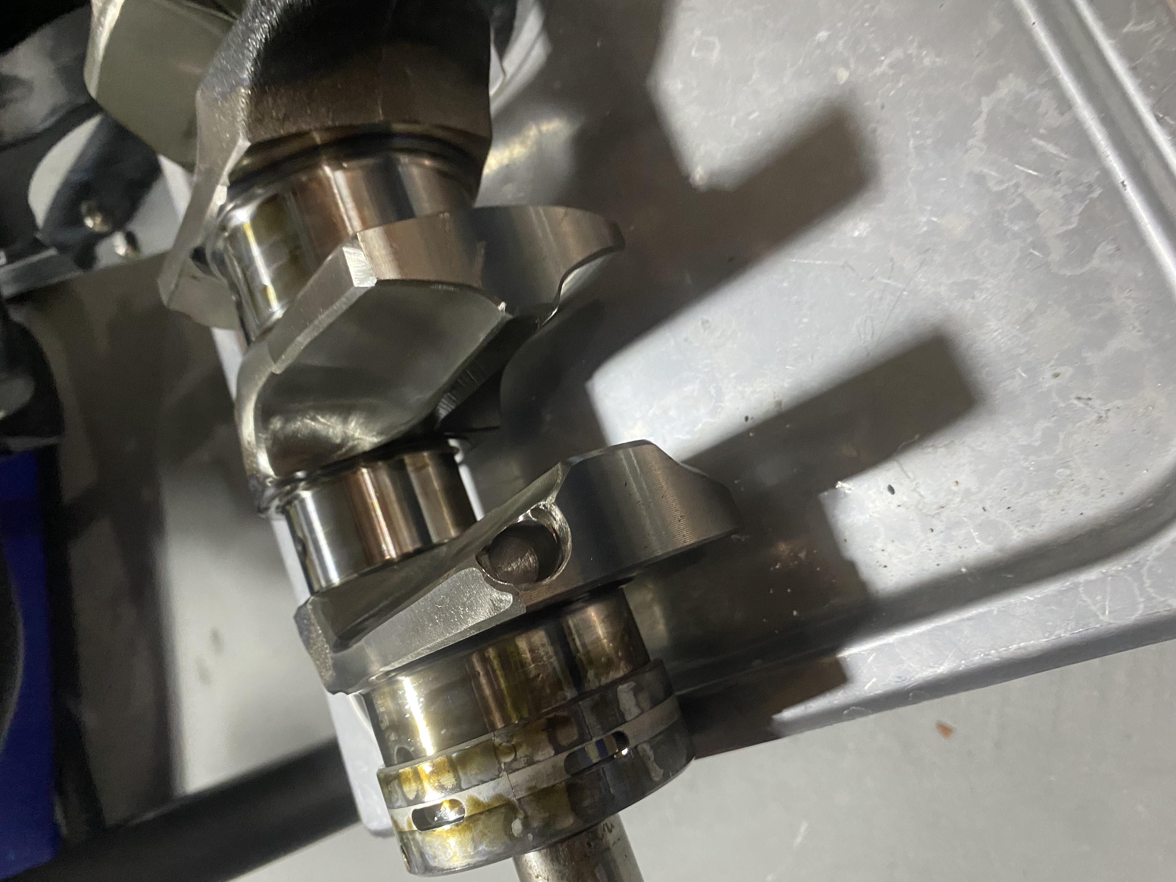

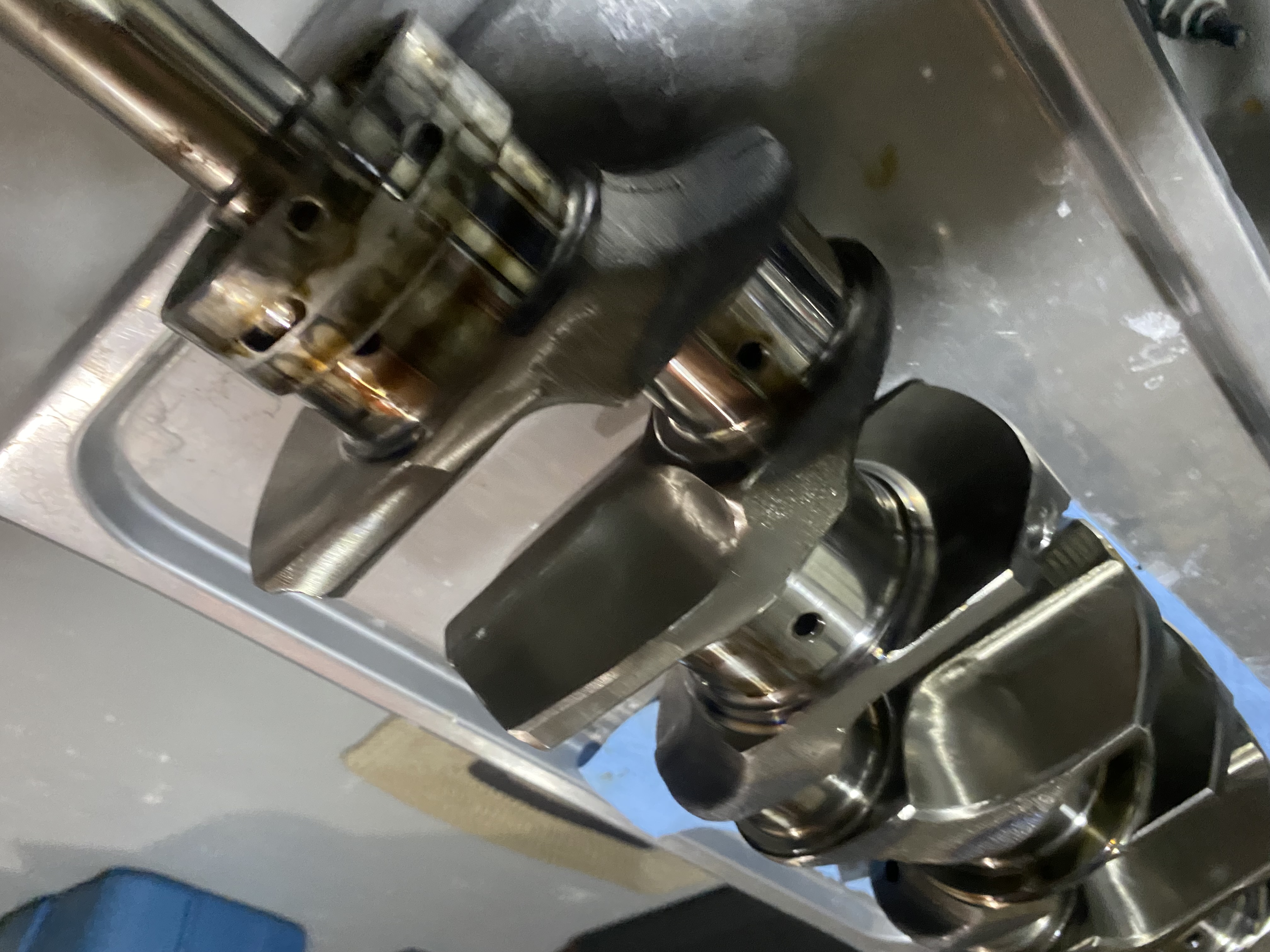

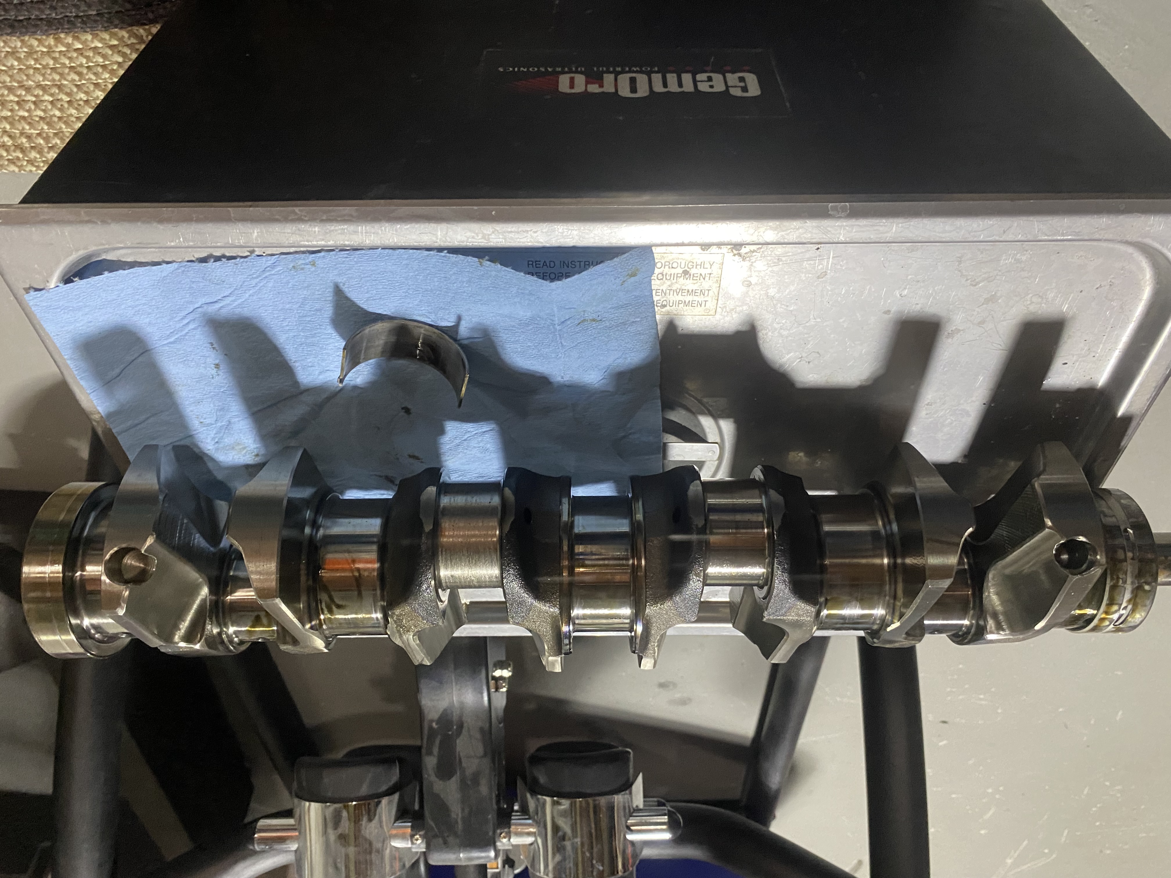

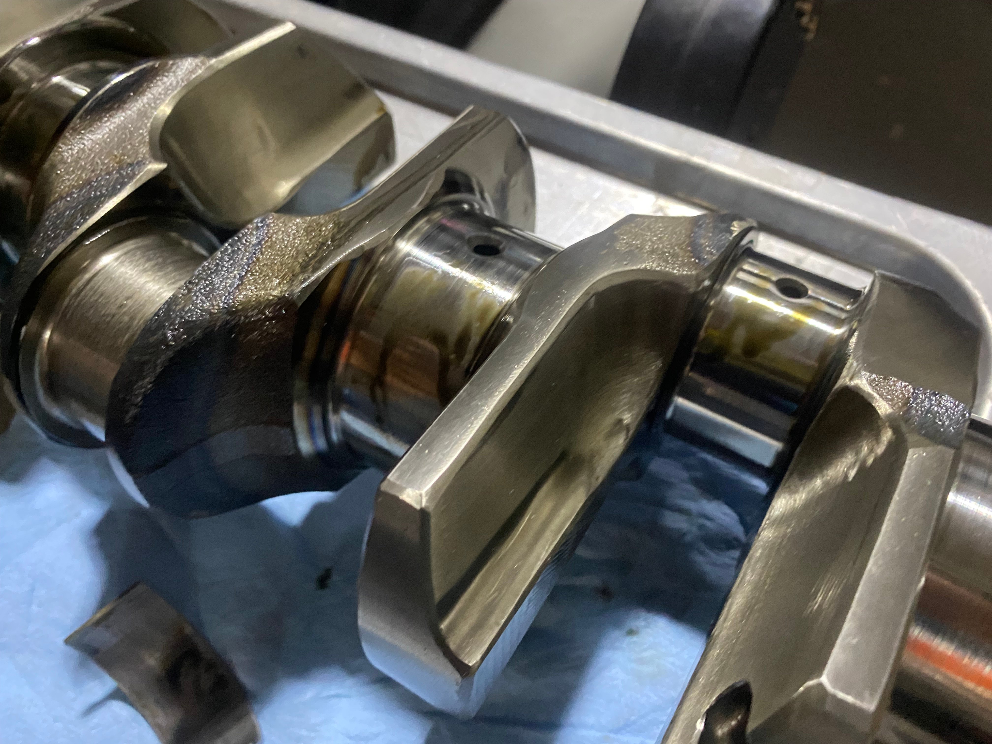

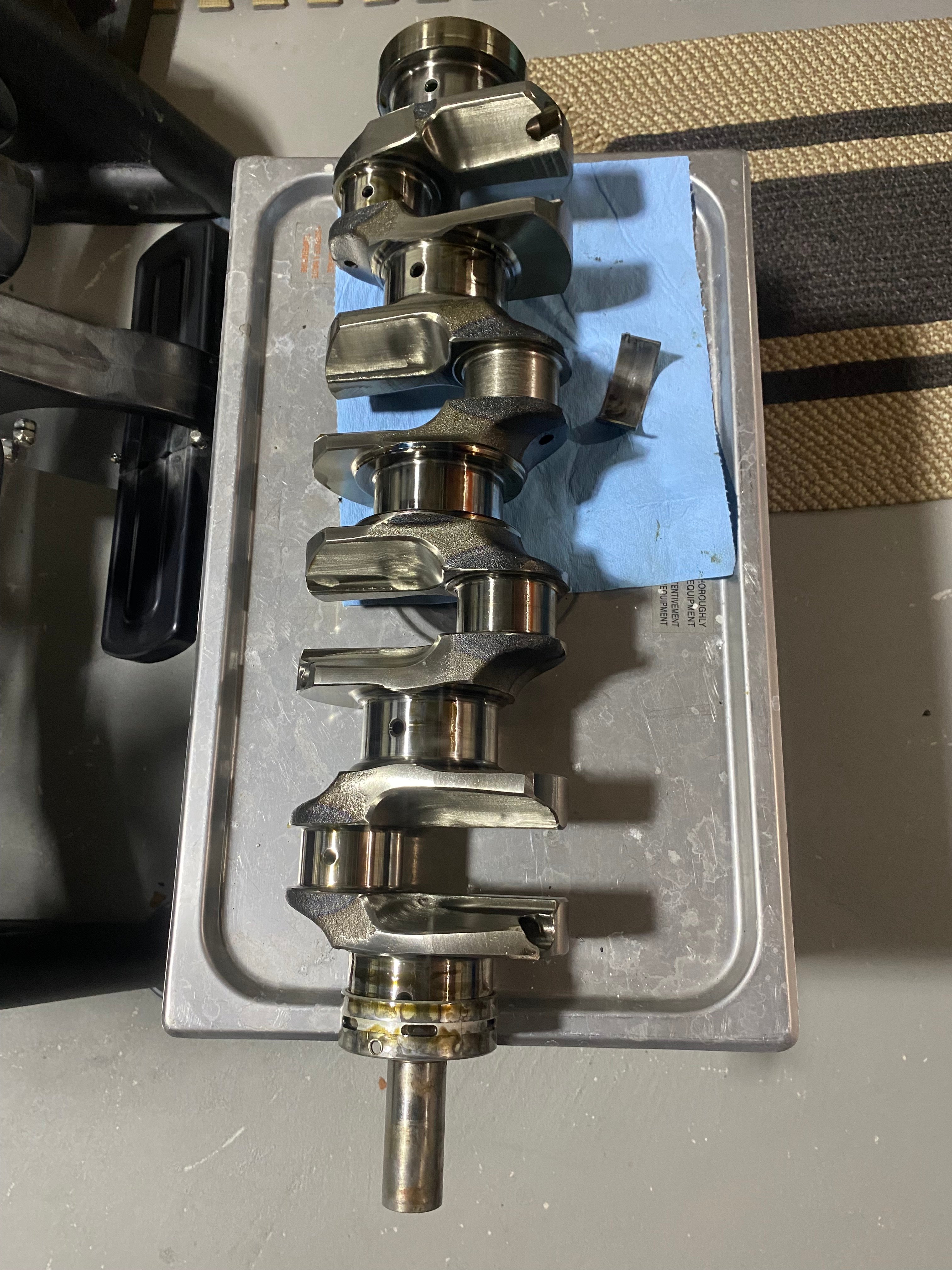

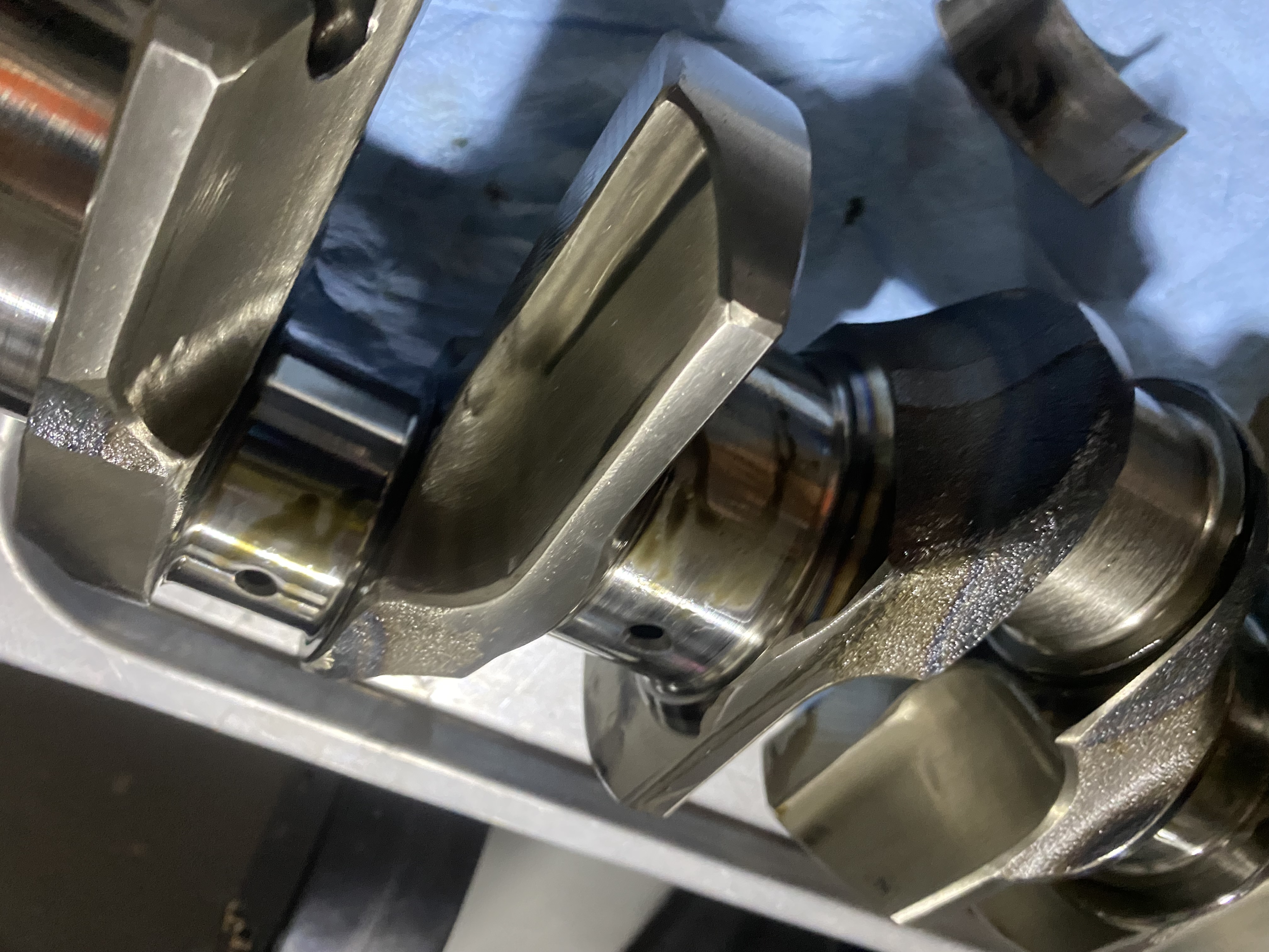

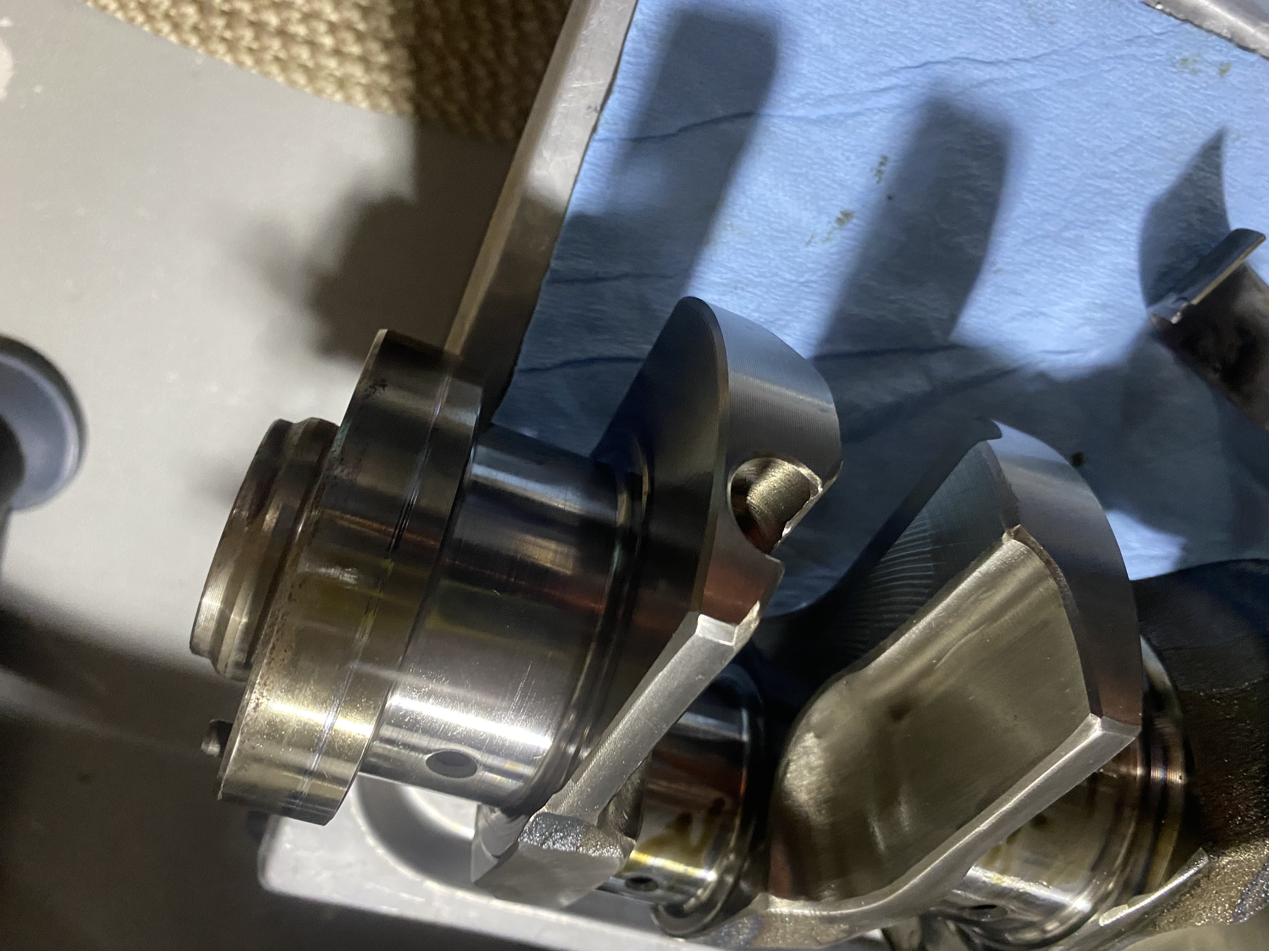

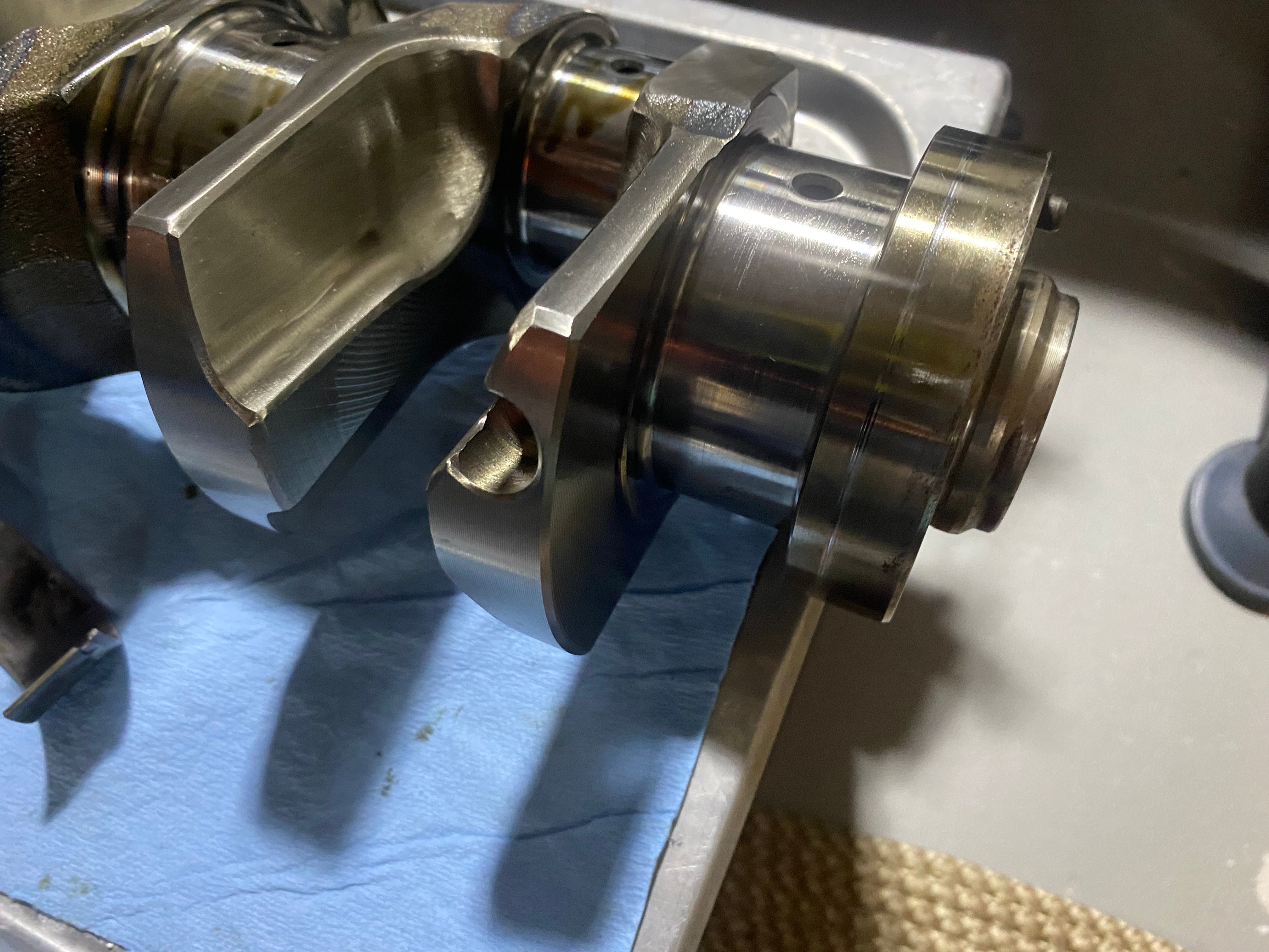

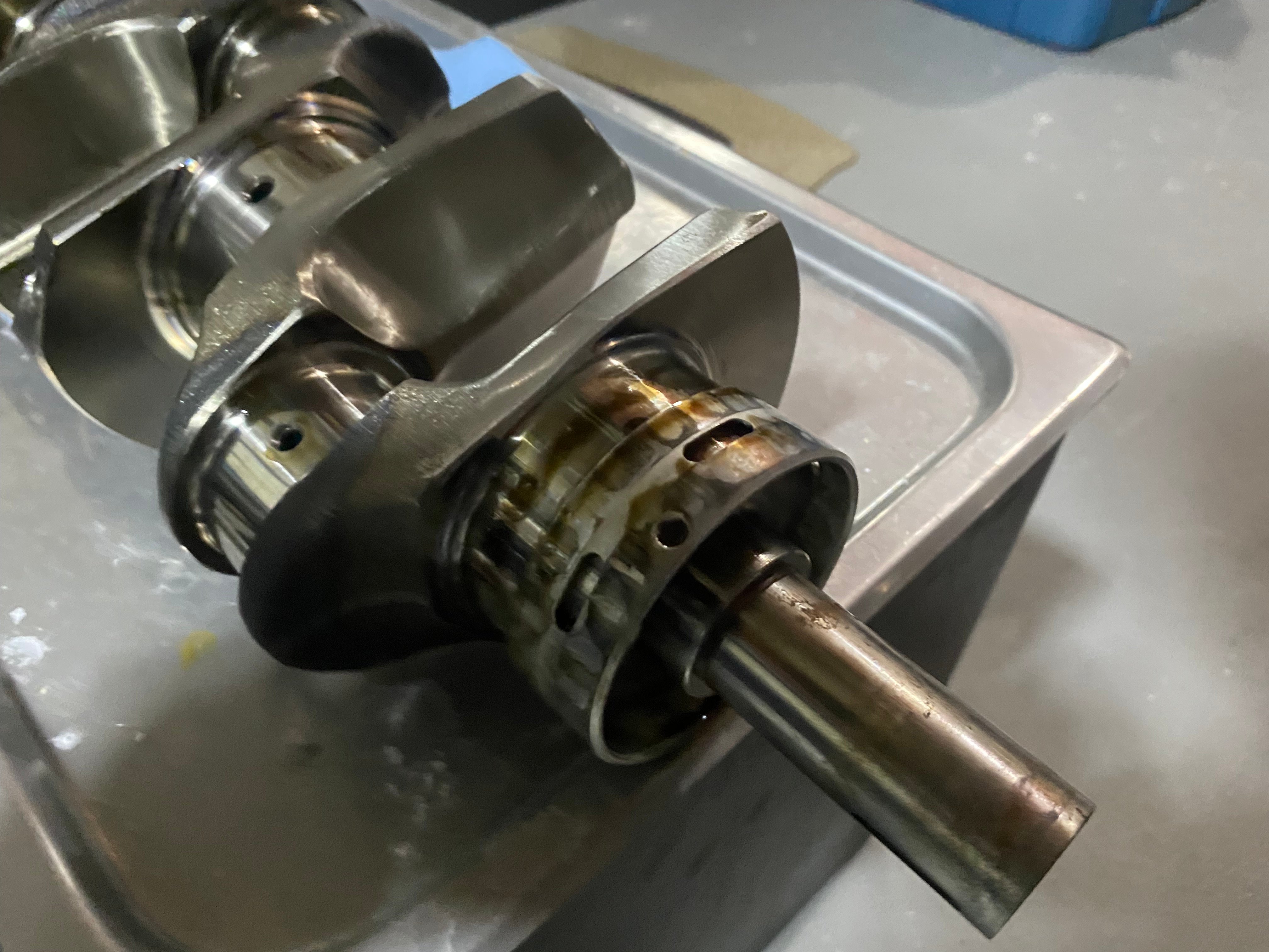

Anyone familiar with this crankshaft work approach?
#109
Posts: 8988
Butter-knife-edge crank?
